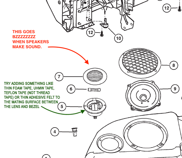

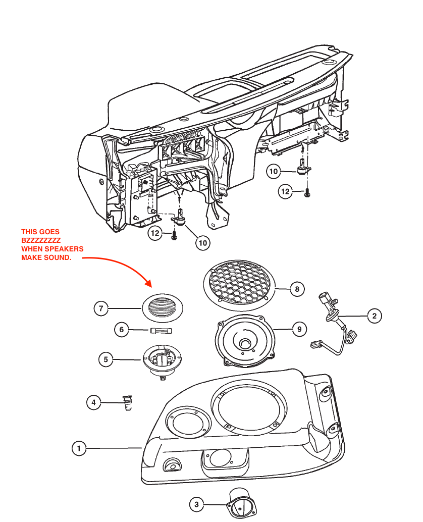

2003 Jeep TJ, 4.0L, stock soundbar, Rockford Fosgate speaker.
I have the earlier single dome light on the 2000. Vibrated like a porn stars favorite Hitachi.
It was actually the clear lens over the light that was vibrating
I removed the speakers and filled the sound bar with poly foam as Mac suggests. Stopped the chatter from the vibrating lens with the added benefit of improving the base response.
polyfill to the sound bar cavity and see if that helps.
Mileage may vary there as mine have polyfill and still buzz, though you will likely hear a sound improvement with the fill, regardless of buzz. I even put a small bit of fill in the front pods when I updated the sound system. If you are putting in polyfill, you don't need to pack it in the enclosures, that can have a negative effect on the sound.
IF the buzz is coming from the contact surface between lens and light housing, that is where you need to address it.
If you gently touch the lens and the buzz shuts up, pop the lens off and put small pieces of electrical tape on the housing where the tangs are. Pop the lens back in and it should stop buzzing.
