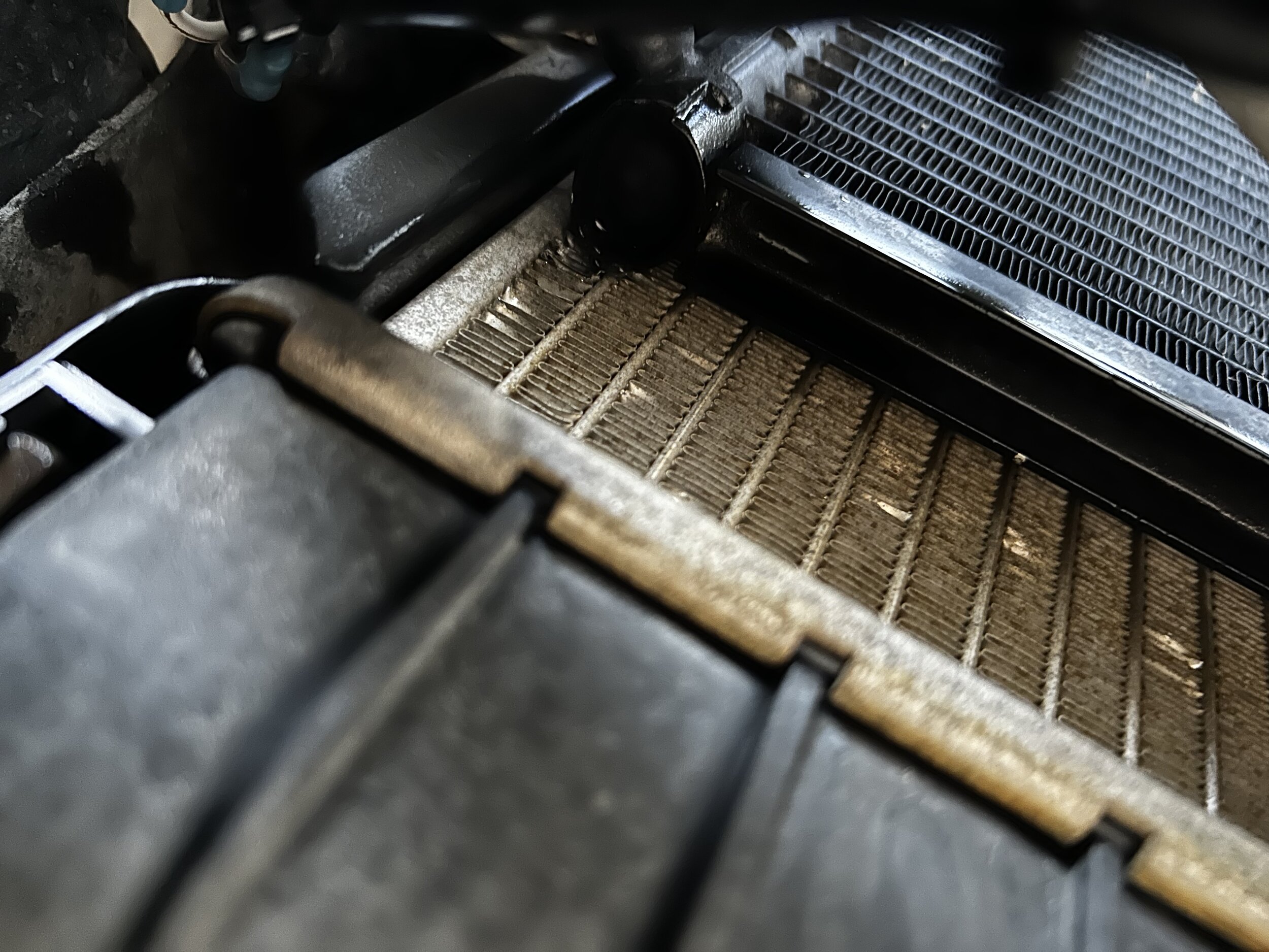

Though I smell coolant on the way home from work. Sure nuff, got home and she’s draining.☹️
Looks like the condenser rubbed a hole. Anyone know of a genuine mopar nowadays?

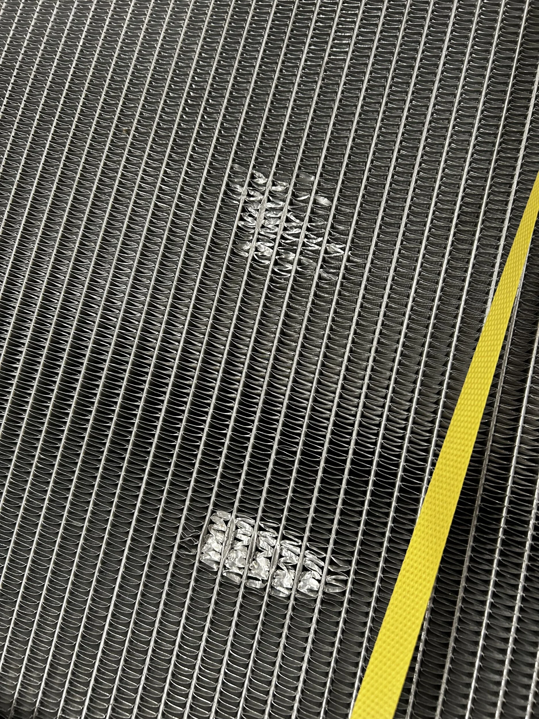

Ordered a denso after the good reviews and a savings of $300 over the mopar. Have always had good luck with denso just didn’t know they sold radiators till you guys mentioned them.
Delivered today but I guess I’ll have to see if rockauto will let me try again. Never have had to return anything from them till now.

Yeah I’ve always been a little worried myself about customer service after delivery but like I said till now I’ve never had an issue. On their website they even say they’re an online only company with no number to call for help which is a little iffy. So far though thankfully it looks like I’ll get a cost free on my part exchange. Having trouble getting the return label though so I’ll have to try tomorrow on my work computer.
