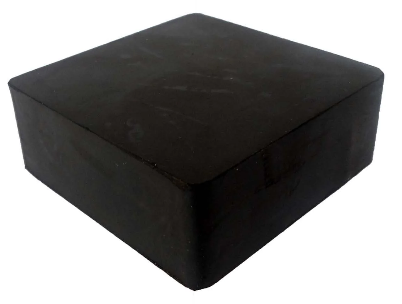

If trimming the bottom snubber won't work, there's always something like this that could be drilled to work...$6 on Amazon...
https://www.amazon.com/dp/B003KJ3T8I/?tag=wranglerorg-20
Or these:
https://www.grainger.com/product/18...ice^c-plaid^82128346557-sku^18AH59-adType^PLA
