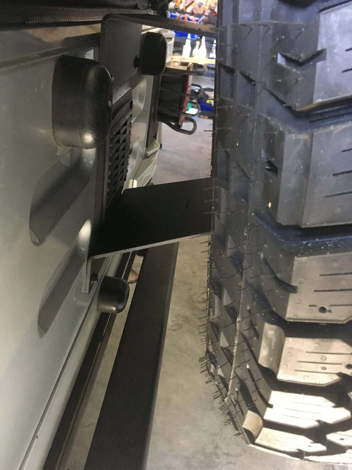

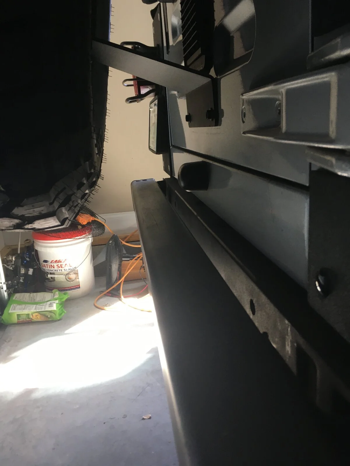

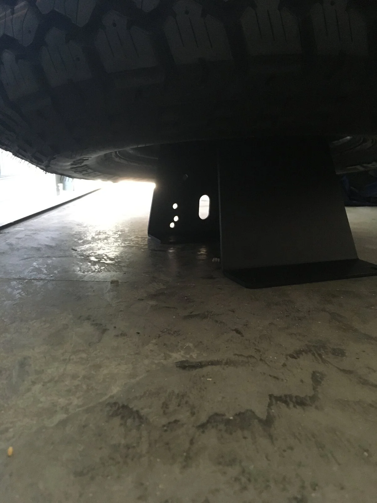

It appears that solution will not work
so I tried flipping the wheel around
And then tried again on the ground
unless I’m doing something dumb, it doesn’t appear like an aftermarket carrier will work. I’d need wheels with a much larger offset.

It appears that solution will not work View attachment 250336
And then tried again on the ground View attachment 250339
It's all dictated by the backspacing on the wheels and width of the tire. Aftermarket wheels typically have 1-2" different backspacing, which results in what's happening here.
Many folks cut down rubber mallets or pieces of PVC to make spacers to fill that gap. The other solution would be to use a different wheel with different backspacing.
I can't speak to the specific dimensions of that carrier as to how or if it differs from the OEM carrier, but I'd be willing to bet it's not that different. Any wheel and tire combo other than stock will result in a different fit, sometimes off enough to need spacers, like here.
I wonder what the dimensions are of the stock carrier to see I should return this. I just didn't expect to see such a great distance between the tire and the tailgate.
This is what I was concerned about in the inital thread.
The factory mount is 7" between mounting surfaces. What is the distance on that RR mount? If memory serves, the Hyline Offroad mount is 7" between mounting surfaces.
The RR spartan is 10" between mounting surfaces. So It beeing deeper + my low backspace is probably exacerbating this issue quite a bit.
So I can with have some giant snubbers or purchase a OEM mount.
Thanks.
