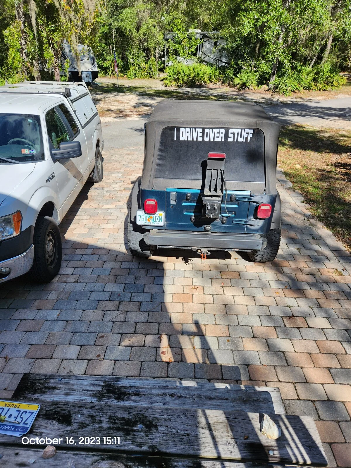

I currently have the spare tire carrier seen below, I had to remove the tire as it cracked my tailgate, what's best way to reinforce tailgate (I have a friend who is a welder and can repair it) so I can put tire back on

If you repair it, then you shouldn't need to reinforce it.
Make sure the tire snubbers are up against the tire to reduce vibration.
However, if you're carrying an oversize tire, then look into the Morryde tailgate system.
I was wondering what size tire you hang on it. Mine has had a 32x11.50 hanging on the factory tire carrier for 24 years with no issues, and that has been a lot of Arizona rocky desert trails and no mall crawling. As noted above, mine is snugged up against the bumpers so it doesn’t move around.
