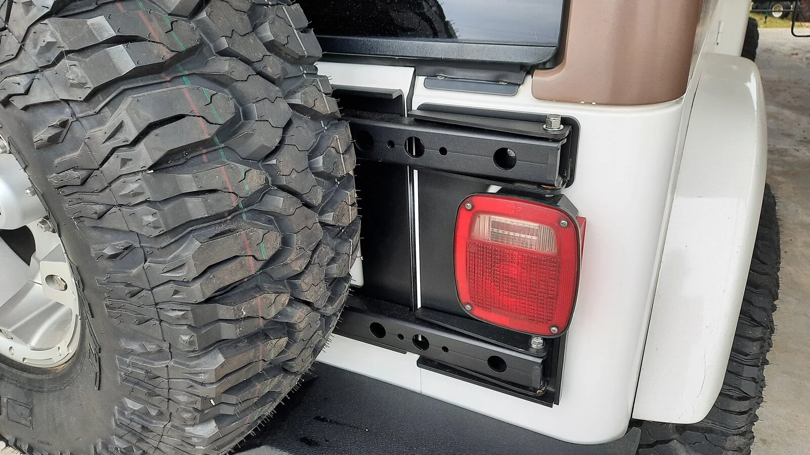

What's everyone's thoughts on spare tire options? Go with MoreRyde/Exogate? New bumper with swing out? Keep stock tire carrier?
I am moving up from 31-33s in the very near future. My current tailgate does sag a little and I have to slam it shut really hard to keep it from rattling.
Just looking for thoughts to decide my next upgrade.
I am fighting the urge to not even carry a spare. The only flat tires I have had on my Jeeps were after I rolled one twice In the 80’s. I think the spare was even flat.
I have the MoreRyde/Exogate with a 33 and really like it. I can't think of a negative. If 31 just need the stock one, if 33 or larger I vote the above.

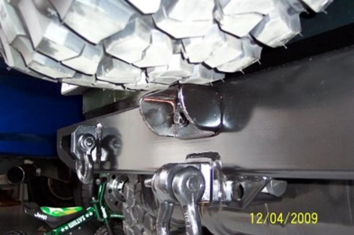

I made a small bracket that kept the weight off the stock tailgate hinges. Worked for 7 years with a 35" spare until the Jeep was sold. $25. I've also just bolted a 1/2" steel plate to the bumper.

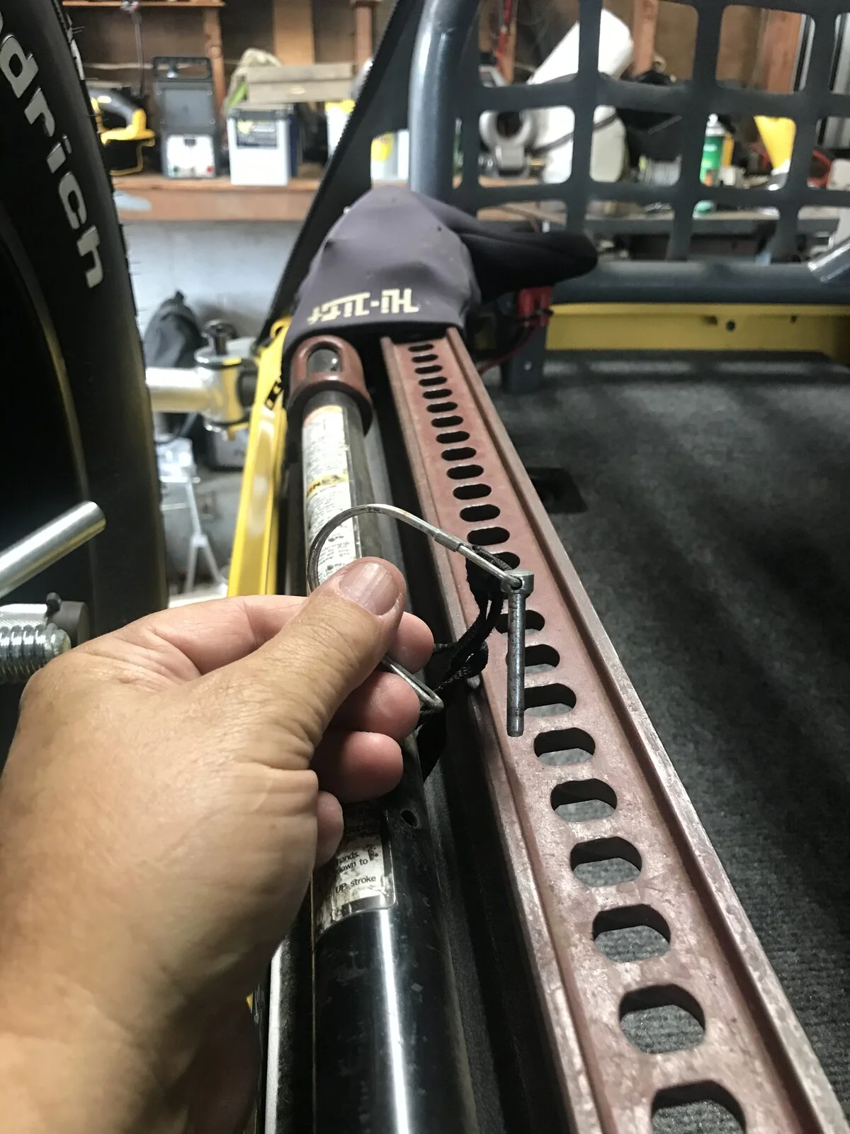

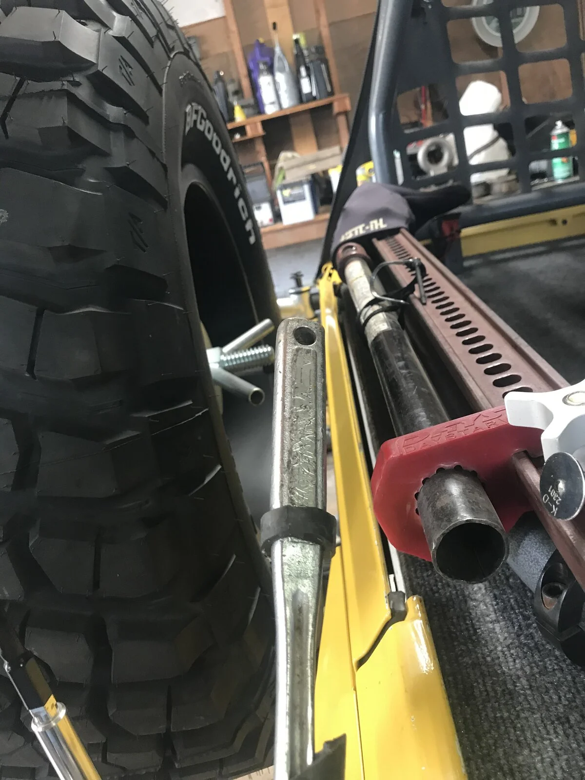

This is how I have mine mounted, it keeps it out of the weather when the h-top is on and securely mounted with some DIY mounts. I store the base with my recovery gear and the breaker bar, extension, wheel lock key, and socket store in the handle with a keeper pin through the handle and breaker bar.

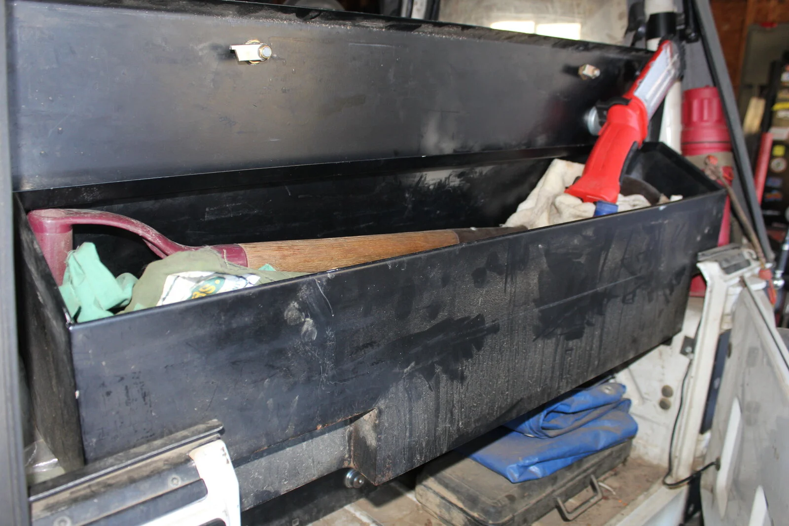

For me it's all in packaging around the storage boxes I have.
I've got this storage box which blocks that area so I would have to mount the hi-lift higher above it. I've also thought about drilling the back side of the box and mounting it there. Since I don't have a rear seat anymore it might just happen.

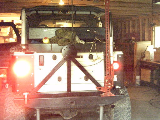

Although I seldom carry a Hi Lift any more, this is where one mounts on a Rock Hard 4x4 rear bumper:
When I was carrying the Hi Lift on a semi regular basis, I drilled out the hole in the Hi Lift base plate to use a hitch pin rather than a cotter pin so I can store the base plate inside and out of the way. [Also drilled the handle for a hitch pin as shown.] Since I was using my Max-axe multi tool more often than my Hi Lift I attached it to the jack bar with Quick Fists and wing nuts, easily removed in seconds on the rare occasion that I would actually need the Hi Lift.
As noted above, I seldom carry the Hi Lift any more, and I have moved the Max-Axe multi tool to my Sprinter. I carry a D-handle shovel, "Silky Katana Boy" folding saw, and small hatchet in the jeep instead.

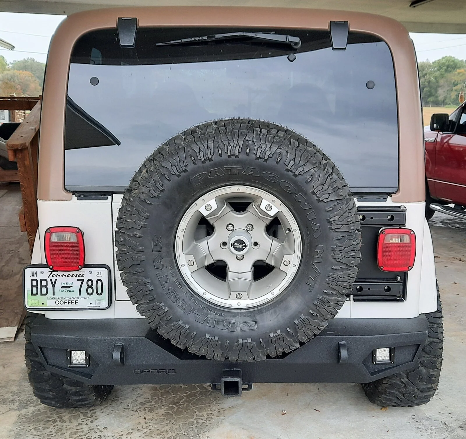

I have the Exogate with a 37" which doesn't appear to be working out so well. I'd like to put the spare in the cab, but need to keep the back seat.
Used to have the Rock Hard rear bumper and carrier and hated it.
I've thought of carrying a 35" spare to decrease the weight and clearance back there. I've only used the spare once, but I've had two tires go flat before (trail hazard).
