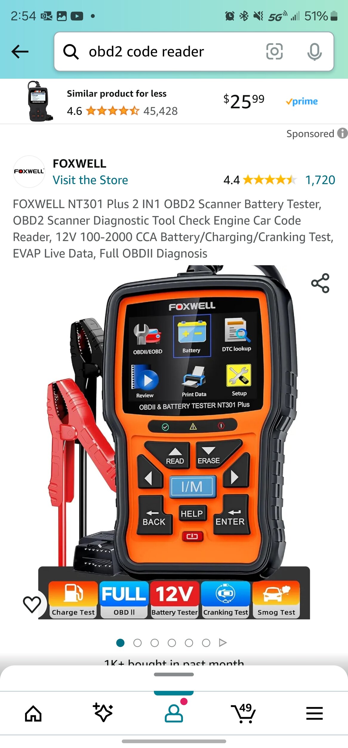

Ya I don't have the reader you're talking about. I looked up what I think you're talking about on Amazon for like 70 bucks. You think that will tell me the info you talking about?
