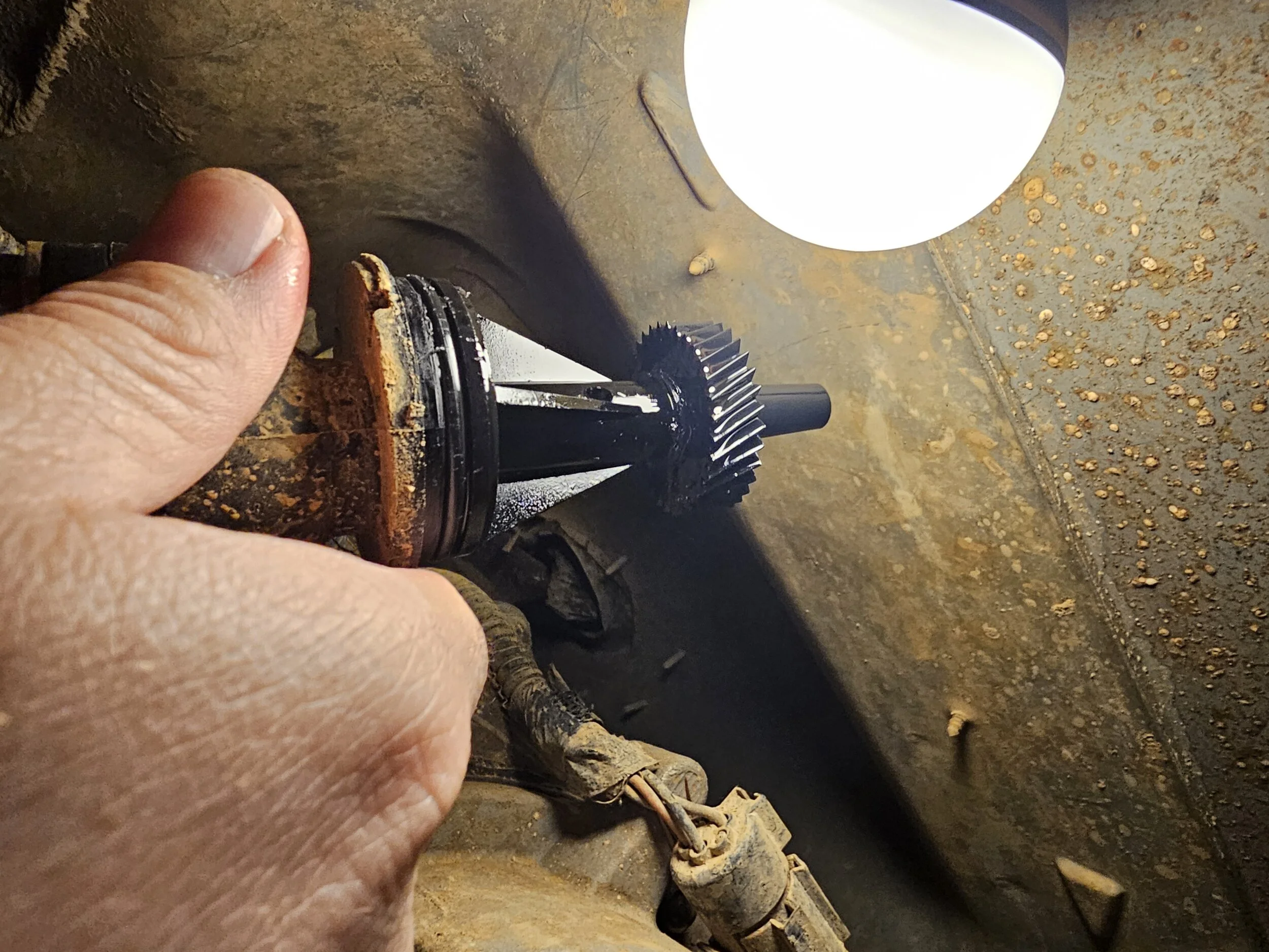

Teeth look great on the speedo gear. It is simi-new. I changed it out about 5 years ago to match my 33s. Back to the drawing board. I have no idea what is causing it.
Is it clocked correctly? You can rotate the assembly 90 degrees at time. Certain positions for amounts of teeth.

I forgot to clock it when I put it back in. Guess I'll do that in the morning. It's been 5 years since I messed with the speedo gear. Thanks for reminding me. E

Well I got lucky, it's clocked correctly. Any other ideas?
What about the gear on the TC output shaft (in the hole), is it ok too?

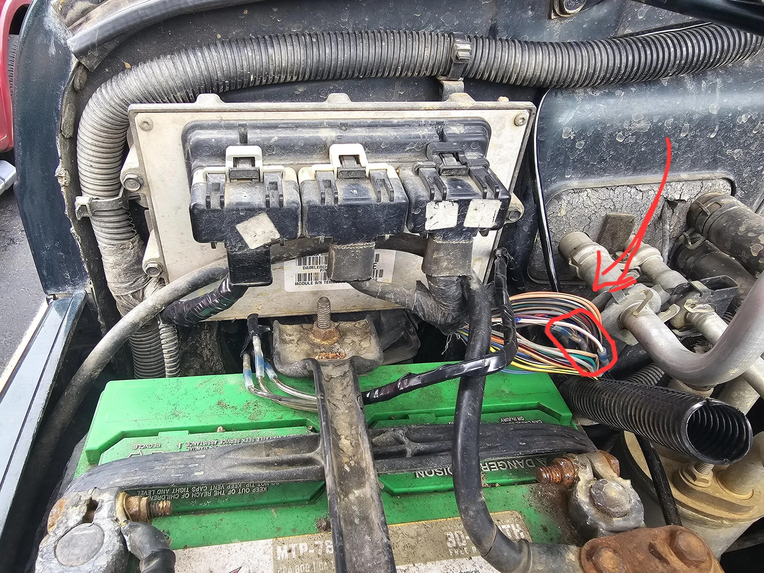

So I've decided to replace the 3 wires from the VSS on the trans to the computer to eliminate any possible grounding issue. I spliced the 3 wires into the "circled area" in the picture on the corresponding wires. This must be the incorrect "spot" to splice because this caused the engine to not start once completed. Does anyone know where I "should" splice into the harness to eliminate the stock vss wires and a possible grounding issue?
I have an erratic speedometer after an offroad trip though heavy vegetation. I found wires pulled from luming under the driver side rear quarte panel. I have checked VSS gear, replaced the VSS and reclocked. Checked a good portion of wiring. Checked the guages and their connections. So all I have left is rewiring the VSS to the ECU or replacing the TC worm gear. I've decided to the the wires first. Since that's more likely after finding wires pulled under the jeep.
So I've replace the 3 wires from the VSS on the trans to the computer to eliminate any possible grounding issue. I spliced the 3 wires into the "circled area" in the picture on the corresponding color coded wires. This must be the incorrect "spot" to splice because this caused the engine to not start once completed. Does anyone know where I "should" splice into the harness to eliminate the stock vss wires and a possible grounding issue?

That's as good a place to splice as any.
The speed sensor wire goes only from the sensor to the PCM. But the 5V and Gnd wires go from the PCM to the speed sensor and to other things (check the wiring diagrams in the 2000 service manual, page 8W-30-11). You might have bypassed something else which now has no power or ground.

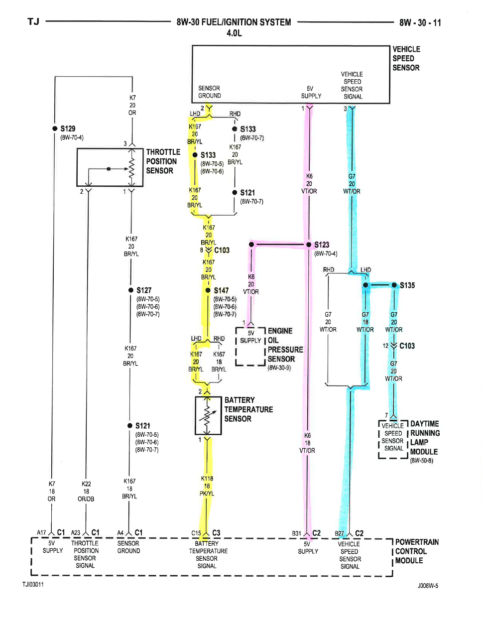

OldBuzzard is spot-on (as usual). The following commentary assumes that you cut all three wires at the point shown by the red arrow in your picture, and then you ran new wires all the way to the VSS connector, which left a lot of stuff disconnected due to the splices in the harness. Here are the relevant manual pages, with the sensor ground wire highlighted yellow, the sensor 5V supply wire highlighted purple, and the sensor signal wire highlighted blue:

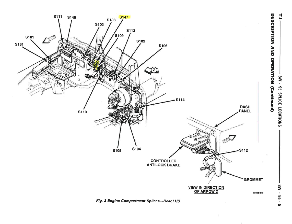

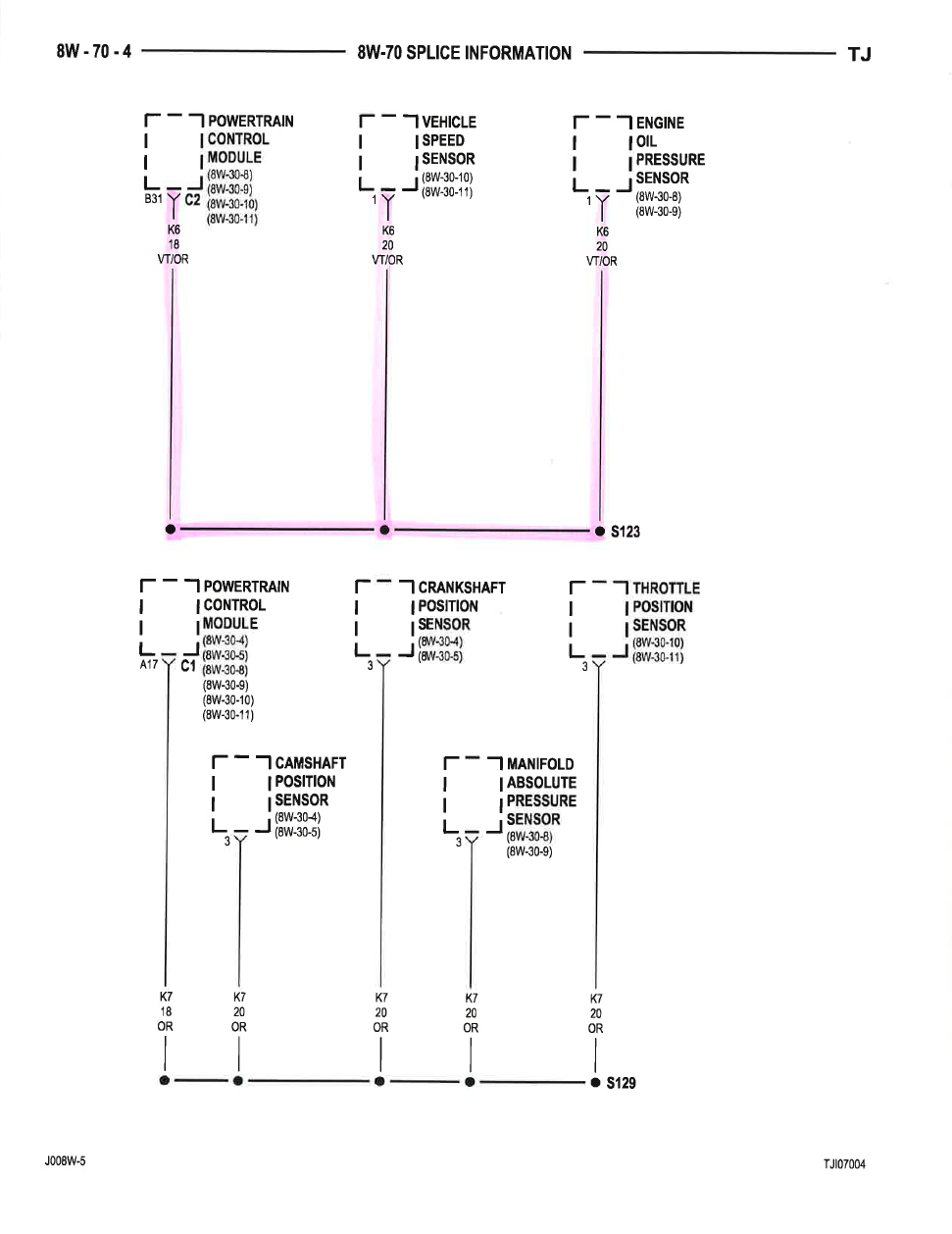

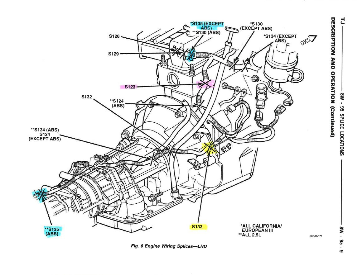

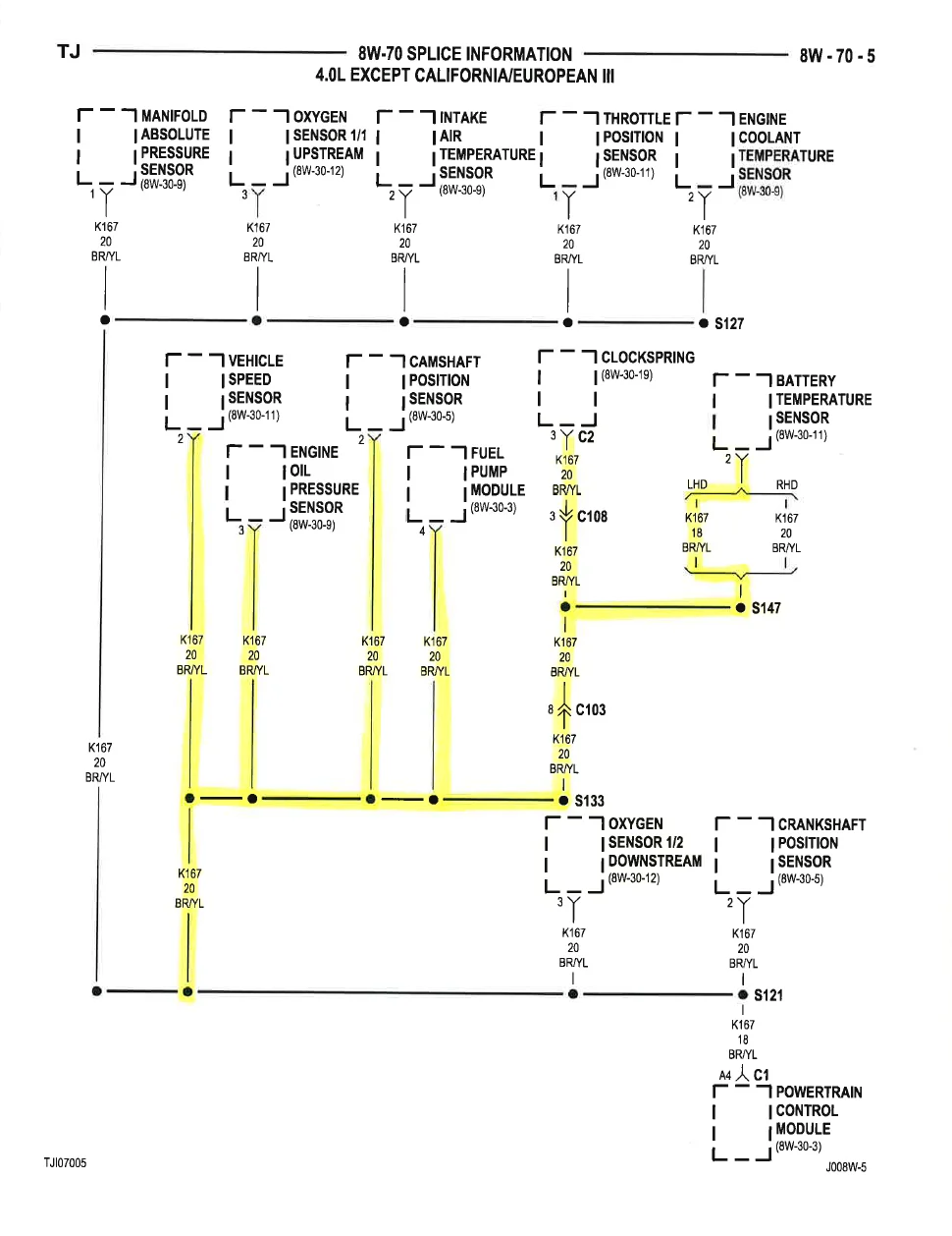

As shown above, there are four splices inside the harness that are no longer active after your splicing. They can be found in the splice locations section of the manual. Here are the relevant pages, with same-color highlighting:
The fix for your current predicament involves two steps. First, you need to reconnect the original wires at the splice in your picture above (red arrow). That will restore all functionality to the other sensors. That's the easy part. The second step is more difficult. To fix your original problem, you really need to find the break in the wire that's causing you trouble and reconnect it, assuming that it's a broken wire. Unfortunately, it takes patience, the ability to read wiring diagrams, and a multimeter to do that.
