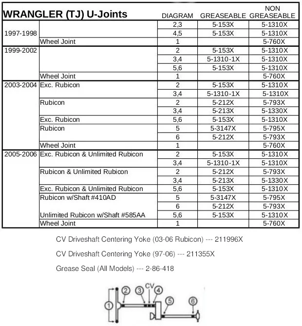

gatertamer Mud dauber Original poster Supporting Member Lifetime Supporting Member Joined Oct 19, 2018 Messages 694 Location Pacific Northwest Jun 10, 2023 #1 Anyone know the spicer u-joint part number for 2000tj with Dana. 35 and 44. Looking for the five pack?
freedom_in_4low I'm a rooster illusion Supporting Member Ride of the Month Winner Joined Sep 26, 2019 Messages 9,918 Location Arcadia, OK Jun 10, 2023 #2 gatertamer said: Anyone know the spicer u-joint part number for 2000tj with Dana. 35 and 44. Looking for the five pack? Click to expand... I've always used the 5-1310x for the driveshafts. Don't know anything about a 5 pack cause I've never done both shafts together. Reactions: gatertamer
gatertamer Mud dauber Original poster Supporting Member Lifetime Supporting Member Joined Oct 19, 2018 Messages 694 Location Pacific Northwest Jun 10, 2023 #3 It's that or 5-760x.... getting mixed reviews
gatertamer Mud dauber Original poster Supporting Member Lifetime Supporting Member Joined Oct 19, 2018 Messages 694 Location Pacific Northwest Jun 10, 2023 #4 Pardon my french.. I meant Dana 30
gatertamer Mud dauber Original poster Supporting Member Lifetime Supporting Member Joined Oct 19, 2018 Messages 694 Location Pacific Northwest Jun 10, 2023 #5 Nevermind I see the 760x's are for the axles....1310x it is Reactions: freedom_in_4low
freedom_in_4low I'm a rooster illusion Supporting Member Ride of the Month Winner Joined Sep 26, 2019 Messages 9,918 Location Arcadia, OK Jun 11, 2023 #6 gatertamer said: Nevermind I see the 760x's are for the axles....1310x it is Click to expand... Yes, 5-760x is the axle U-joints.
Zorba "The Veiled Male" Lifetime Supporting Member Joined Apr 2, 2020 Messages 23,834 Location Merritt Island, Fl Jun 11, 2023 #7 You might as well rebuild the cardan joint while you're there - here's my almost identical thread with the part numbers needed for that. https://wranglertjforum.com/threads/cardan-rebuild-parts.71024/ Reactions: gatertamer, Jerry Bransford, Claybirdd and 1 other person
CodaMan California Escapee Supporting Member Joined Mar 9, 2017 Messages 4,635 Location Dover, Arkansas Jun 11, 2023 #8 Last edited: Jun 11, 2023 Reactions: gatertamer and Jerry Bransford
gatertamer Mud dauber Original poster Supporting Member Lifetime Supporting Member Joined Oct 19, 2018 Messages 694 Location Pacific Northwest Jun 11, 2023 #9 Any reason why the 1310x's are cheaper than than all the others?
CodaMan California Escapee Supporting Member Joined Mar 9, 2017 Messages 4,635 Location Dover, Arkansas Jun 11, 2023 #10 gatertamer said: Any reason why the 1310x's are cheaper than than all the others? Click to expand... They are probably the most common u-joint.
