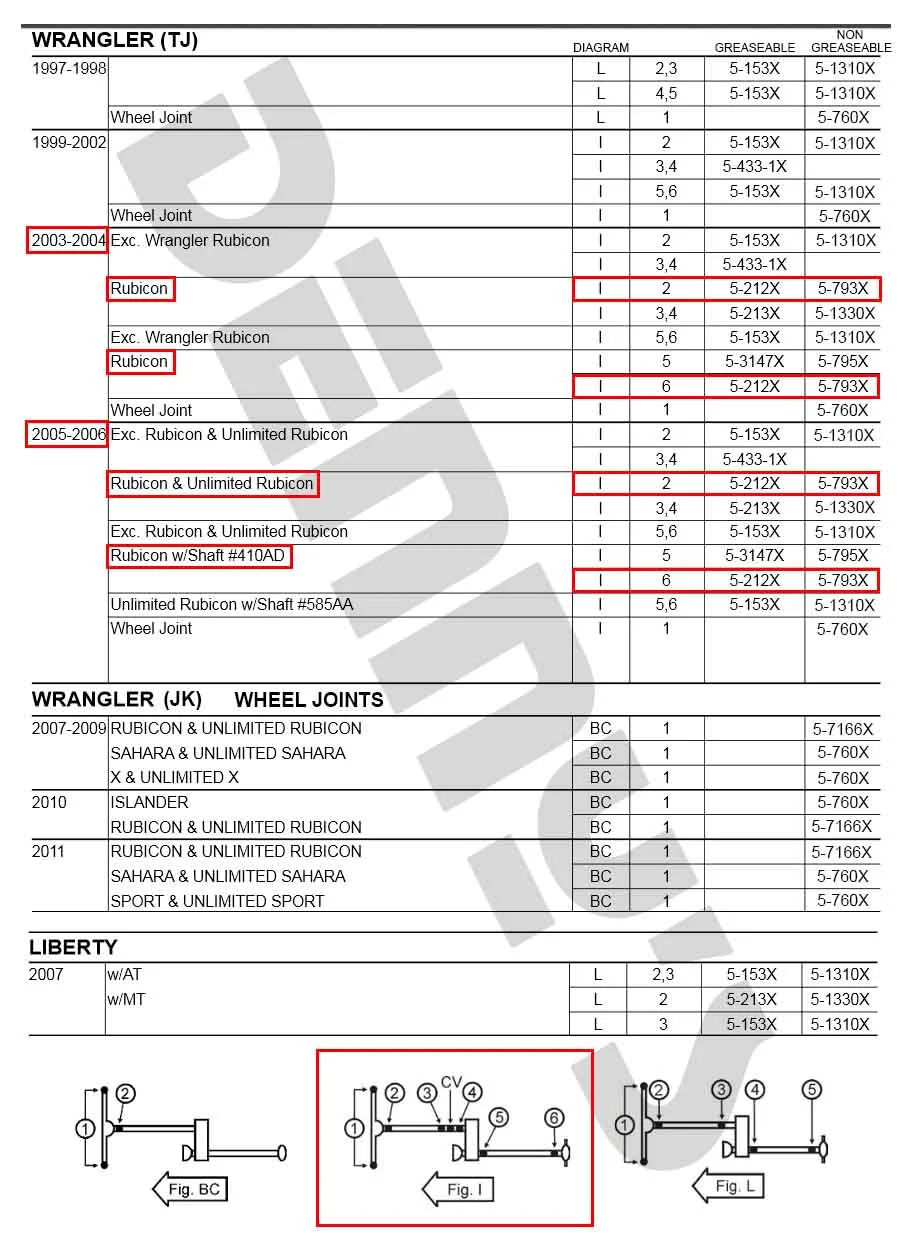

AndyG Because some other guys are perverts Original poster Lifetime Supporting Member Joined Jul 30, 2018 Messages 18,902 Location Alabama Sep 4, 2018 #1 What triple sealed Spicer U joint part number do I need , and are there different part numbers for all 3 of them?

CodaMan California Escapee Supporting Member Joined Mar 9, 2017 Messages 4,635 Location Dover, Arkansas Sep 4, 2018 #2 I just rebuilt both my Rubicon Driveshafts. This chart is accurate, at least for 2003 and 2004. Last edited: Sep 4, 2018
CodaMan California Escapee Supporting Member Joined Mar 9, 2017 Messages 4,635 Location Dover, Arkansas Sep 4, 2018 #3 You can get a rebuild kit here ... you'll just need to add the 5-793X for the pinion side. http://www.dennysdriveshaft.com/p22..._for_2003_to_2006_jeep_tj_rubicon_with_o.html Last edited: Sep 5, 2018

AndyG Because some other guys are perverts Original poster Lifetime Supporting Member Joined Jul 30, 2018 Messages 18,902 Location Alabama Sep 4, 2018 #4 Thanks , hopefully I 've got this thing sorted out .
