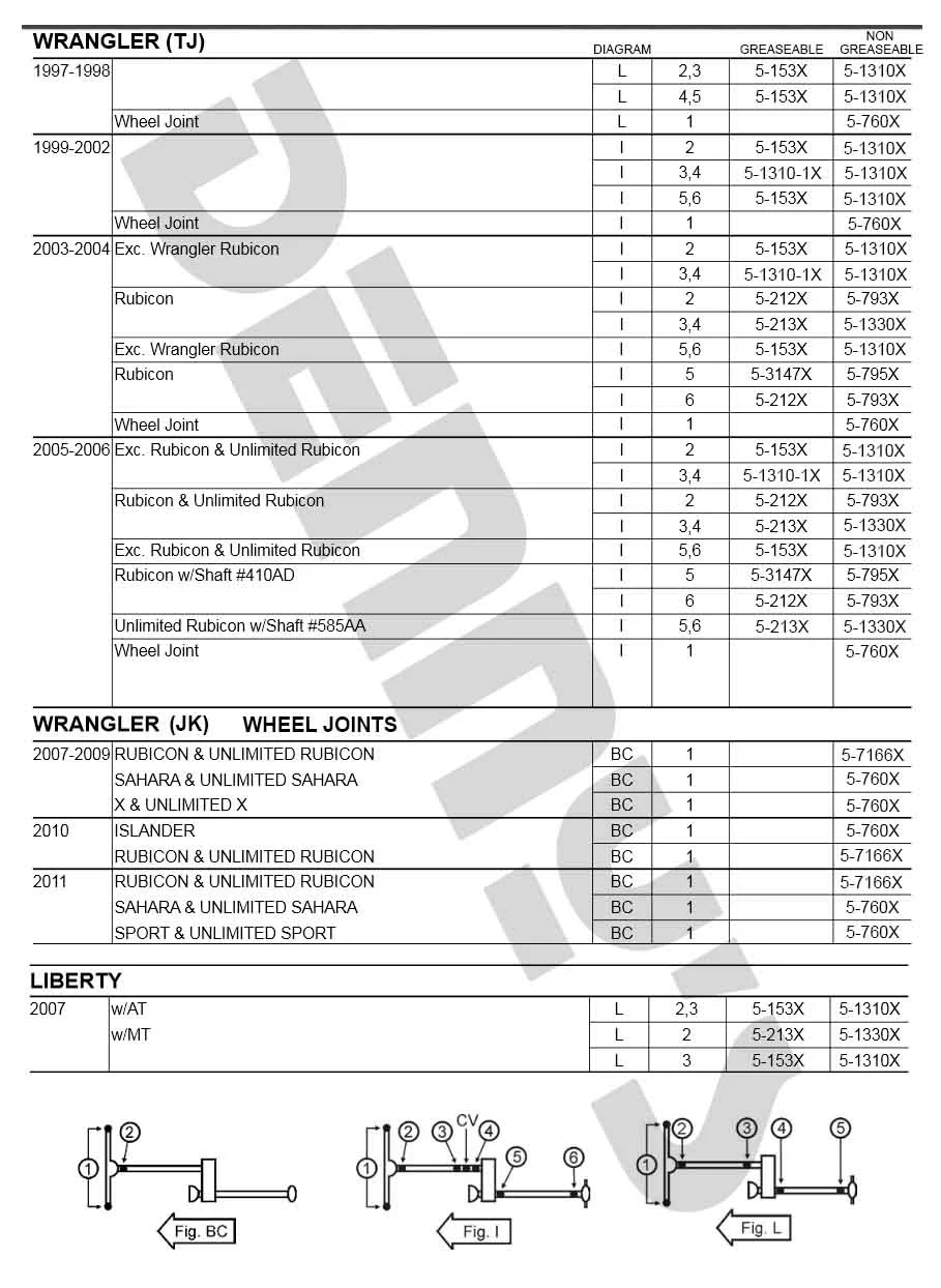

You're going to have to use something very accurate to measure the pinion shaft u-joint yokes on both axles to determine their sizes.
The dimensions of the possible u-joints can be looked up based on the models shown above in the chart. But you also have to know what size yokes are on your driveshafts. You can also choose to install the size yokes you want on the axles to match your driveshaft yokes, 1310 or 1330. 1310 is usually plenty, 1330 can be used for more demanding uses.

You have to know what size u-joints the driveshaft is set up for. Factory size is 1310 but you have an aftermarket CV shaft which is probably 1310 but it could be 1330 too.
