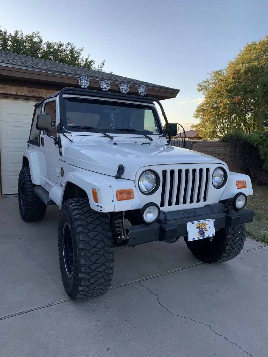

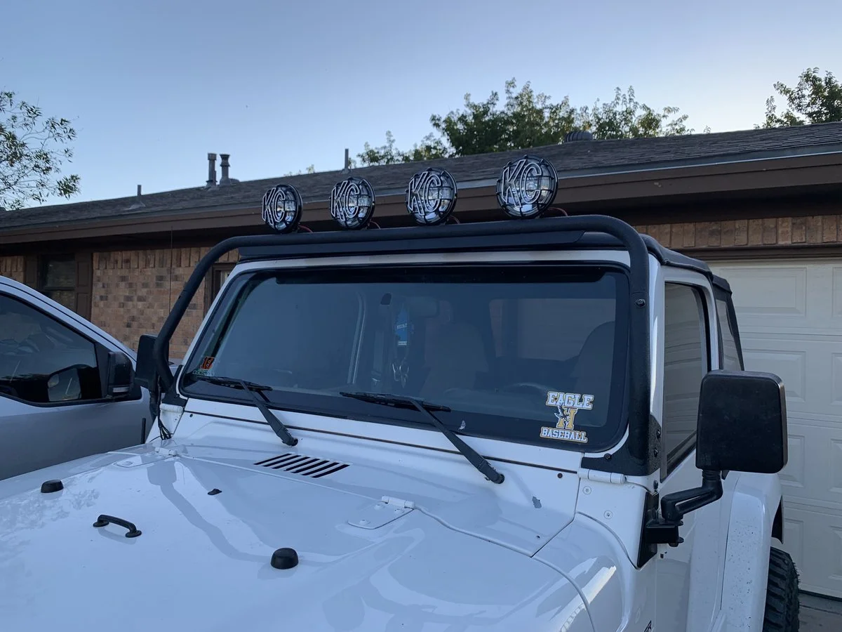

I’ve ordered a light bar for my 02 TJ that fits around the windshield with 4 mounts for lights. I’m wanting to put 4 KC 6” slim fit lights up there. What’s the general consensus as far as using spot vs the flood/spread pattern above the windshield?
Personally I would do a mix, if I had the choice.
My ideal setup would have 2 spot, 2 driving, and 2 flood, on separate switches.
I think the driving light would probably be the most useful of the 3. Spots are good for long stretches of road with nobody around. Flood is good for low speed travel and as stationary lighting. Driving is similar to a low plus high beam

Did you get these installed? How do you like them?
I have the KC slimlite fog lights, and used Daylighter spot lights. They’re quite nice. I’d buy them again. I have the 100 watt bulbs in the fogs, which are almost too bright for on-road use. I have the 130 watt bulbs in the spots

They work really good so far. I went with KC Apollo brand; they weren’t as costly as the slim fit.
KC has halogen, LED, and some HID options. Most of the round style can come as halogen or LED.
If you’re considering high-end LED lights, also look at Rigid Industries
