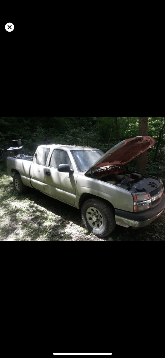

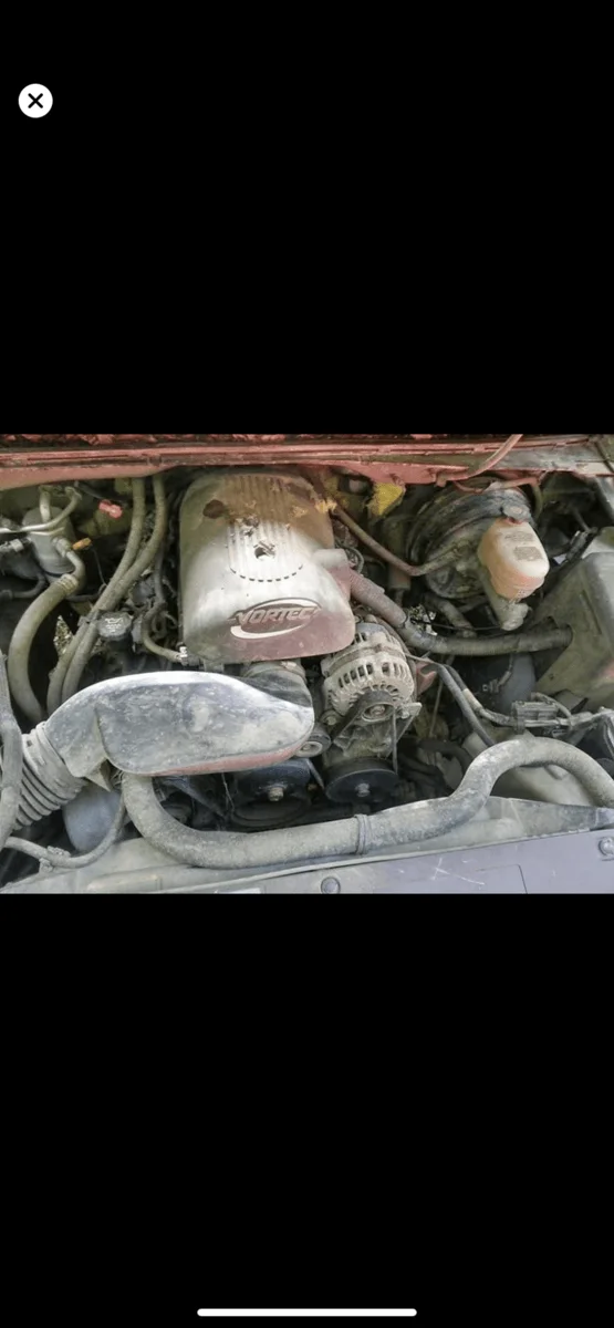

Donor vehicle. It’s not much to look at but been sent a video of the motor running. Hopefully I get a chance Sunday to go take a look at in person and maybe Jew them down a little. 2005 Silverado lm7 5.3. 120k frame rust makes it unusable but perfect for a cheap motor 😂
