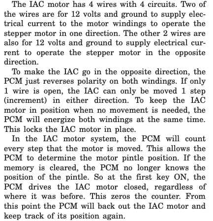

According to the attached snippet from the '04 FSM, the IAC needs 12v to drive it on each winding, and they need to be able to reverse polarity. This is where a stepper motor driver comes in (Which is just two H-bridges that allow polarity reversal and logic voltage/current shifts from 3.3-5v from the arduino up to 12v in this case).
It sounds like a pretty standard stepper motor arrangement, so without delving too deep, I'd start with the pre-built stepper motor library for arduino and a prefabbed stepper controller board for it that is designed for 12v.
The resistance I measured across each winding was about ~50ohms, so the current capacity for the motor is nice and low (roughly 12v/50ohms=0.25 amps per winding). You do need to energize both windings together to keep it in position, but as long as the control board can handle 1 Amp say, I'm sure that would be more than enough since any testing will be with no load on the pintle.
The only downside here of course is that while many people have an arduino kicking around, not as many have a stepper control board on the shelf I'm guessing.
*Edit - Also I've had arduinos do weird things when I try to draw a bit too much current off their pins, so it's possible your existing setup would work perfectly with only a couple transistors bringing the logic from the pins up to 12v just to make it move. I also have no idea how much or little you already know about all of this, so I just want to point out that if I'm stating the obvious or misunderstanding your setup, I mean no offence.

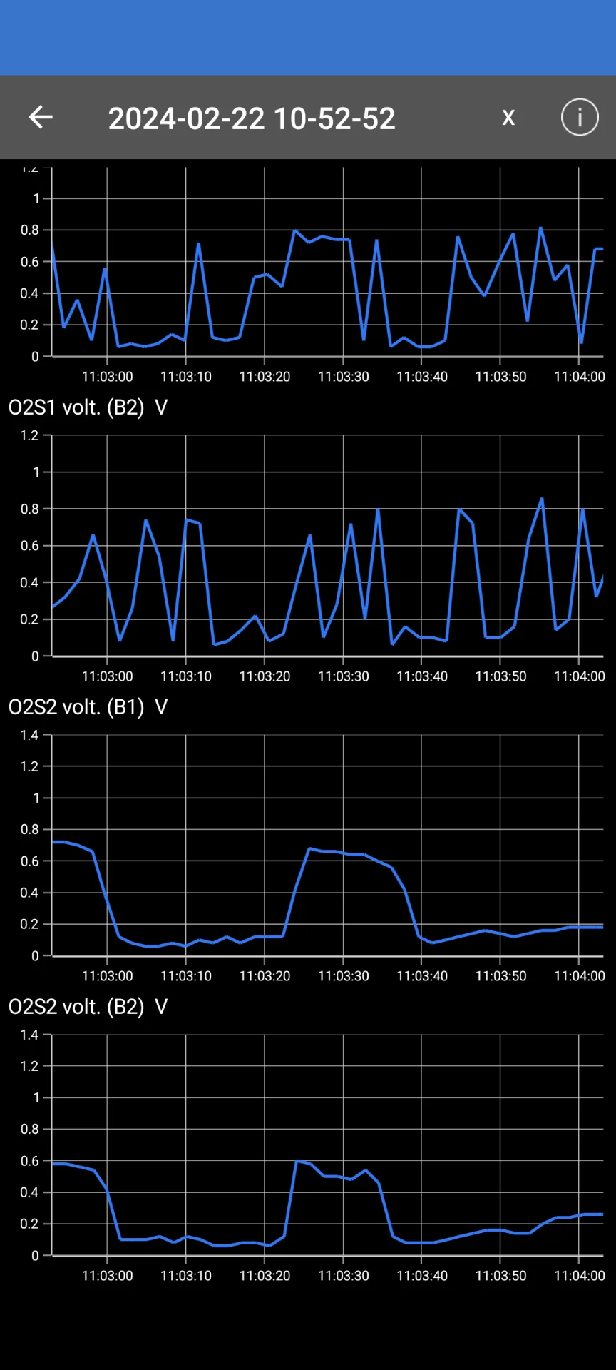

-O2 sensors look really slow to me. Even though there is no code popping up (attached photo, look at time stamps). And downstream sensors flatline at idle.
I am going to remove the serpentine belt and rule out the pulley bearings for the vibe/grind
Then however, IF the o2 readings do indeed seem super slow? And since I've already checked resistance in the o2 sensor circuit, and K4 sensor ground, the only remaining thing in the FSM for o2 slow to respond is an exhaust leak between the o2s and the head. That, or all 4 o2 sensors have gone consistently lazy in the exact same way together (one of which is only 4 months old).
Even though I've hooked up a vacuum to the tailpipe many times, and made sure the bolts on the downpipe and exhaust manifold are tight, it looks like a bad exhaust gasket, or a cracked header, is the only viable culprit here? (I believe the 04s don't have the super susceptible to cracks header, so hoping it's the gasket)
It's impossible to get a good view of every part of the gasket for bubbles with soapy water, so I think I just have to assume that a mysterious exhaust leak that I can only hear under hard accel is a thing? And start pulling off the intake/exhaust manifolds.
