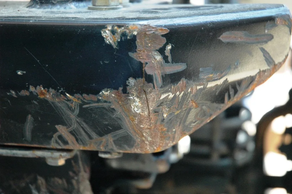

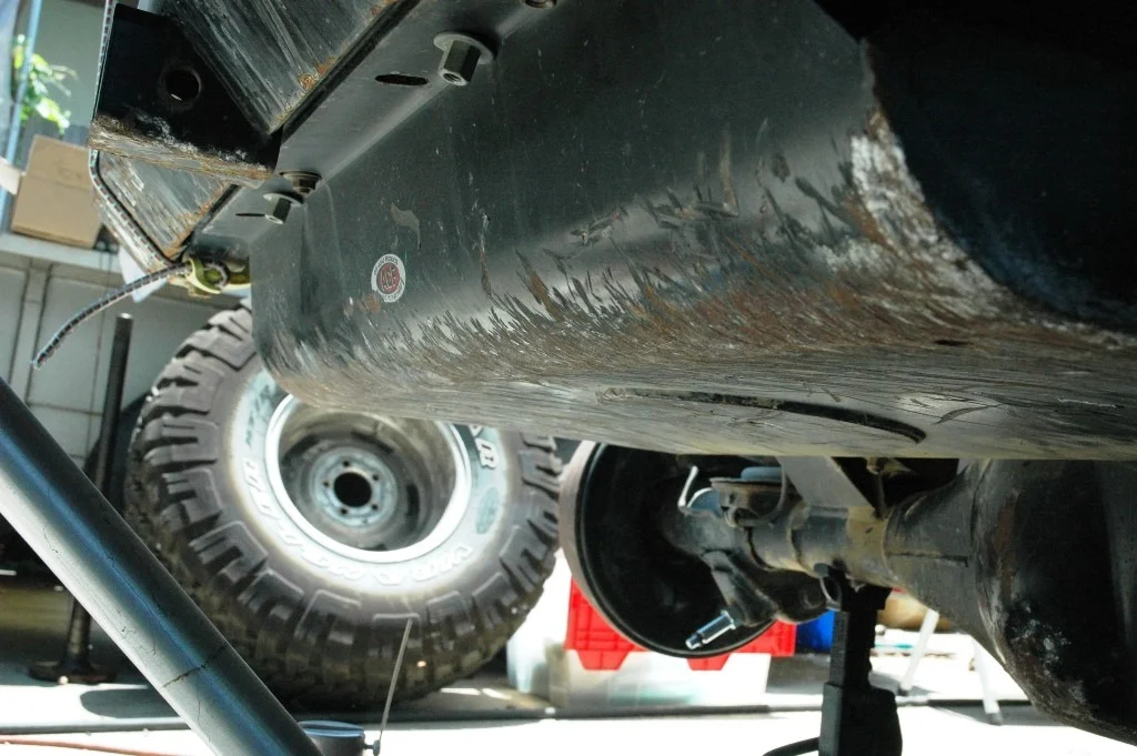

Depends a bunch on your perspective. Yes steel higher tensile and yield properties, but the high strength aluminum alloys have a unique characteristic in that the spread between yield and ultimate tensile is much closer together than the same properties in steel. That means that you will get a lot more resistance to bending or deformation when subjected to the same loads. Another way to look at it is since aluminum is 1/3 the weight of steel, you can double the thickness in critical areas and wind up with something that is stronger than steel and still weighs less since the high strength alloys aren't 1/3 the strength.

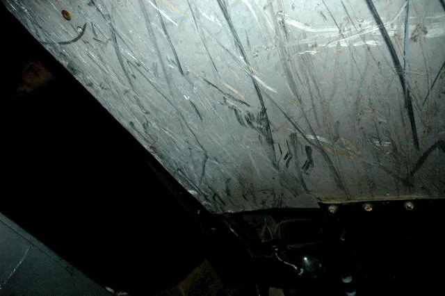

It is a very common misconception that steel gouges less than aluminum.
Here is my belly skid that I put on my rig at least 10 years ago and then proceeded to drag over every rock I could find in JV. Of particular importance I'd like you to pay attention to the length of the scratches since gouging was brought up and that is typically done because folks try to say aluminum gouges and will impede forward progress.

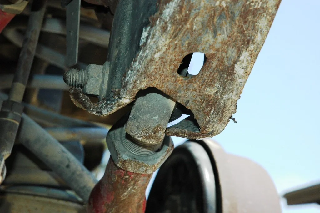

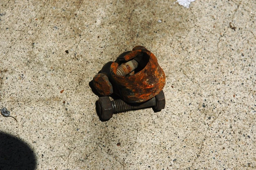

Here are some pictures of what the same rocks do to steel.
So, you'd have to be pretty stubborn to say that steel doesn't gouge after seeing that and the damage to both materials is fairly similar.
