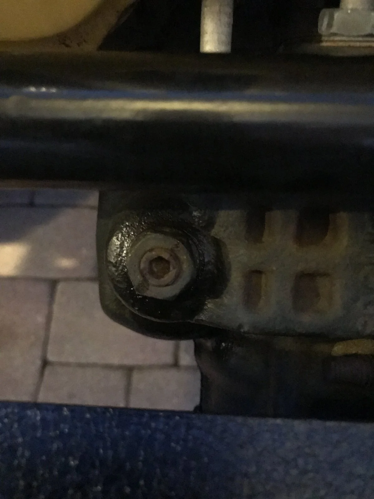

So I had about 1/4 to 3/8 +- play in my steering wheel and narrowed it down to the steering box.
I did the adjustments like the other forums say to do but doing 1-1/2 turns total one the adjuster set screw really made no difference. Is there any other available adjustments I can do?
I’d hate to have to buy a new box.
06 X TJ.
Check the universal joint in your lower steering shaft. You may need to pull your radiator overflow tank out of the way. Wiggle the steering wheel while an assistant watches the u joint.
I figured it out.
That little adjusting screw tightens the steering up when I turn it COUNTER clockwise, no clockwise.
It’s all good now.
