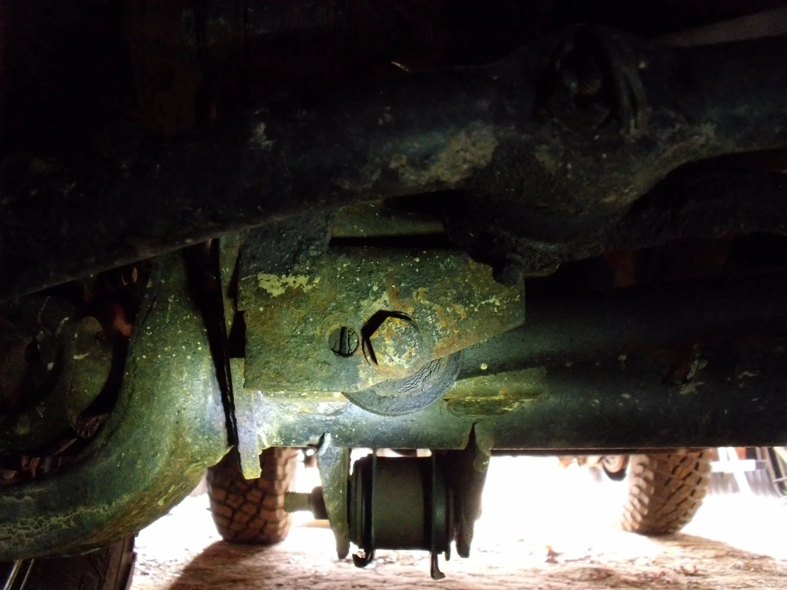

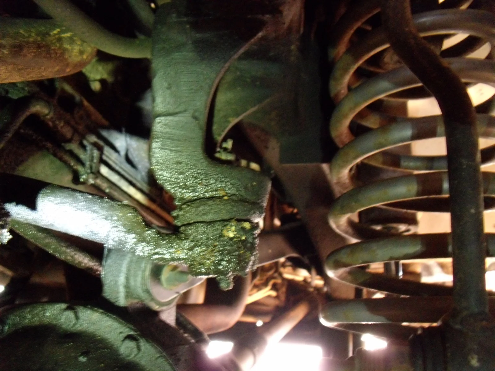

assuming since the front is lifted 4", that's the lift # I use when getting the adjustable track bar and lower control arms? Back appears to only be a 1" lift
So, your front springs measure out at 16" and rears are 9"?
Yes, front springs measure 16", rear springs measure 9" but therears also look pretty old and rusty, they've been on a long time.
Also I'm curious about those rear adjustable lower control arms? Is that necessary for 1" rear lift? Are the front and rear control arms interchangeable? Could it be that the suspension lift kit came with the adjustable control arms and they put them on the rear instead of the front? I noticed that the two rear adjustable control arms aren't set to the same length, at least 1-1.5" difference
