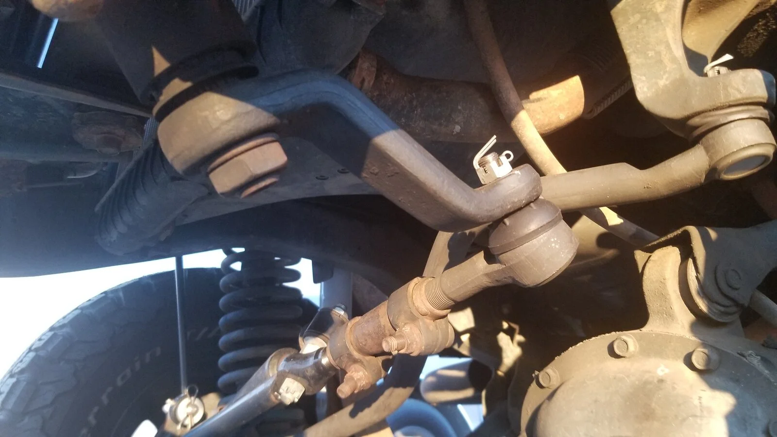

I just bought a 2001 TJ it's my first jeep and it's all over the road. Has some new steering parts and new shocks.steering appears to be tight and no slack. Its has a 4 inch lift. Does this look like a stock pitman arm? Could this be the culprit?
That is a drop pitman arm. Get it replaced with a stock one, and get an alignment. Have the technician dial in as much caster as possible. It will make the Jeep track better. I also like a bit more toe. Let us know how it goes.
Ok thanks. I thought it was the wrong one. I'll follow up when I get it replaced
I replaced the steering stabilizer yesterday. It drove better on my way to the alignment shop. The old one was shot. Had the pitman arm replaced today. Also had them set caster and toe like you said. Still not driving well. It still didn't handle well on their test drive. They came back and found a bad track bar bushing. Replaced it as well. Still not better. Any ideas? We've been scratching our heads
Well before an alignment is done, the steering and suspension has to be all tight. No way around it. Is there free play in the steering, or does it just handle poorly. Does it have sway bar disconnects.have the control arm bushings been shocked? How about the track bar ball end? These jeeps with larger tires need to have all good steering and suspension pieces. How are your shocks? Ball joints? How much tire pressure are you running, and even have the balance rechecked on the tires.q
Did you get a printout of the alignment? What are the specs of the alignment?
Almost everything in front in is new or close to new. Tires are new and shocks are new. Front end feels tight. No play in steering wheel or tie rod ends or ball joints. They even checked all that too. I trust this shop. They are very reputable.
I ment front end. Damn spell check lol
