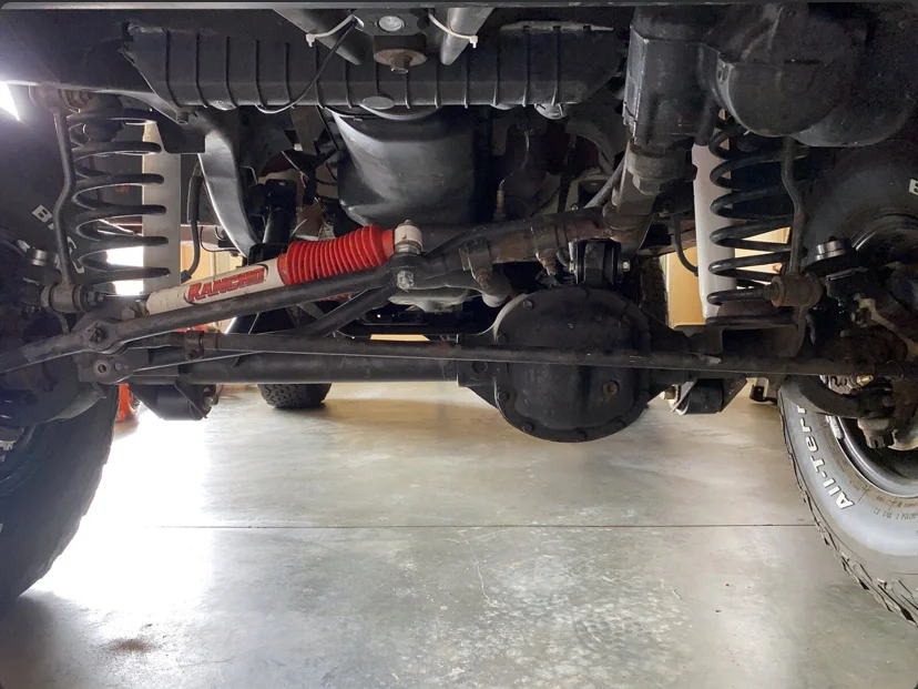

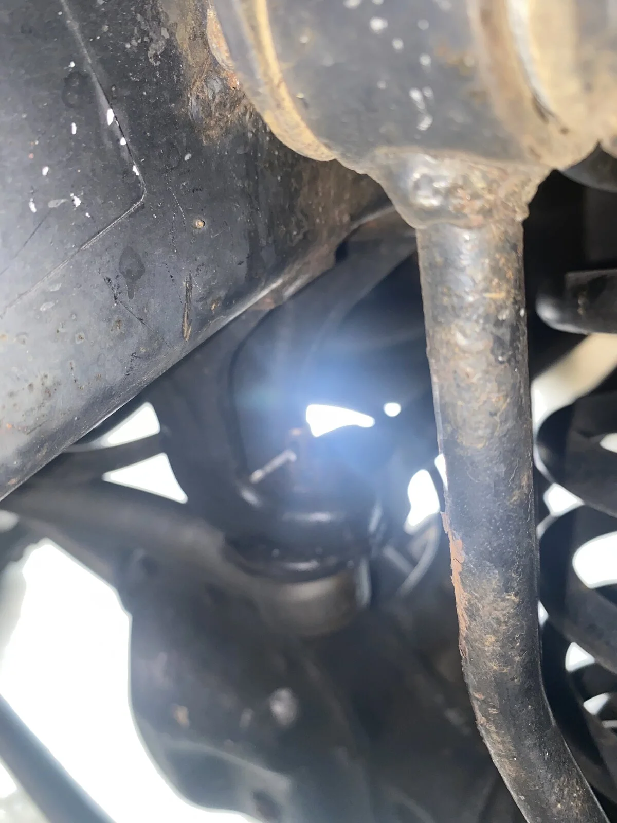

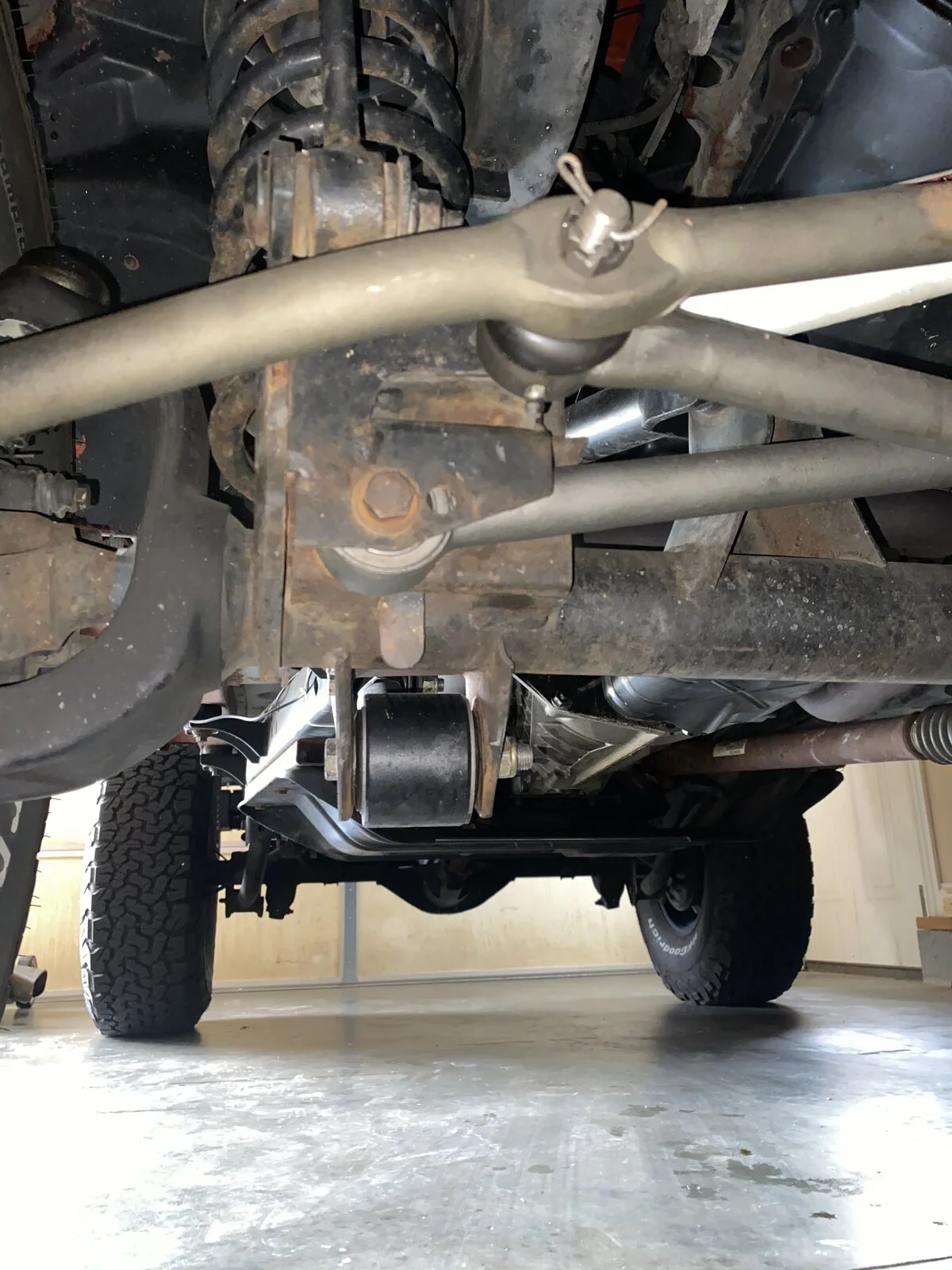

Check the upper control arm bushing on back of the diff, it appears cocked/unseated- you don’t want any excess axle movement.
Looks normal to me, I think.
I’m starting to think my steering box might be going bad. My wheel doesn’t return to center - I’d say it returns to about 70% of center. Theres also a little play in the wheel left to right, maybe about 1” either way. When I had my DPA removed, they told me they thought the steering box could be going bad because it had some play in it.
