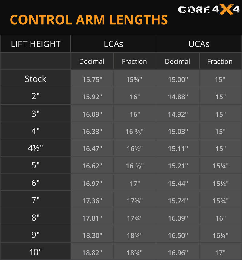

I reached out to Core 4x4 and they were very helpful. They sent me the attached chart outlining their recommended CA lengths. Looks like they recommend the same length (15”) for all upper CA from stock to 4.5” lift.
First, I plan to measure my current CA’s to see where they stack up against Core 4x4’s recommendations, and then adjust as needed.

I measured my CA’s this morning based off of the measurements that Core 4X4 provided for a 4” lift. The uppers look to be right at the proper 15”. The lowers look to be a smidge short at 16 1/8” compared to the 16 3/8” that Core says.
Would adjusting the lowers out a bit by 1/4” (to reach 16 3/8”) increase my caster at all, or should I go more out to 3/8” (to get to 16 1/2”)?

I measured my CA’s based on the chart that Core 4x4 sent me. For the 4” lift, my lowers measured a little short….. Would adjusting the lowers out a bit by 1/4” (to reach 16 3/8”) increase my caster at all, or should I go more out to 3/8” (to get to 16 1/2”)?

I adjusted my lower CA’s out today from 16 1/4” to 16 3/8” per the Core 4X4 specs for a 4” lift. Feels like it rides/drives better on the highway, but can’t say much difference for the backroads.
