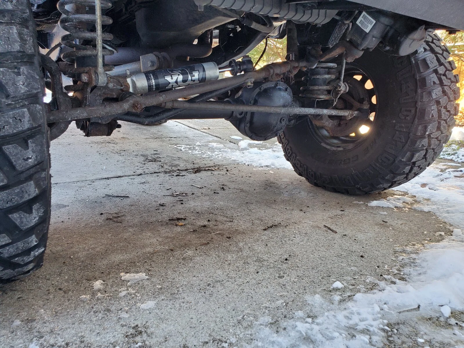

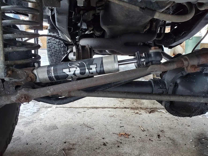

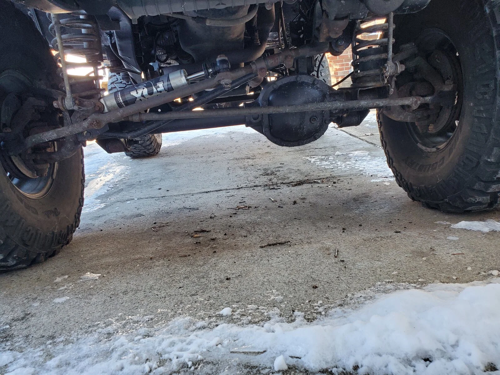

Hi all,
I'm new to the Jeep community, having bought my 1st TJ a few months ago. So far the information I have found on this site has been amazing so I figured you'd have some good advice on what to do about my rubbing steering stabilizer. My initial thought was to add something under it and using a longer bolt in order to raise it up so that it will clear. Do you think that will fix my issue or is there more to this? Any advice is greatly appreciated. Thanks.
Can not quite tell from you pics but it looks like the wrong hardware was used to attach the stabilizer to the drag link.

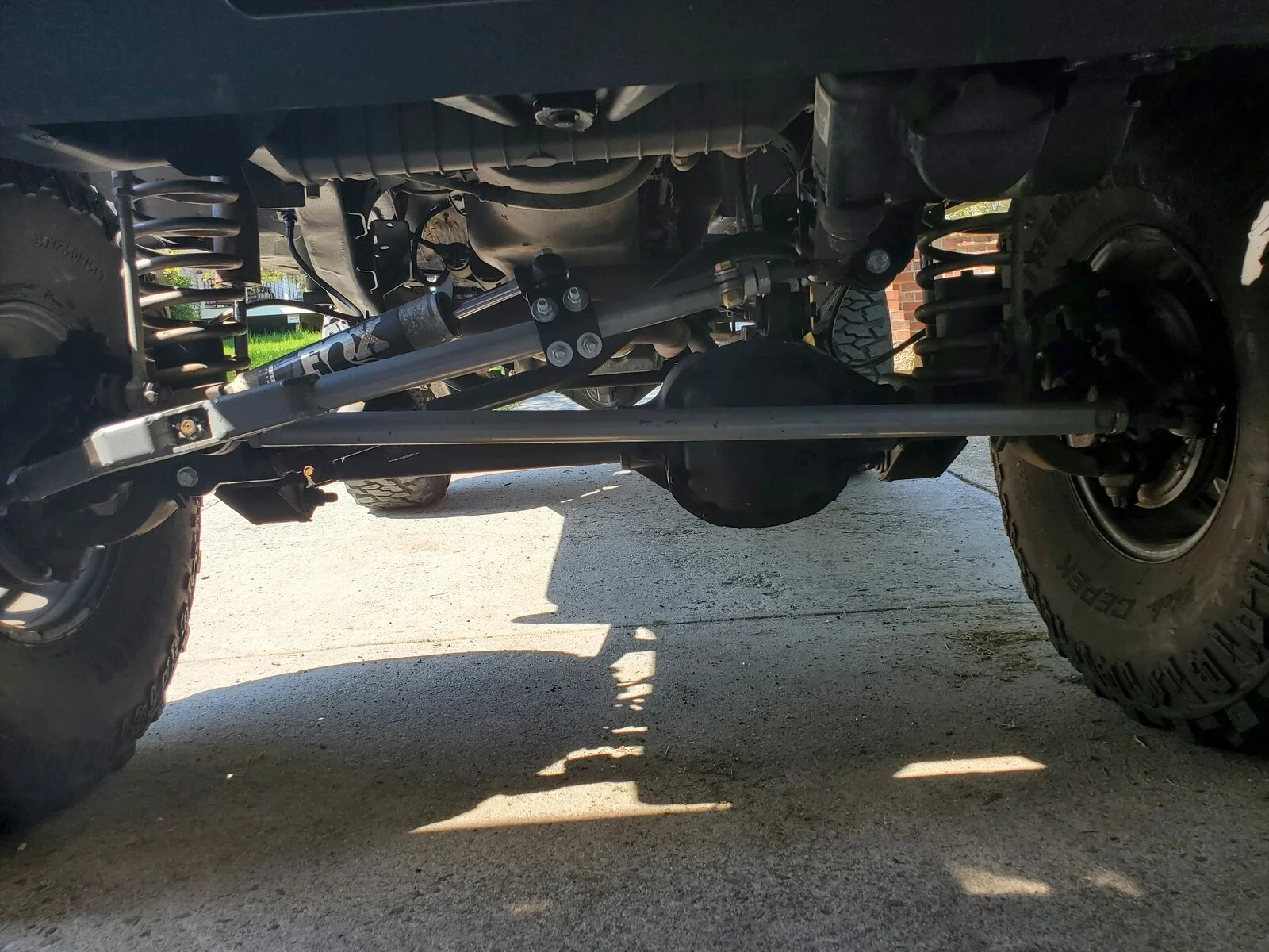

I ended up upgrading to a Rubicon Upgraded Y-link steering kit. I needed the steering upgrade, new front and rear track bars and an alignment. Rides much better and the steering stabilizer now clears.
