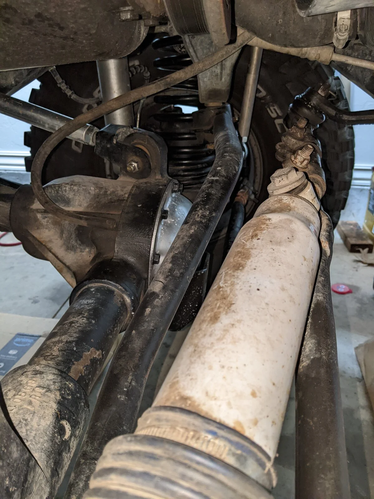

Pitman arm angle with wheels straight

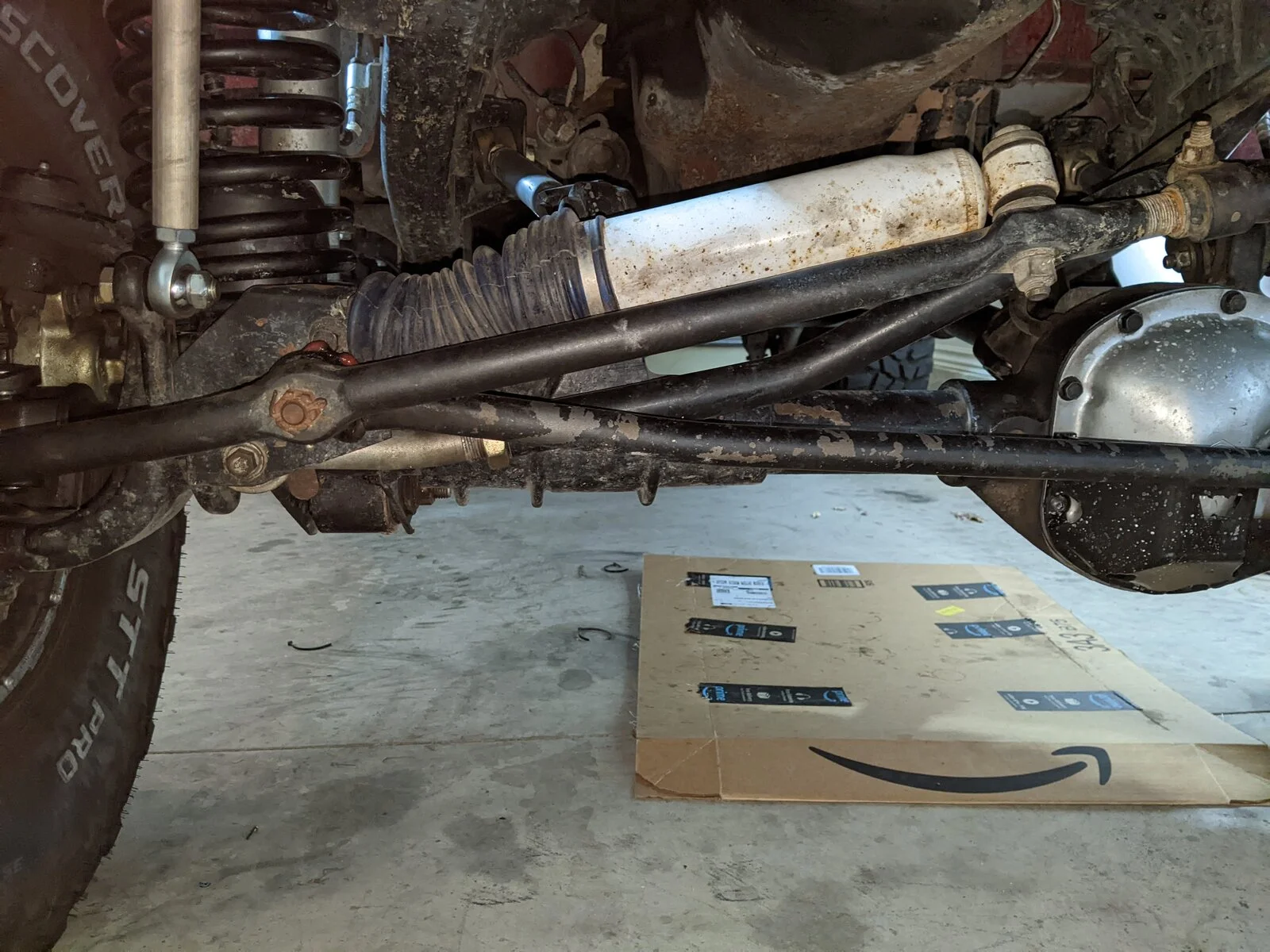

Here's a couple photos of mine. Note the tie rod to drag link joint is pointing basically straight forward, and the steering stabilizer bolt is pointing a little forward but mostly down.
In this second photo, note how there are a couple inches between my track bar and stabilizer, so even if my drag link spun back some, they still wouldn't touch.
Makes me wonder if your track bar is bent. Mine is a Currie/Rockjock.

Yes it is. Haven't bent it yet, so I have no complaints. I didn't bend the stock one either though...I only upgraded because the threads were rusted so bad that I couldn't adjust my toe when I needed to after getting rid of the drop pitman arm it had when i bought it. When you compare the two side by side you'll see how much beefier it is.

I would have guessed that the steering wheel being a fair bit off center after the curb impact as being a large clue that something was no longer how it started out.

It was completely 180 degrees upside down hahaha. I’m an optimist and everything seemed to drive fine (and look fine to my untrained eye) and I’m in college with a heavy workload, it was good enough to go so I’ve driven it and wheeled it after an alignment for about a month…
That would have been the first question I asked. What bent or why did my steering wheel rotate off center so much?

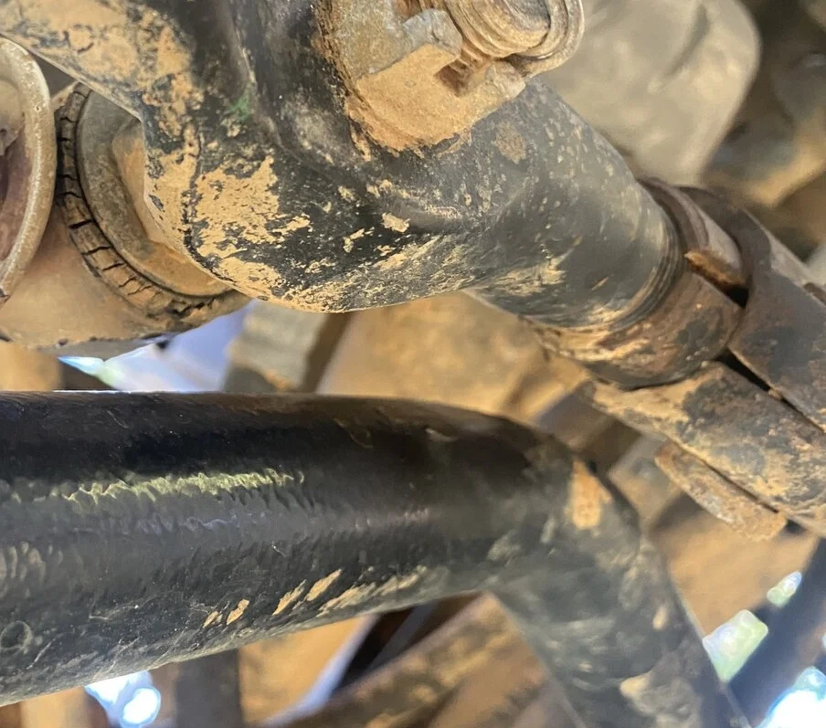

I didn't see a rust spot. I saw mud. The fact that the damaged spot is a little out of focus doesn't help.
Mr. Blaine - you've answered a 2 year old question for me. I was wheeling with some friends. One buddy got a flat when he whacfked a trailside rock. We fixed the flat and finsished our ride. That night in the camp, he mentioned his steering wheel was off center, and he had a warning light (JL) regarding that. I helped him adjust the steering back to center, and the warning light went out. I looked at the steering gear while I was under the Jeep and it looked OK then. Now I expect he has something bent, just like in this thread.

Comes with experience to spot that, my untrained eye never even thought the TB could have bent. I’m still learning, but after putting the ZJ Conversion upgrade and my new TB on, I think I’ll have a better understanding the steering components, how they work together, and what could be affected by situations like smacking a curb in the future.
I recently upgraded mine as well and was impressed with how rugged it is. I also find the adjusting sleeve a lot more convenient than the jam nut when you're trying to align it after.

Thanks Blaine, if you look at my other post about my steering stabilizer contacting my track bar, there’s a video of me being a dumbass on top of a slick parking garage and slamming into a curb on my passenger front wheel.

I ran my passenger front into a curb on an icy hill in my TJ... Last year (at age 37). Didn't bend a rim but I had to turn my drag link sleeve about 1/4 turn to re center my steering 🤣
