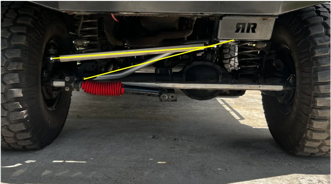

Is my pitman arm and track bar too close?
There are several things that are wrong here. But as for your question, if it doesn’t interfere then it doesn’t interfere.

Why was it needed? A proper setup steering won’t benefit much from a stabilizer. If you notice an issue with out it then you do In fact have bump steer. From the pictures I would guess you have some bumpsteer.
What is so kludge about my Setup?
It is a hodgepodge of marketing. They sold items under the misinformation they make things better. In fact they make things much worse.
With the high steer you are in the realm of custom track bar mounts to help with your angles. None of which are needed for a stock axle.
All jeep TJ’s came stock with a steering stabilizer on it. Is your steering on your Jeep so incredible you took yours off? I agree with a great setup you don’t have to have one on there. And I drove my Jeep 2 hours home without one from the trail. Ya it felt different but I like it on there and do notice a better ride with one on the without. We all have different setups here. There’s always a better setup someone has. This is what I got and what I am working with on my Jeep now I and it’s been great. I will consider maybe changing it one day to a more beefier factory setup like the Currie or something but I just was having some clearance issues with my pitman arm. Thanks for everyone’s input I really appreciate all the great advice I will recheck everything when the PA is on and check my angles to everyone’s recommendations on where to do it.

I do know what bump steer is.
Alright, then perhaps you can share with the class exactly what the below picture represents and if you say anything other than severe bump steer, then you do not know what bump steer actually is.
And as for the angle finder per josh’s instruction at rubicon express he said to to put my angle finder there.
Doesn't matter what you were told, if it is wrong, who told you don't make it right.
Thank for the nice drawing. Again I will recheck my angles when I install the PA I was just going by RE direction and I still was having issues so I came here for the advice not how my whole setup is shit and how I need to change this or go with that or the discouragement. I just wanted some advice on what steps I should do to correct the issue I am having on the current setup I have with the clearance issue of my PA and what I am working with. I am not wanting to get into a bump steer argument or debate or the causes of it or if you think I have it or not. I will take my angles from the corrects points which I was always under the same impression as you to take them from as well. I just had clearance issues and needed to know how I could fix it. And I posted the wrong spot to take the angles from, I get it.
I understand where you need to run what you have. We have all been there. The issue is putting in the effort to correct things that would automatically be corrected with tried and proven parts. Blaine has built and fixed more Jeeps than most have ever seen. He is not wrong. Nobody is trying to be a jerk. We are all just trying to point you in a direction to have a proper handling rig.
I appreciate that and the help but damn, it sure does sometimes seem like if you don’t have a stock Jeep or run all the certain things people want you to run on your Jeep you get nowhere on here. But it can be such a great resource sometimes. It’s always bad mouthing the brand you went with or how wrong your setup is and how you should have, would have, or could have done it better. What’s the point of even trying to ask for help with the issues on your setup here if your always going to get led down a hole that’s only going toward what certain people want you to go with or how IT SHOULD BE DONE or Nothing else. Blaine definitely knows his stuff and his advice is much appreciated and I want to hear more of it now and in the future. Like I said though going with something like the Currie would be bad ass and I know would help but I don’t have that luxury right this moment and I’m working with what I got for now. But until then…lol I am swapping the PA this afternoon and see where that takes me and will take my angle measurements. If it’s really that far off and not drivable I will take Everyone’s advice on a better setup to go with and ditch the teraflex high steer completely and save for what you guys recommended.

It looks like it will solve the interference issue if that is what you are talking about.
Since we're only focusing on this particular problem of the overall steering setup and nothing else, then I suppose it will.
