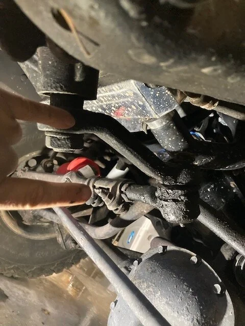

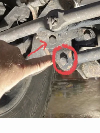

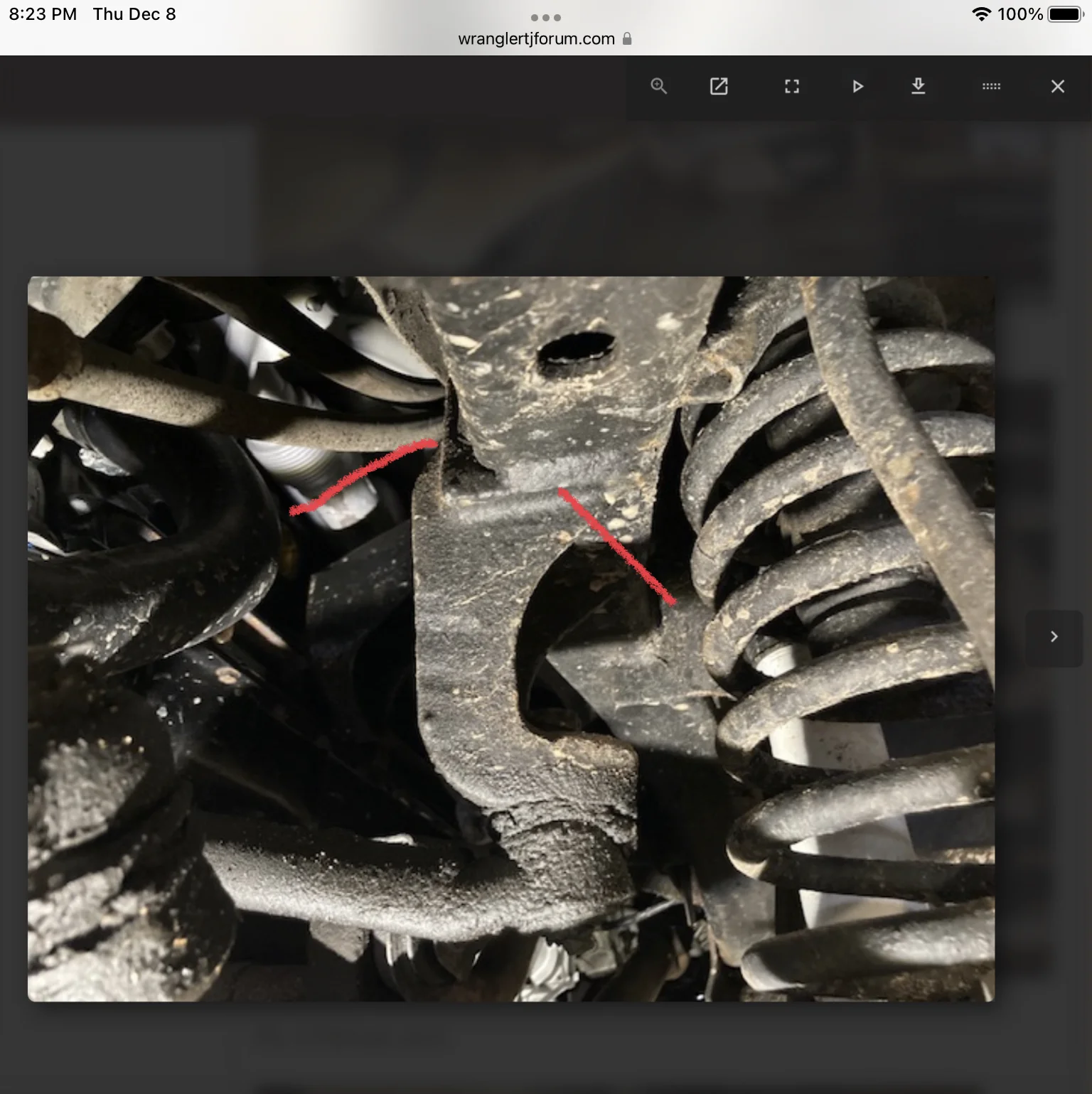

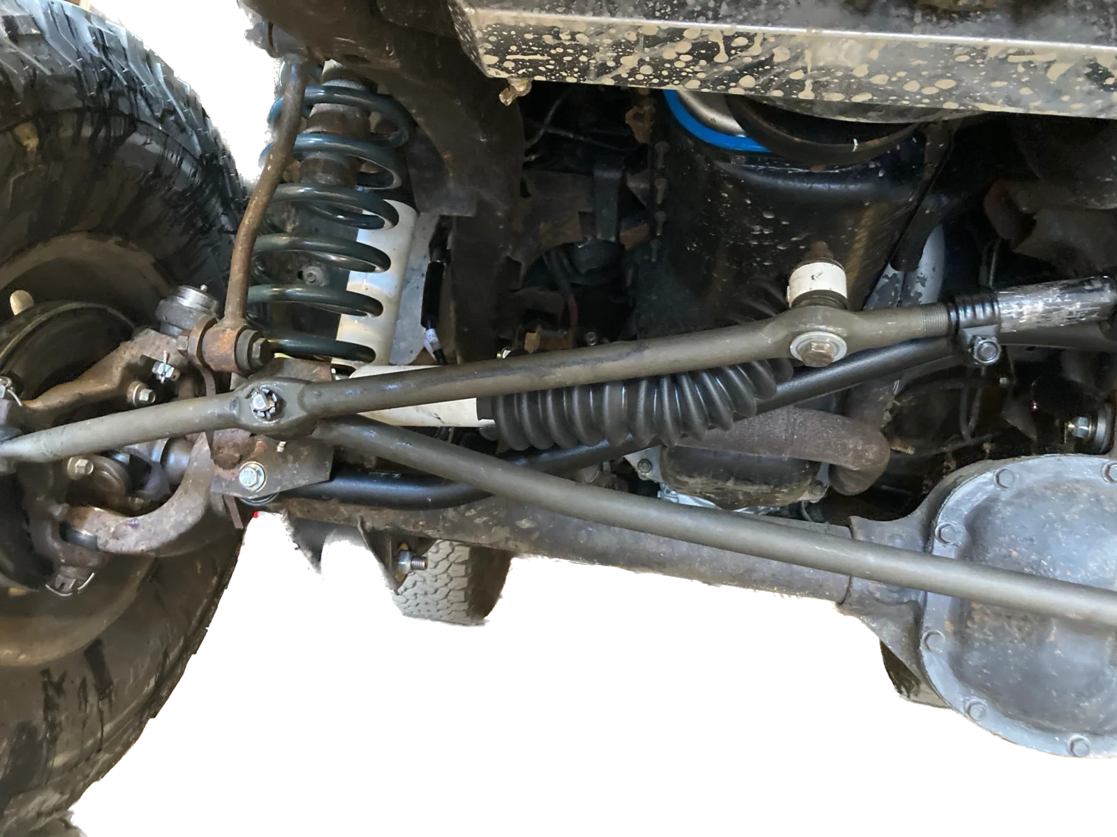

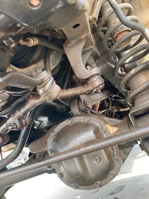

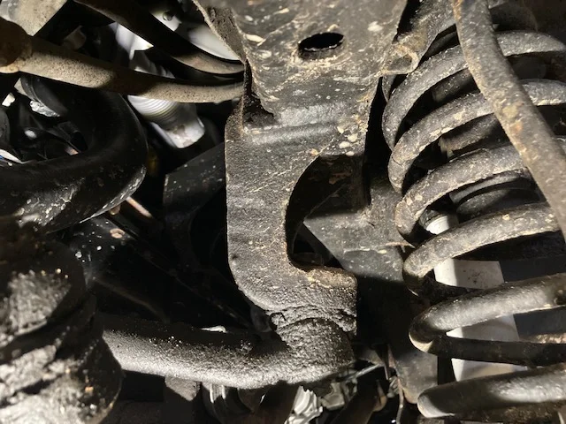

I purchased a 98 Wrangler TJ project Jeep in February with about 3” of lift and after rebuilding much of the drivetrain (4.7 Stroker, np231, ax15, ujoints) I’m moving on to suspension work. I replaced the BFG 33x12.50s, shocks with RS5000X and the steering stabilizer. It has significant side to side movement, not a death wobble but significant lateral instability. I read some great posts here that lead me to look at the track bar, which looks to be stock with a worn bushing. I plan to replace it with a heavier, adjustable bar. I expected with a stock bar for the axle to be shifted toward the driver side but it‘s actually a bit shifted toward the passenger. I’m curious if the axle mount is factory or aftermarket (pic 1)? Also this looks like a factory frame mount (pic 2)? Finally, checking the steering linkage for parallel to track bar, the pitman has about 2” of total drop, which doesn’t seem stock (Pic 3) when I compare to mopar pics?
So, if the axle mount is stock, I’ll restore the pitman to stock and install an adjustable track bar to center the axle. Then with that baseline, I’ll replace warn ball joints and tie rods ends. Thanks for any help. FYI, this my first time posting pics in the forum-feedback welcome.

Pic 1 Track bar axle mount
Pic 2 Track bar frame mount
Pic 3 Pitman arm
