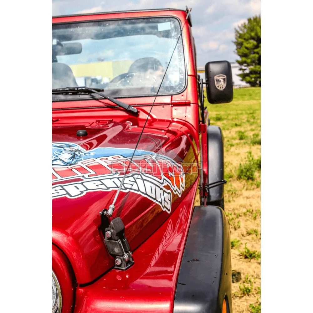

But Chris, they come in so many pretty colors, who cares if it works or not! 😎
Let's just remember, Steinjager also makes these:
:ROFLMAO:

FYI Chris, just because they make limb risers doesn't mean anything. Lots of folks need and run them so that in and off itself doesn't mean anything. The merit of each product is far more important.
I know, I was more or less just poking fun at the limb risers. I know people use them, they always just looked silly to me. I’m sure they work though.
I can think of once or twice that I've needed them...but since I'm not in sub-Saharan Africa, it's not a daily thing. I do like their pretty steering color choices, though.
