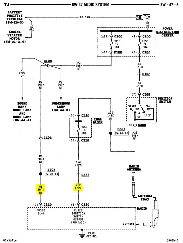

I bought my TJ with a Kenwood aftermarket stereo, it always reset with the ignition, and so never stored any data for the clock/settings etc which was annoying. It was also horrifically flashy.
I bought a Blaupunkt Madrid 200 which looks a little more muted. The wiring harness was already fine and so i connected it all up and it works fine. However the same thing happens where the stereo loses all memory with the ignition.
I've read a few things regarding the yellow wire needing to be switched, but i'm not 100% sure what i need to do here.

Car radios need 3 power wires... a ground wire, a constantly live +12 v, and a switched +12 volt that turns the display and radio off & on. The constantly live +12 lead keeps the clock and the station presets alive.
From your '98 TJ's radio wiring harness its colors are:
Constant +12 volts is a pink wire with a white tracer running down the pink.
Switched +12 volts is a solid pink wire.
The radio gets grounded through its mount plus usually a braided ground strap that connects to a bolt on the back of the radio.
Here's a wiring schematic...
Brilliant.
