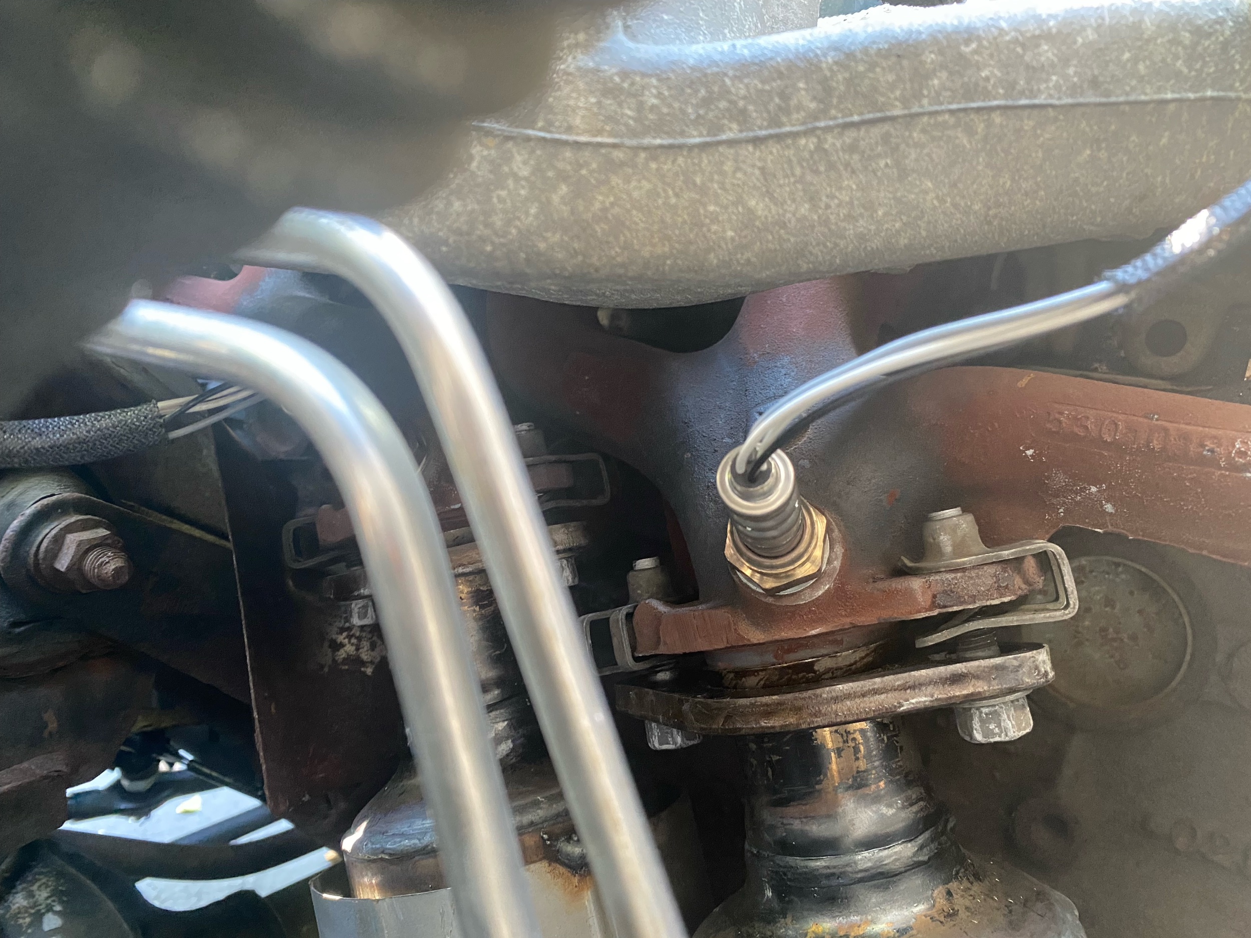

I pulled off the old one by removing the 4 bolts (two per pipe) coming off of the exhaust manifold. Look at some YouTube vids for that, it's a bit tricky, but videos are helpful. Also, I did most of the work from under the Jeep but needed extensions to the ratchet. Spray the bolts a day or two ahead of time with PB or WD-40, and spray them a couple times over a couple days leading up to your repair weekend. It helps when those lubricants have time to work.

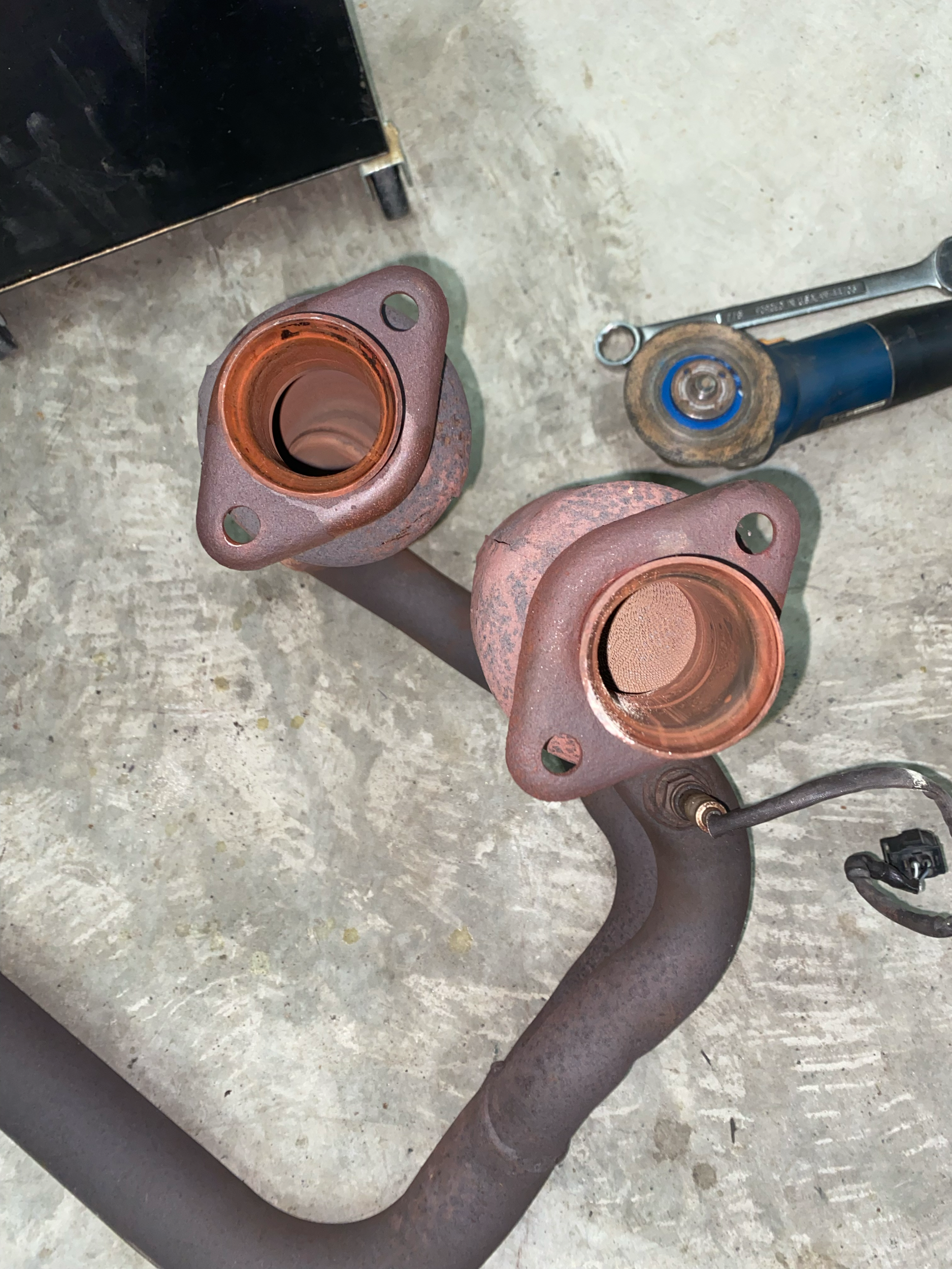

Once removed, I looked into the opening to the pre-cat. Photo 1 attached. To my surprise, only one pipe had the catalyst reticulate material inside. The second bank catalyst was completely empty. This attests to the O2 and computer not being able to triangulate sensor readings. Clearly, the pre-cat was the issue.

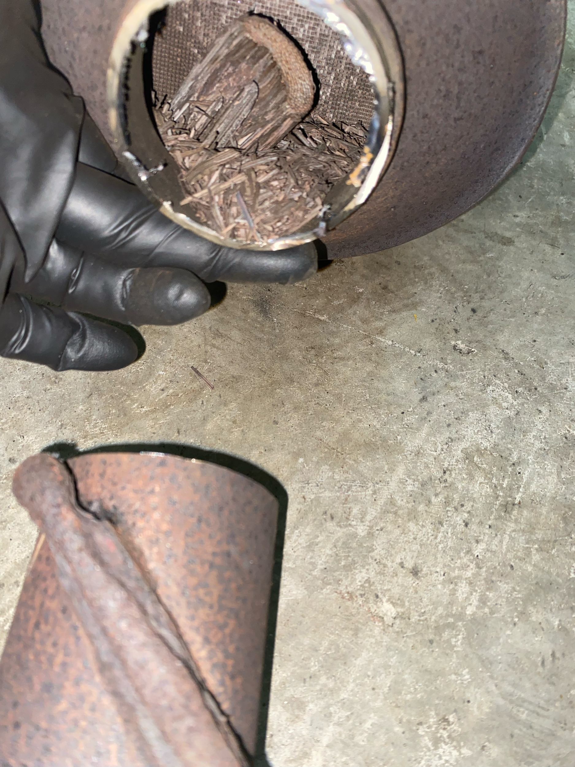

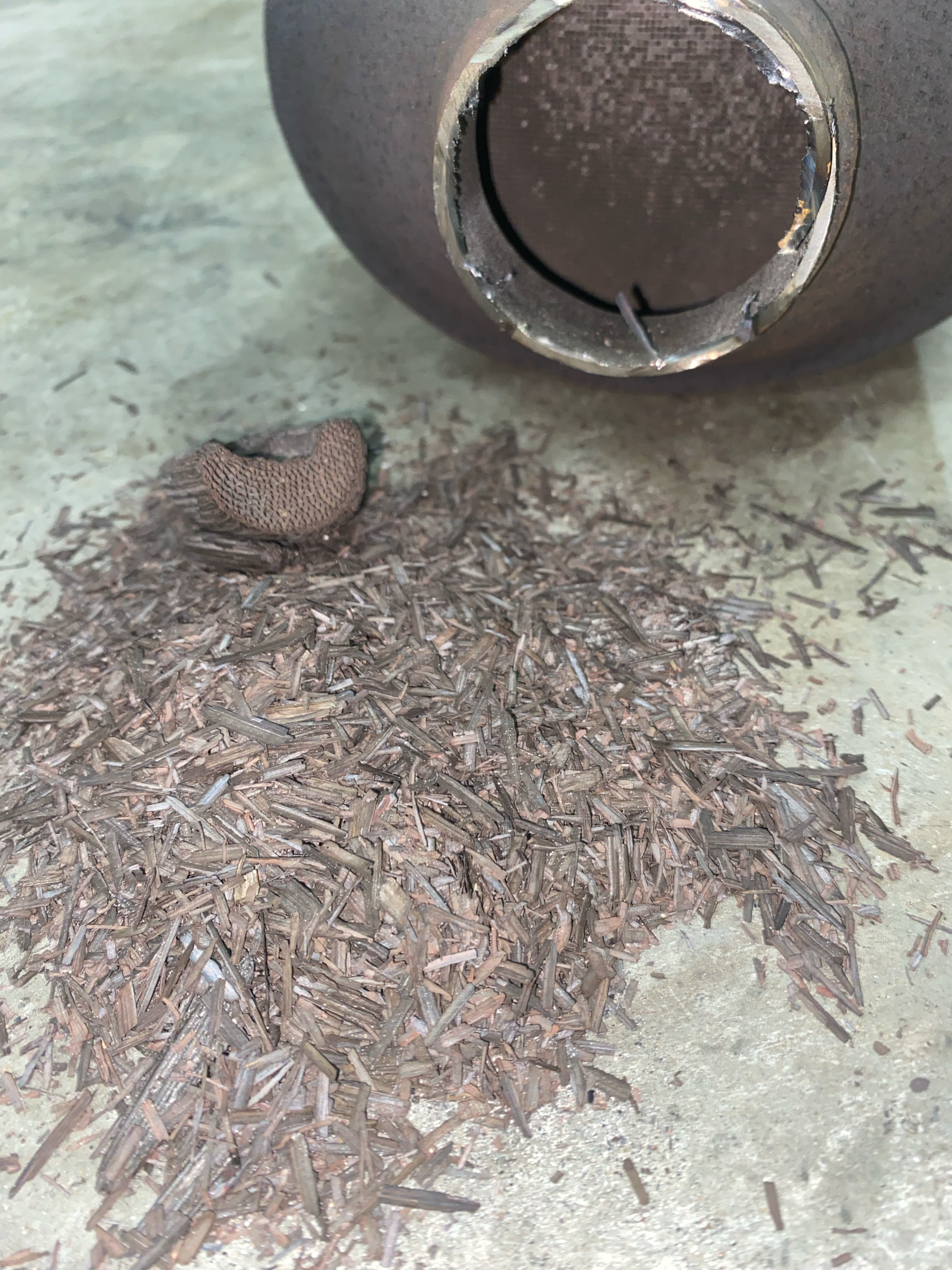

Having removed the entire unit, I was curious where all the catalyst reticulate material went. I decided for giggles, to cut the pipe just in front of the catalytic converter and found the decimated material. This had the secondary consequence of clogging the catalytic converter (Photo 2). Not only was there a pile of reticulate mulch in there, but it had also plugged some of the catalytic converter reticulate as well. This would figure into the loss of performance and worse than usual bad gas mileage.
The extent of debris is shown in the third photo.
