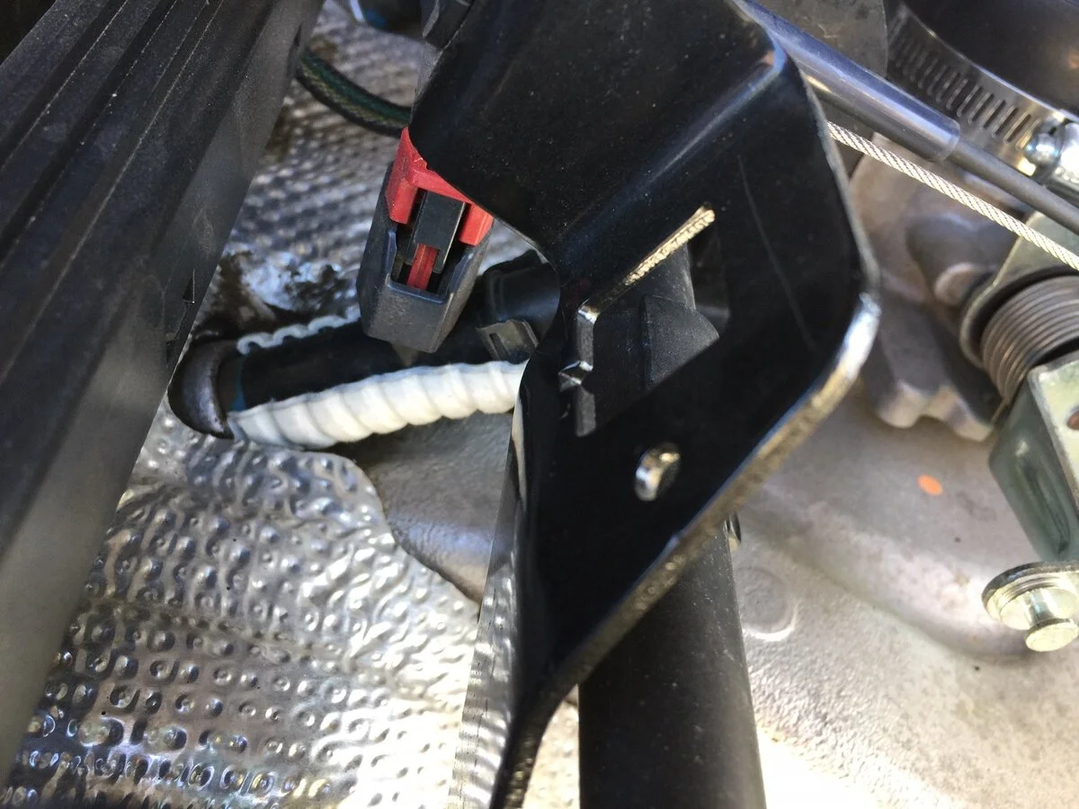

Figured out what the problem SHOULD BE; getting heat soak into cylinder 3 injector. Pretty common problem with the 4.0s. Ordered a insulation heat shield on amazon. Should be here shortly. Gonna install that and see if I have any luck with that

I just installed the heat shield tubing today
