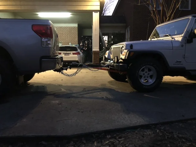

I needed to remove the stock rubber bumperettes to install a tow flat tow brackets on the stock front bumper. Decided to make a quick video to confirm how and that it is necessary to access the fasteners on the bumperette. Hope this helps someone.

The bumperettes are at the end of each frame rail per side. They are there for low impact, however add some compression absorption. The tow bar has re-enforcement plates on the backside of the bracket on the inner side of the bumper. I towed it today testing it for about 40 miles at 70+ mph and it handles exceptionally well. As for the airbag, not finding any details that this could cause deployment, remember many folks pull Jeeps flat behind RV’s with great results. This was a great addition to not have to drive 600 miles in the Jeep. I am old and the truck is way more comfortable then the 17 year old LJ 😂

The tow bar is designed to pivot and does not apply tongue weight. By design it does not apply shear to the bumper like a traditional trailer. The additional plates and the fasteners are rated to tow 5,000 pounds and reinforce the bumper given more tensile strength.
Adding a hitch to the bumper on the rear would allow tongue weight in shear and pull force in tensile that the bumper is not designed to handle. The bumper is there for impact to lessen the load on the frame. Installing a hitch receiver directly to the frame under the bumper applies the shear and tensile forces to the frame that is designed to handle the load.
