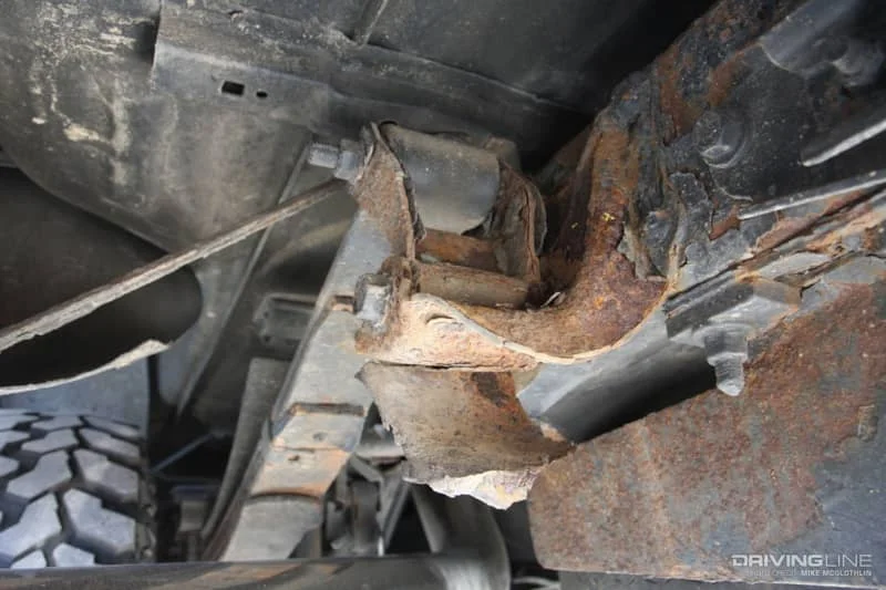

For guidance the frame looks something like this at its worst spot..note not the actual vehicle.
Rustmort looks like a really good product, but not sprayable. Rust reformer by rust oleum is sprayable. Anyone used that And satisfied with the result? Still poking through the search bar for more ideas.
On a C-channel frame like that I would use a sandblaster/wire wheel/ etc to manually remove as much as possible then get it washed as clean as possible before ever applying a rust reformer. Unlike the frame on the TJ you have pretty fair access to most spots. The more rust you can get blasted off mechanically, the better chance the reformer has of penetrating and stopping future rust. That is how I would approach it anyways.
