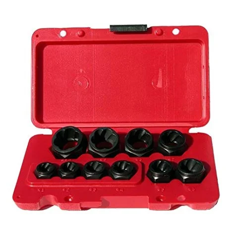

If you can get a replacement bolt, try one of these on it with a ratchet or breaker bar. I’ve had success with stuck/stripped bolts many times with these over the years. These are called Crastman Bolt Out. Several other companies make a version too.
Reactions: Hog
