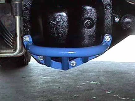

And my favorite (although not as popular with the TJ crowd as the CJ crowd):
http://www.fourxdoctor.com/catalog/diffguard/diffguards.html
You don't see as many "hockey mask" or "Hannibal Lecter" diff guards these days as in years past. Perhaps due to the current popularity of cast nodular iron covers. I like the hockey mask guards because they work in conjunction with the stock cover so no issues with fitment or where the fill hole is located.

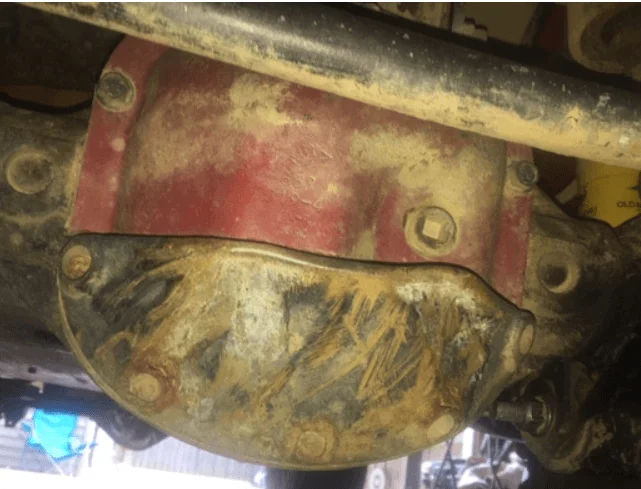

My current jeep came from the previous owner with Solid diff covers. The front cover doesn't interfere with my Currie Correctlync steering so I have no reason to change it. If I did I would most likely use a stock cover and one of Mike Duncan's (4xDoctor) hockey mask diff guards as I did on my CJ-7. I know the Barnett/Currie cover is bulletproof, but its expensive and fugly to boot.

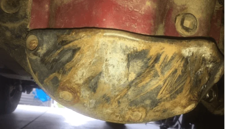

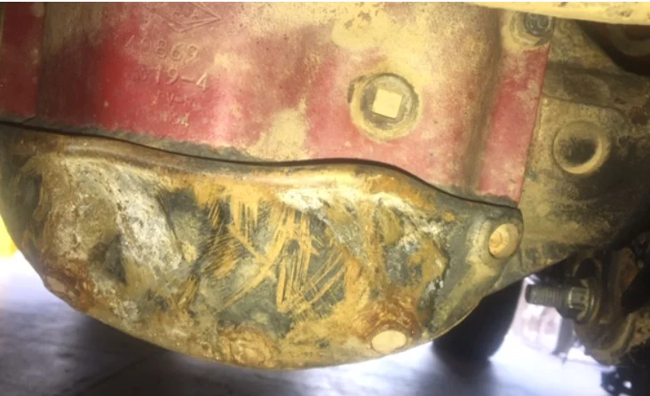

I went with Barnett in the Dana 30. Great TB clearance and protection where its need it but, on my case they get scratched a little.
The front its difficult do the TB clearance, if the axle make contact and slide is not bad, if the TB get stock and sudden release seem like the diff blew on pieces.
I will suggest not to go with the cast ones on the front.
** the scratches happen hitting a rock like a 5 times trying to climb a muddy hill like @3 mph.

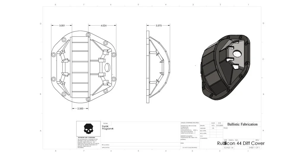

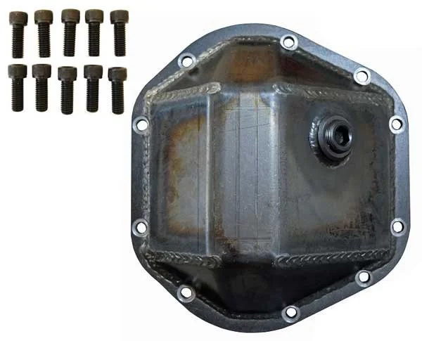

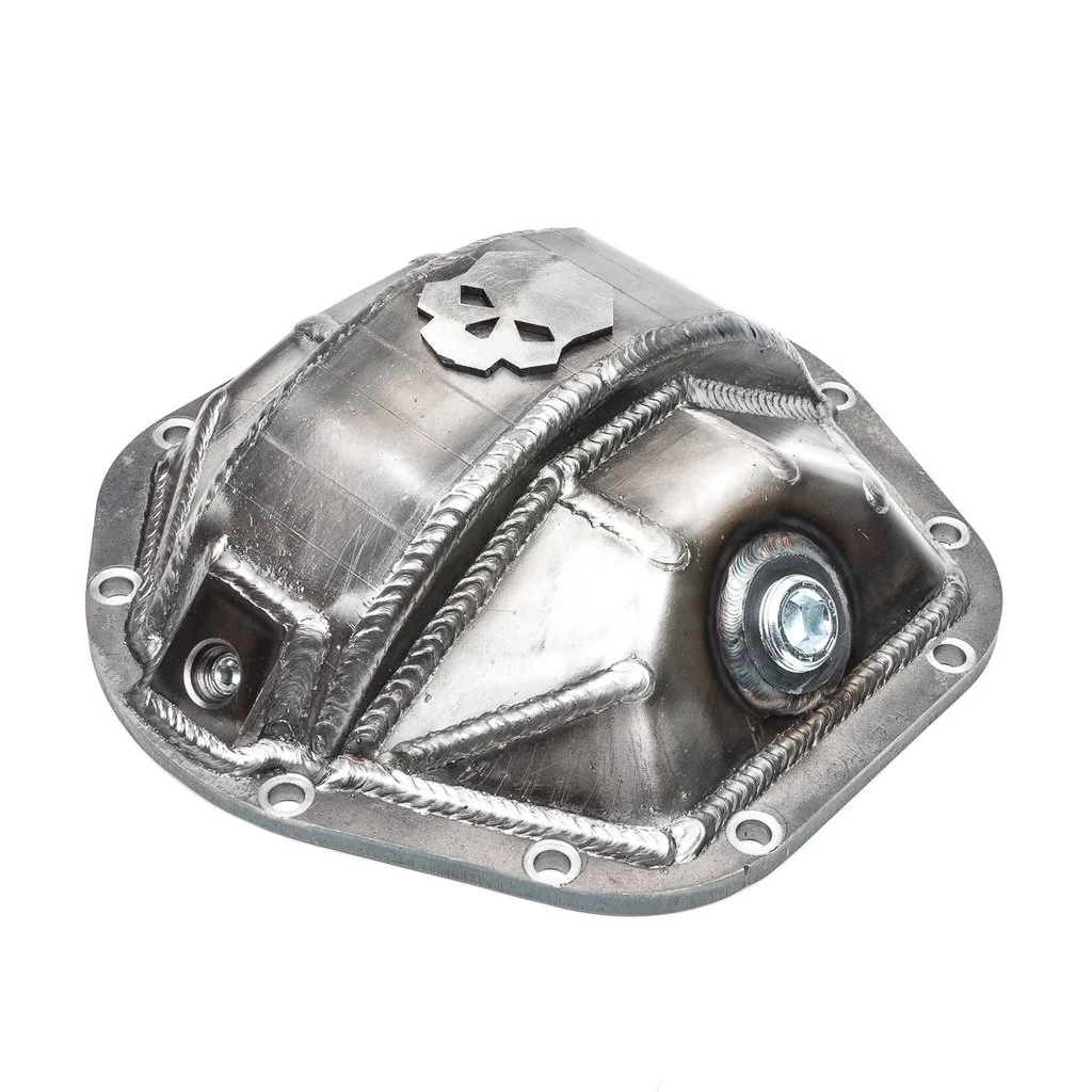

The biggest issue with stronger aftermarket covers on the TJ and even JK Dana 44 is that they create interference with the trackbar during articulation.
Ballistic fab builds a solution specificially for Rubicon TJ’s/LJ’s
A bit pricey for most people here.
https://www.ballisticfabrication.com/products/jeep-rubicon-dana-44-differential-cover
Where are you finding the diff cover shown in the illustration that fits a TJ/LJ Dana 44? The illustration specifically references the JK Dana 44 and the link is to a JK diff cover.
If you read the description of the part, it explains that it fits both the JK and TJ. I guess the question I would ask is will a TJ Dana 44 cover fit on a JK Dana 44?
That BF part number is the same as it was when it was built for the TJ/LJ Rubicon back in 2003.
I am guessing you are asking based on the 8.5 inch TJ Rubicon Dana 44 ring gear vs the JK 8.9 inch ring gear..?
Edit: I will find out for sure. Maybe I can get a more clear/high res measurement drawing added to the website.
Reactions: Mr. Bills

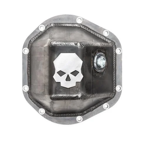

Actually, I am asking because the product linked indicates that it fits the "JK" Dana 44, however when one searches the Ballistic Fab website by vehicle and enters "Wrangler Rubicon" there are two results, the part described as "Jeep JK Rubicon Dana 44 Differential Cover" (P/N DIF-2003-3) and another entirely different Dana 44 diff cover described simply as "Dana 44 Differential Cover" (P/N DIF-2003-2) pictured below.
https://www.ballisticfabrication.com/products/dana-44-differential-cover-welded
There is a use note for P/N DIF-2003-2 that reads:
"Differential covers are larger than the stock cover so please be sure to measure for clearance prior to ordering. For Jeep Rubicon TJ/LJ and JK applications, use DIF-2003-3 to clear trac bar and steering."
While this clarifies things a bit, your follow up with the manufacturer to confirm fitment with the TJ/LJ Rubicon Dana 44 would be helpful for anyone considering this option.
