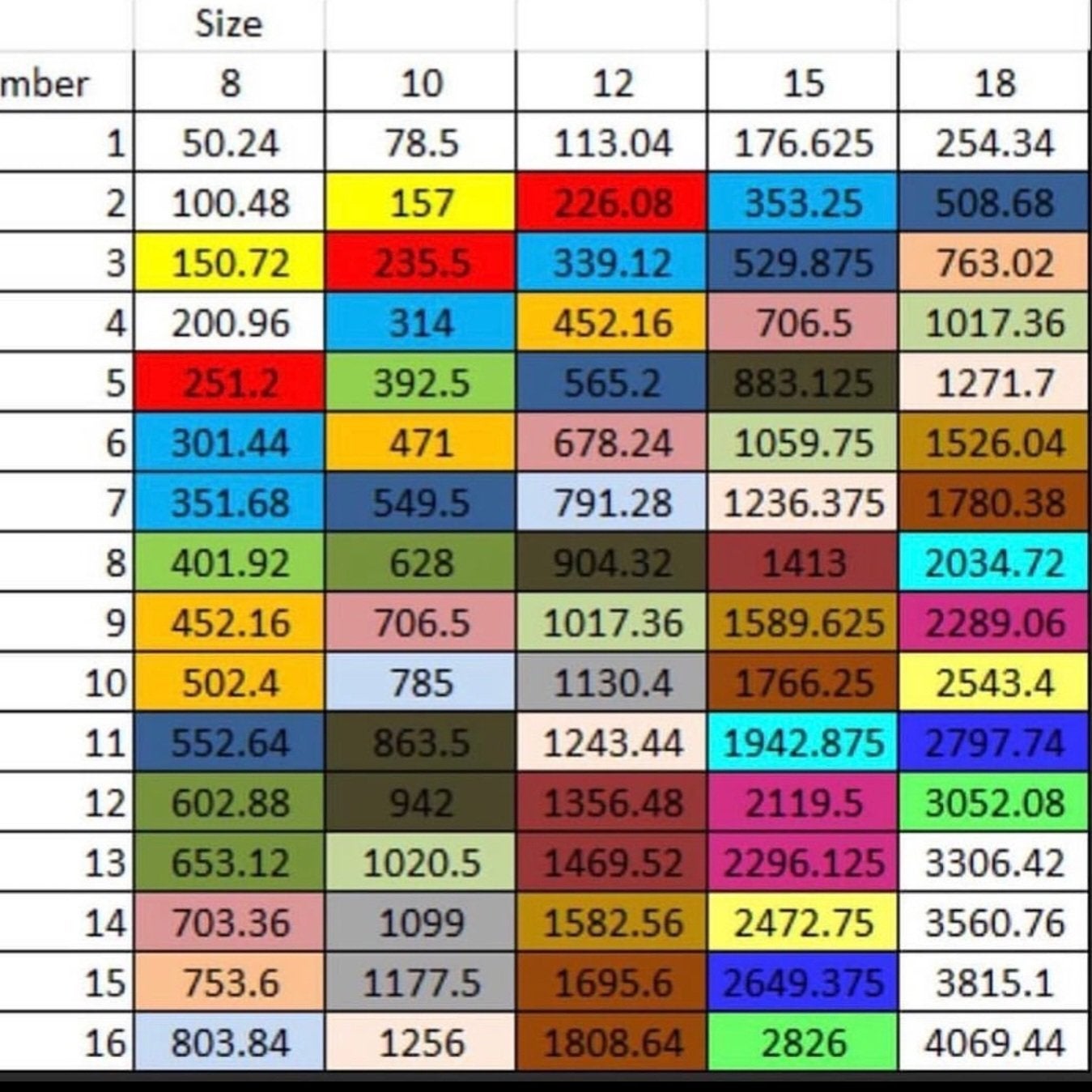

As chart I grabbed from diyadudio
Show total cone area of when using multiple of respective sub sizes.
