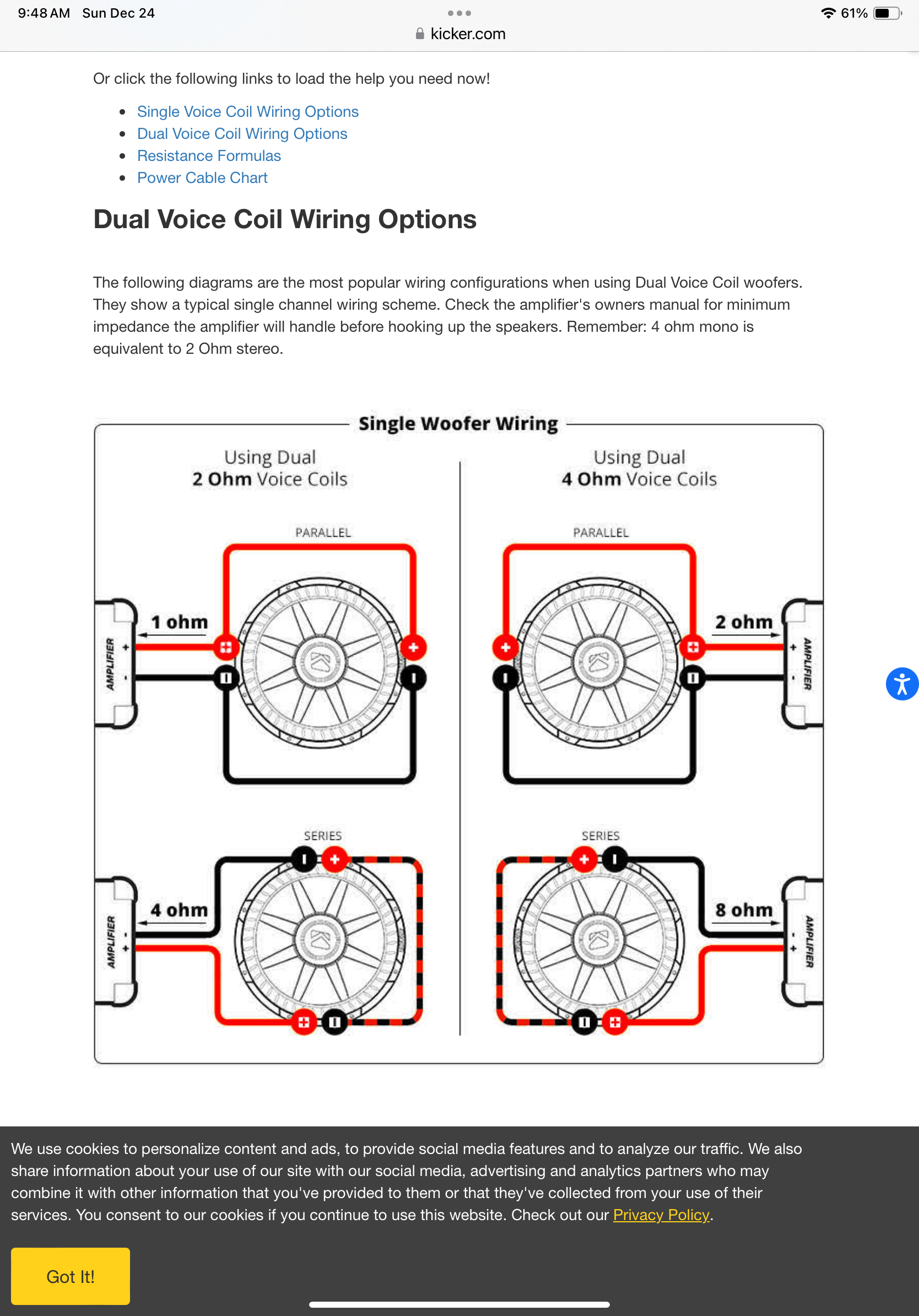

After reading many of the audio upgrade threads, I am finding that some of the mono block amp and sub upgrades are no longer sold or out of stock, so, at risk of beating a dead horse am hoping to get some thoughts on whether its wise or unwise to use a soundstream rsm1.2000d mono subwoofer amplifier to power one two or four ohm dual voice coil 6.75 kicker subwoofer in the center console. As I understand audio, this amp is overpowered as it puts out 480 watts at 2 ohms but the speaker handles 150 rms .. wondering if it is still OK to pair them up since I already have the amp. Thinking it will be OK as long as the volume isn’t cranked to blow the subwoofer.
