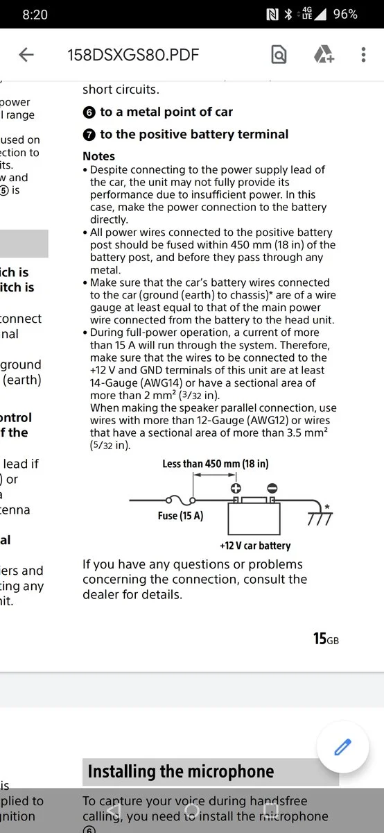

Also, you must note, since there is a class D receiver built inside the head unit, my assumption is in order to max the power out you will need to run the power straight to the battery. You may want to test, at first, with the power supplied by the harness, and if you feel it's not loud enough you should power the head unit directly to the battery.
https://www.crutchfield.com/p_158DSXGS80/Sony-DSX-GS80.html
This is from the operating manual. Ask questions if you do not understand.
Yes crutchfield says to run direct wire to the battery and has a harness fot about $6
Hit up Crutchfield through their online chat, tell them you want that DSX model, and want to power it directly to your battery, so what power and ground wires should I buy, and also what fuse. You will need a 15 amp fuse, and I would recommend this kit, simple, inexpensive, and more than you need. The only other item would be the 15 amp fuse. Go for a 10 gauge wiring kit, 12 gauge is okay, and 8 gauge is overkill.
https://www.crutchfield.com/p_142PA10BX/EFX-PA10BX-Wiring-Kit.html
