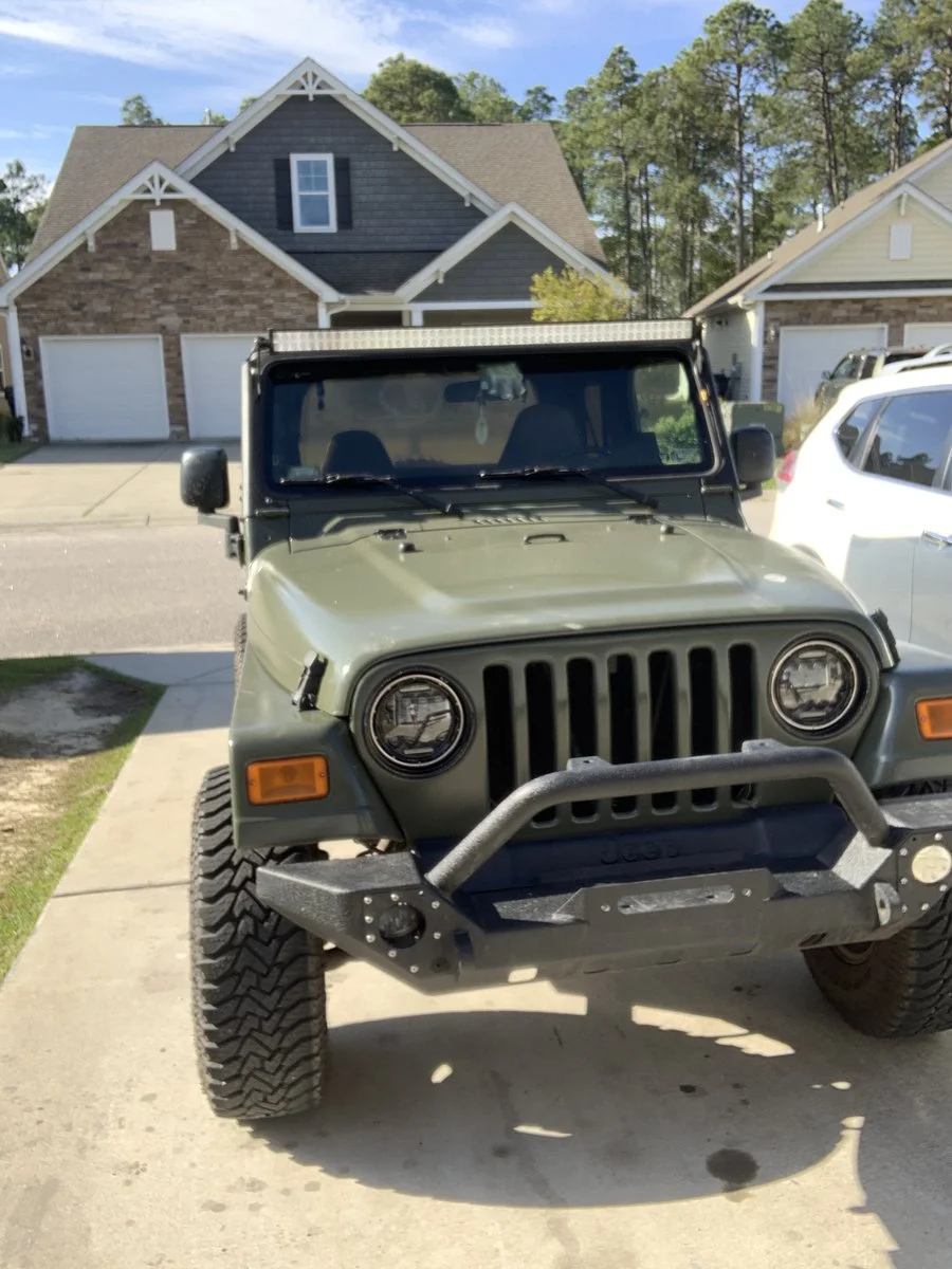

Here is my 01 TJ:
as of right now it has a 2 inch suspension lift on 31s. The suspension lift is from rough country (I know it’s cheap but i don’t care.) I do mild trails with the boys on the weekends. The suspension lift is shocks and spacers for the coil springs.
So here’s the deal. I was wondering if I could order new 1 inch springs, reuse the coil spacers, and add an inch of lift. The bump stops are already adjusted way too far, and i hear the rear hitting them from time to time. I have a crossmember drop just in case I get driveshaft vibrations. I was gonna go for a body lift but I can’t because... we’ll here:
and no I’m not selling the Jeep and getting a new one. I’m leaving for the navy in 6 months so there’s no point. I beat the living hell out of this thing every weekend... and I mean I beat it bad. But the trails I go on are mild. They’re actually technically not even trails. They’re for construction workers.
anyway, I tried contacting rough country but they seemed closed due to Coronavirus. so basically back to my question: can I add 1 inch lift springs, reuse the coil spacers, and not have to get new shocks? Do your thing forum. I’m also on a budget because I’m in high school 😐 so don’t think I have 10s of thousands of dollars to throw at this thing.

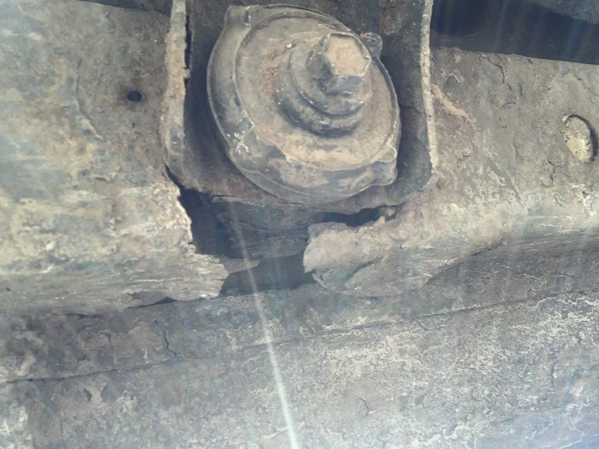

I think you should probably take care of that rusted out torque box first. There are several weld on kits, such as the ones from Safe-T-Cap that fit right over that and simply get welded in place.
If you have access to a welder or know someone who can weld, it shouldn't be terribly expensive. Even if you have a shop do it, it shouldn't be astronomical.
Check for any other areas that may be rusted through as well, particularly on the frame. You may want to take a hammer and bang on any soft looking spots to check.
those body mount rails/boxes are replaceable.
Have already done that Chief. The frame is in decent shape now. It’s mostly the body. I could care less about it now since I’m leaving for the navy soon anyway. She’s in the south now so it won’t be as bad for it since I drilled drain holes into the frame.

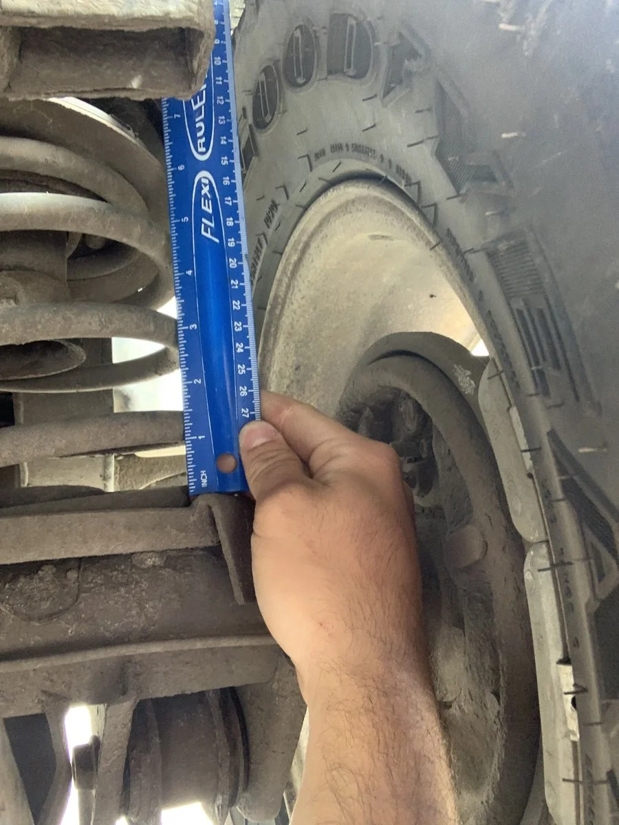

your missing all your jounces too. they would make it a softer hit. when/if you did bottom out. somthing is odd appearing in the rear. those springs look shot to me. measure your space pad to pad for springs front n back. over 12 up front is lifted amount. over 8 in the back.
the way the rear appears is if you had jounces they be hitting already and that's not right, something appears off.
here is the rear I measured the front and it looked okay. The rear does seem off after you said it should be around 8
Here is the rear... the front looked okay
rear looks a little saggy. no odd extra weight in the ass end right now? do you keep it loaded? is the jeep extra heavy right now so it might not hold up to what it should?
if not, it probably needs replaced. kinda hard to accurately read the top end but looks like a stock spring would net you an inch or so back there.
you got pucks on front and back or just front?
Nothing but the spare tire, the rear seat, and my jack and torque bar to replace a tire. When you say “it” needs replaced to do you mean the springs?
ya, factory spring should hold the rear with about 8" of spring height, then pucks would extent that height and be considered lift.
fronts ok, means spring holds 12" and the puck is +2"?
Ah okay. So back to my main question then, do you think 1” lift coil springs would work? I just wanted to get some extra lift out of my tj. Thanks for all of your help by the way.
a +1" would restore what should be there +1", so it could equate to more, from a where it is now standpoint. a +1" would appear to add about 2" since your springs sagged 1.
