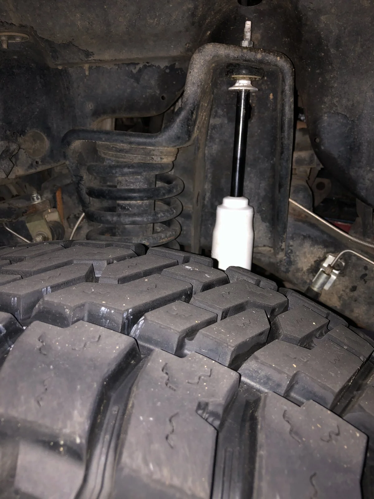

Update: I installed the the new Rancho Shocks and the jeep definitely rides much better (My old fronts were absolutely shot). But once I got done I realized the the shocks I purchased seemed to have a longer body and this made me wonder About the affect on my travel and if maybe I was sent the wrong shocks or Ranchos are just longer than the procomps I took off.
Ranchos tend to run a bit long. Use 0-2" lift shocks for 2-2 1/2" lift. You don't list having a lift installed, so they are the ones. Measure your old shocks full compressed and full extension and compare to Rancho shocks. What are the numbers? Also it is possible your old shocks might be wrong.
Measure front and rear spring length installed
Should be 12 up front, 8 in the back.
