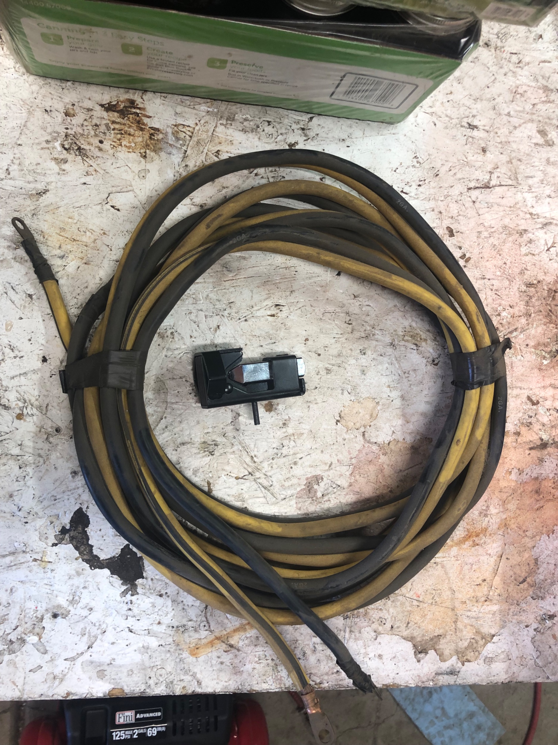

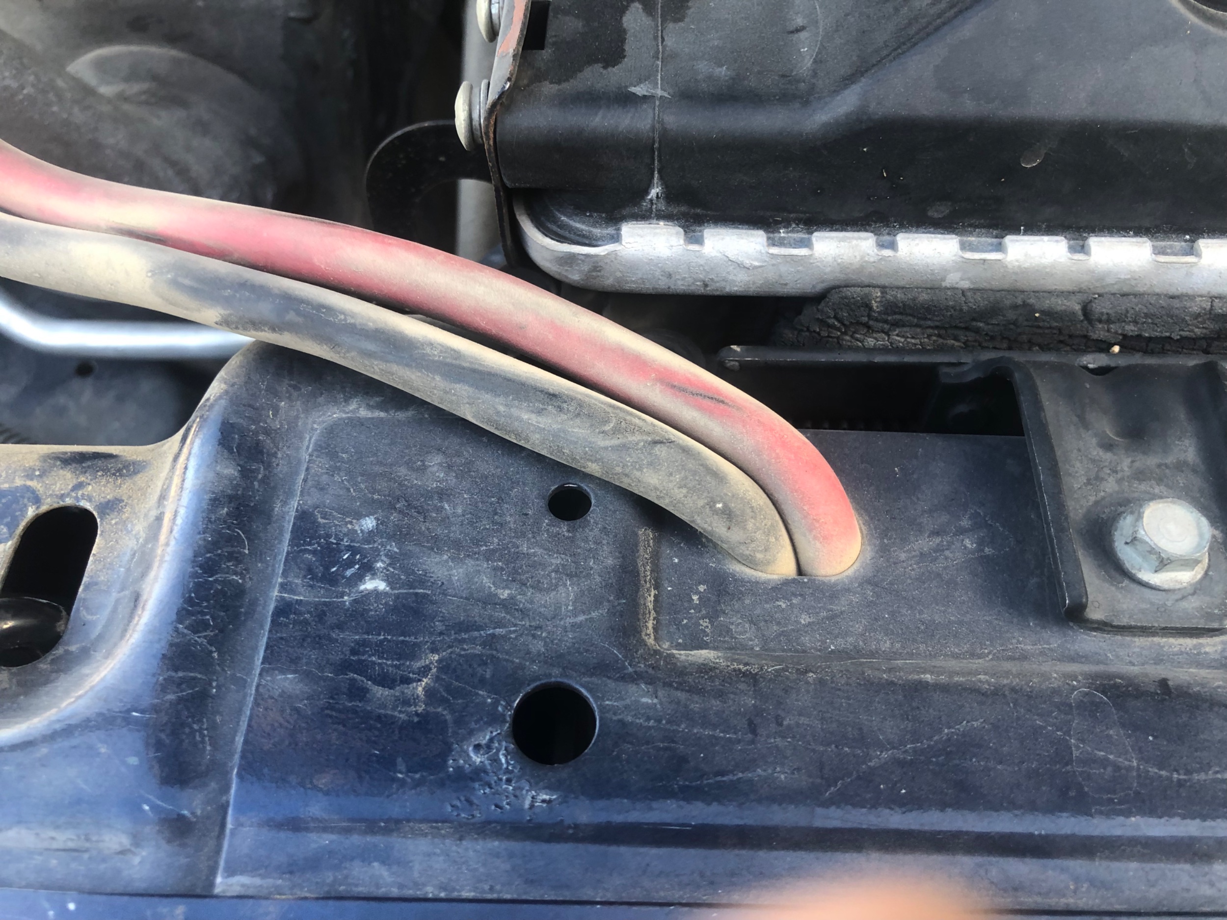

I need to remove my bumper to paint it and I don’t think my after market bumper will interfere. I saw a previous post where Mr Blain suggested using threaded rod to pull the pieces together. What other tips do you have? I know the SwayLoc is pricy but who tends to have it at the lowest price? Also while I have the bumper off I’m going to reroute the winch wires. The PO have them going through a factory hole and it’s too small with no grommet and I’m afraid they’ll wear through and short out. How did you route yours?

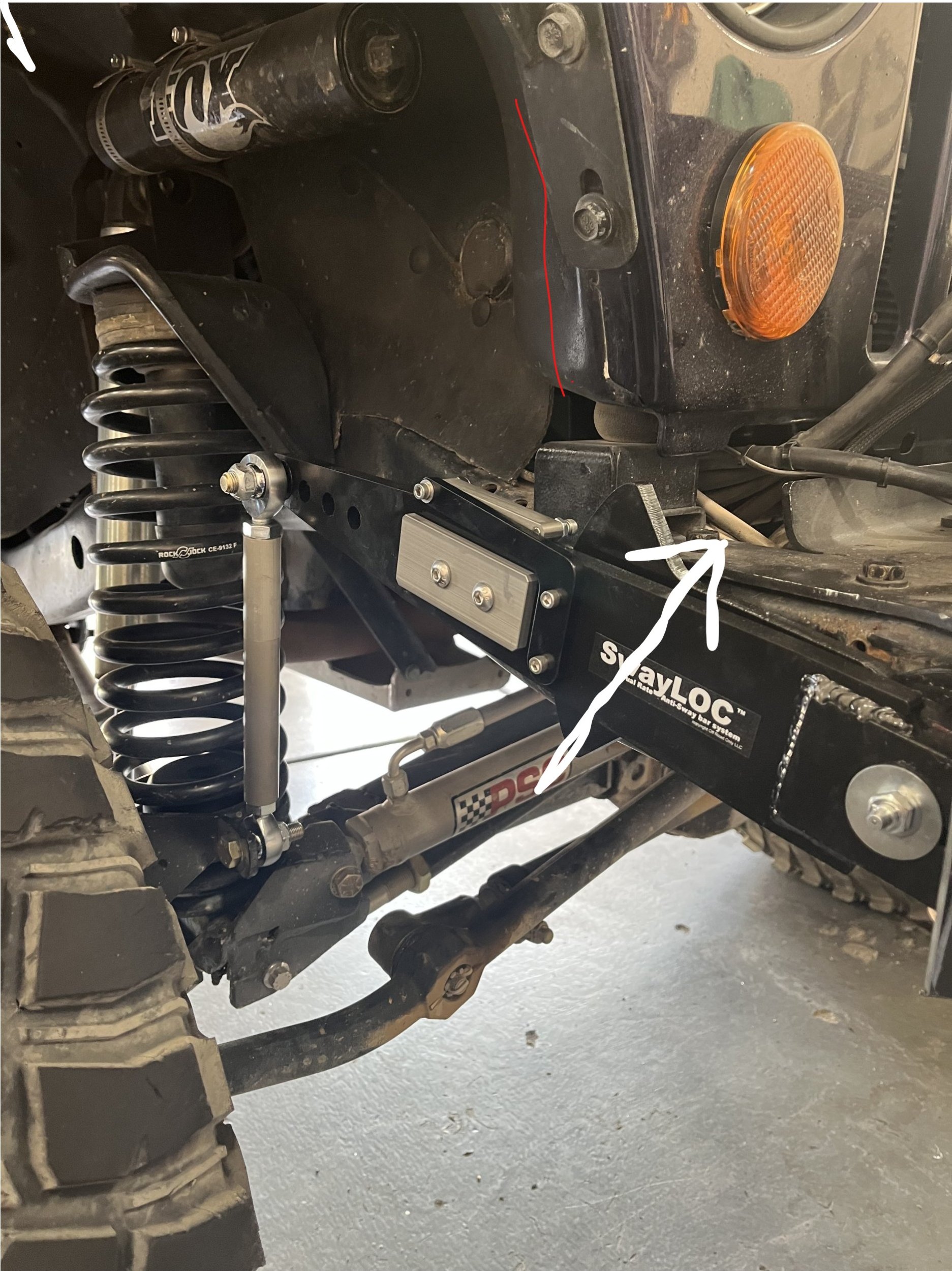

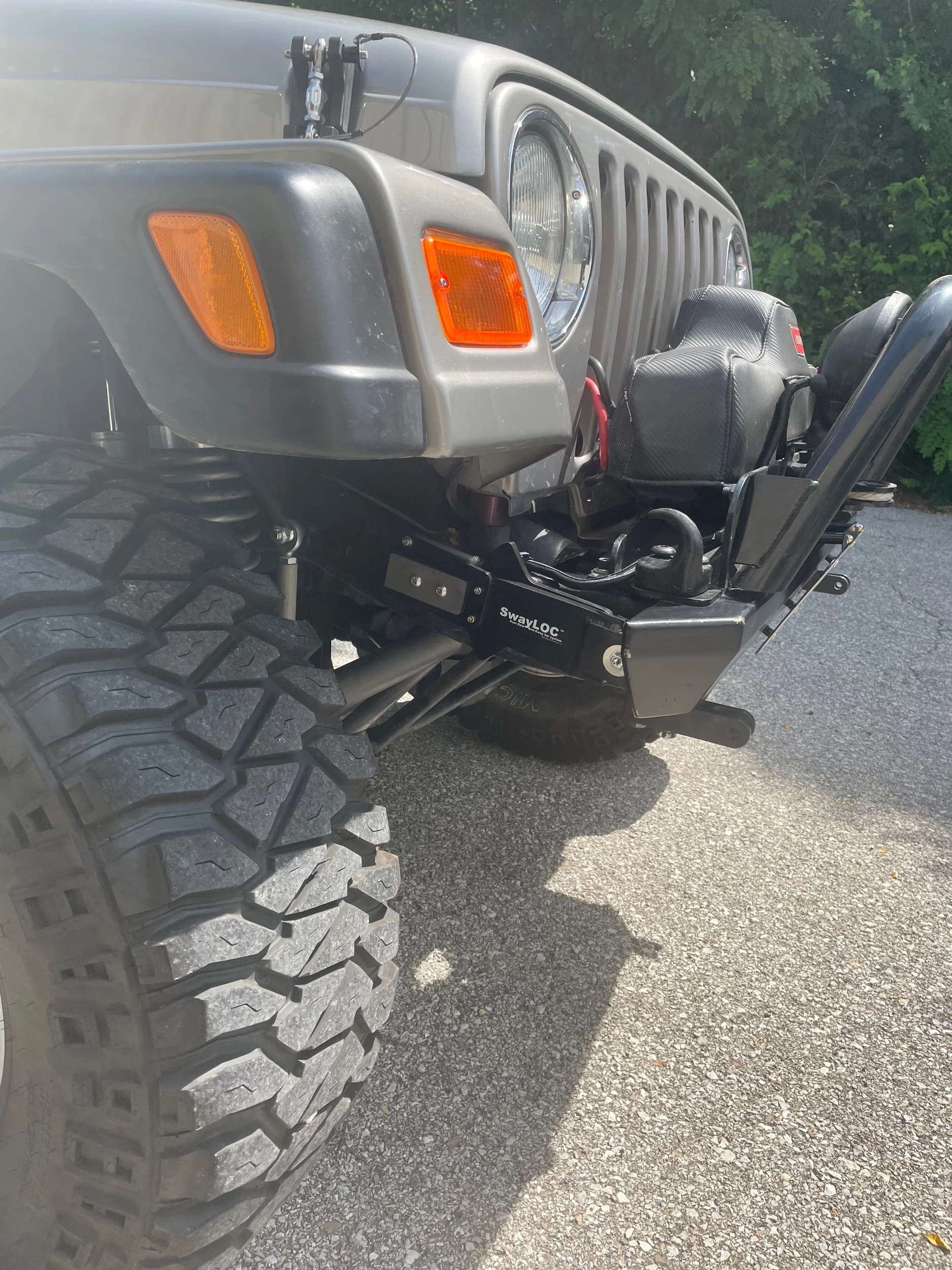

I added a SwayLoc about 3 years ago; one of the best things I've done to the TJ - I think you're going to be pleased. Installation was pretty easy. I personally didn't need anything special to get it through the crossmember or pull the pieces together; used a rubber mallet to tap it through and everything mated up nicely. I drive my TJ roughly 5k miles/year and I've greased it once or twice just as a precaution, but haven't needed to do anything else. Can't help with the winch wiring as that didn't apply to me. I've got an OEM front bumper and had to notch it a touch to clearance the arms. Install info here: https://wranglertjforum.com/threads/evolution-of-davecs-2006-se-4-0.18341/post-1451202

I love mine,we couldn’t have had the tent and rack on without it,the thing is more solid than the factory bar.i adapted curry flat tow points on mine.i caught quadratec with a false low low price,told everyone on here and a lot of members got a killer deal on a back order.

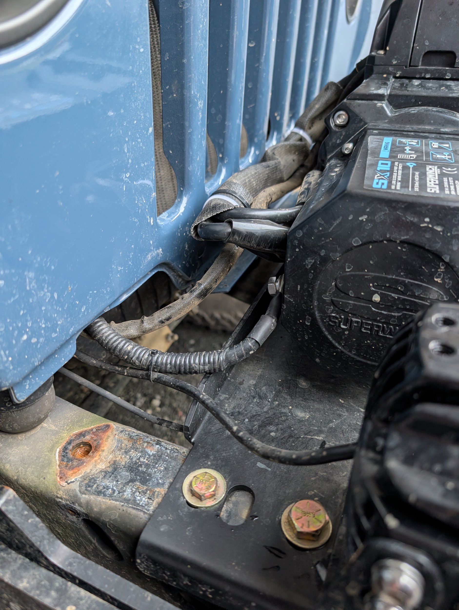

I have a body lift and went under the grille with my wires.

That’s great!I have a b/l too but I had to do a warn raised plate so I would have a flat front surface to mount in all the flat tow stuff.i don’t like that it really covers the airflow little.but I also wanted the bar that mount to it,so im living with it.

as far as winch wiring, I just went under the grille panel.
