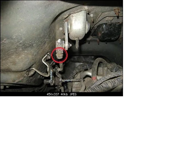

Odds are good the tcase shifter linkage is just out of adjustment now after the 1" tcase drop. Once the skidplate is off, you just need a 1/2" wrench to loosen the linkage's set bolt that holds it in adjustment and readjust it a bit. It's trial-and-error but you shouldn't need to adjust it much. The adjustment only consists of moving the shifter rod in or out of the bracket the set bolt holds it in position in.
The set bolt that holds the shift rod in position is circled in red in this photo...
