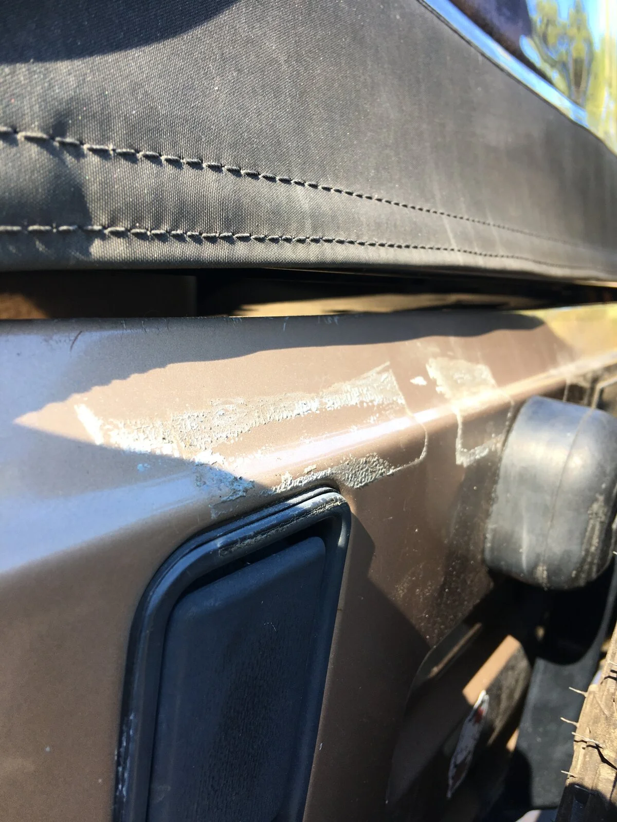

thekidwithquestions Acquiring Jeep funds... Original poster Supporting Member Joined Feb 25, 2021 Messages 1,513 Location NC, Wake Forest Oct 25, 2021 #1 so have a gap between my rear window on my soft top and my tailgate, water keeps getting in, How do I fix this? ignore the duct tape remnants before anyone asks, yes the Hello Kitty sticker is from @mrblaine

K Kid Mechanic TJ Enthusiast Joined Feb 15, 2021 Messages 749 Location Golden, Kalifornia-Lite Oct 25, 2021 #2 Do you have the bar that slides onto the bottom of the window? It has a seal that gaps the door. Why hide the Kitty sticker? It’s from @mrblaine, loud and proud, boy, loud and proud! Reactions: thekidwithquestions

thekidwithquestions Acquiring Jeep funds... Original poster Supporting Member Joined Feb 25, 2021 Messages 1,513 Location NC, Wake Forest Oct 25, 2021 #3 Kid Mechanic said: Do you have the bar that slides onto the bottom of the window? It has a seal that gaps the door. Click to expand... yup

mrblaine Crew Member Supporting Member Joined Nov 20, 2015 Messages 33,682 Location Quail Valley, CA Oct 25, 2021 #6 thekidwithquestions said: Anyone else? Click to expand... If you have a tail gate bar, it is upside down or the wrong one. Reactions: thekidwithquestions

thekidwithquestions Acquiring Jeep funds... Original poster Supporting Member Joined Feb 25, 2021 Messages 1,513 Location NC, Wake Forest Oct 25, 2021 #7 mrblaine said: If you have a tail gate bar, it is upside down or the wrong one. Click to expand... I'll go check

thekidwithquestions Acquiring Jeep funds... Original poster Supporting Member Joined Feb 25, 2021 Messages 1,513 Location NC, Wake Forest Oct 25, 2021 #8 mrblaine said: If you have a tail gate bar, it is upside down or the wrong one. Click to expand... It was upside down, thanks @mrblaine Reactions: pc1p
