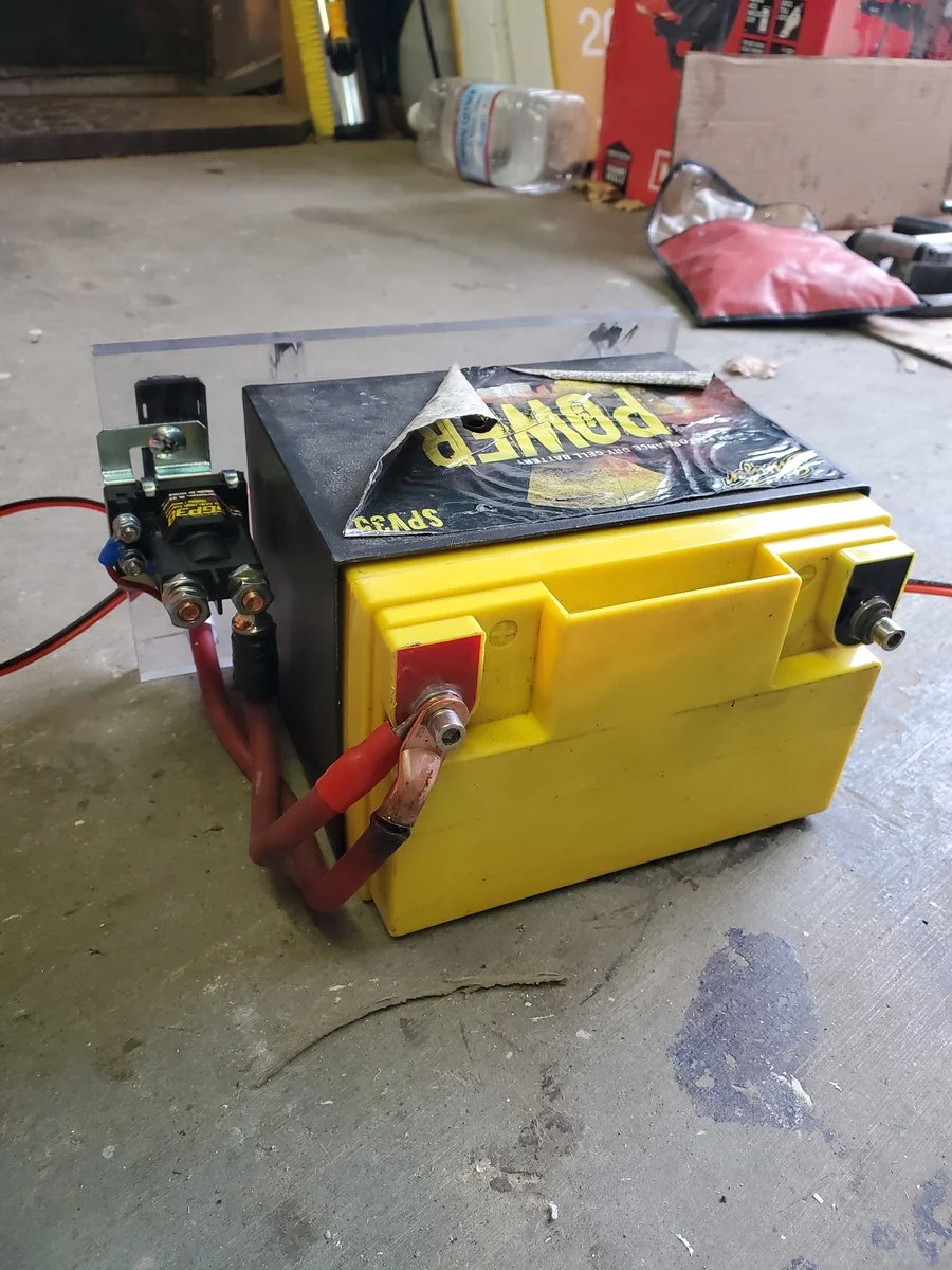

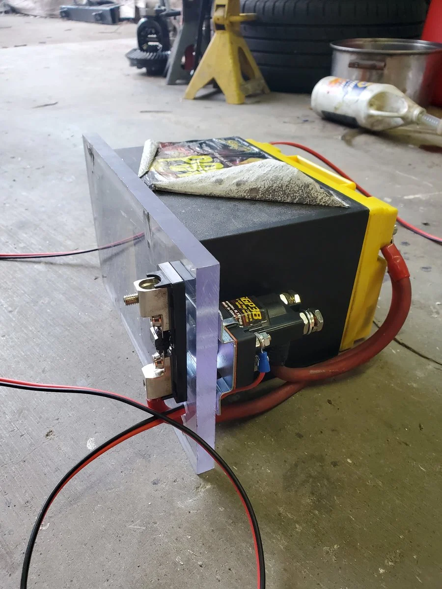

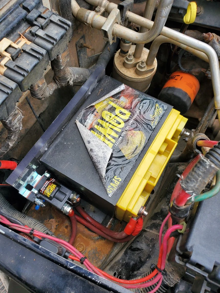

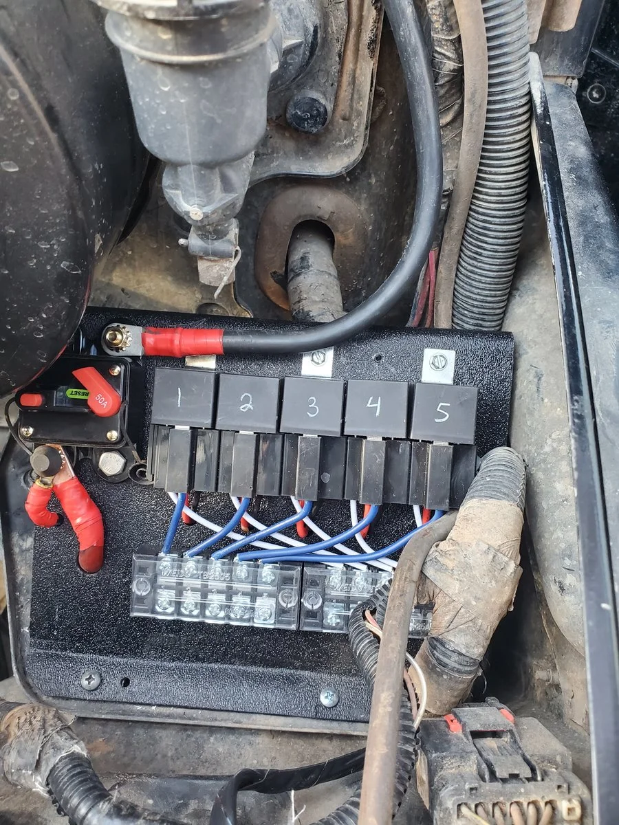

dual battery with independent accessory fuse / relay box

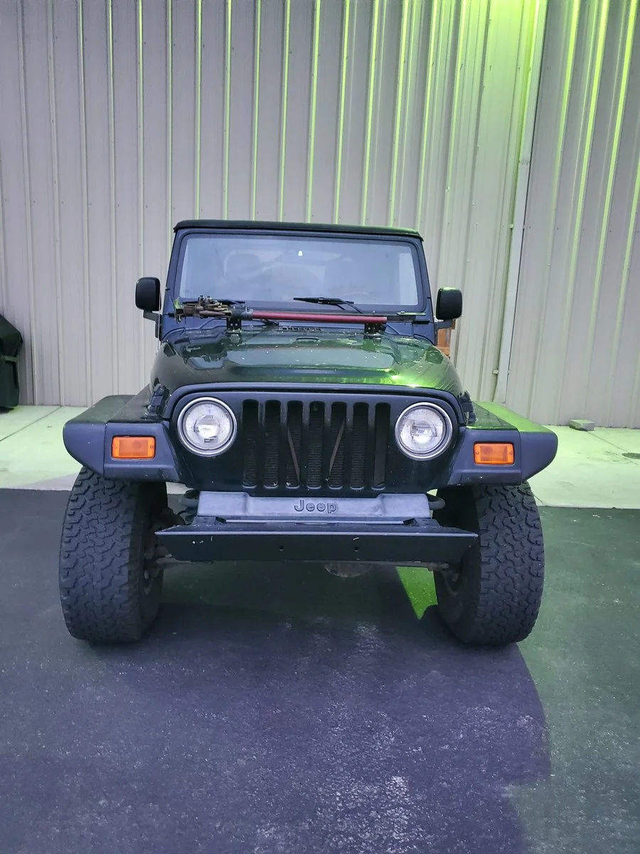

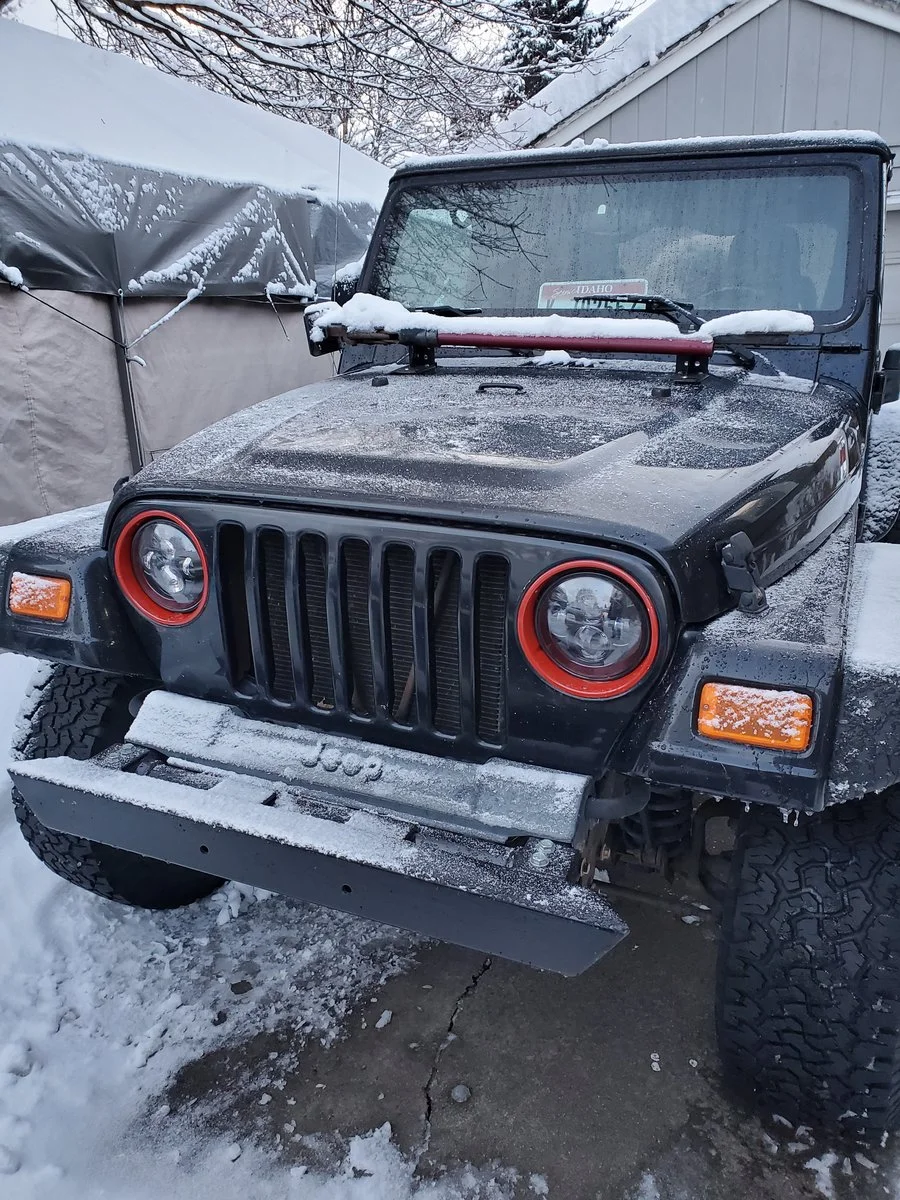

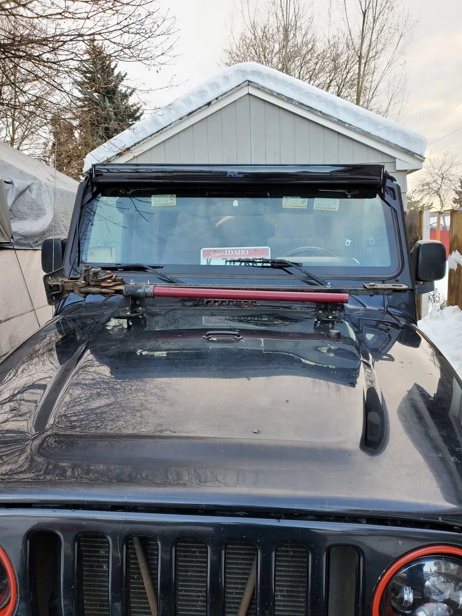

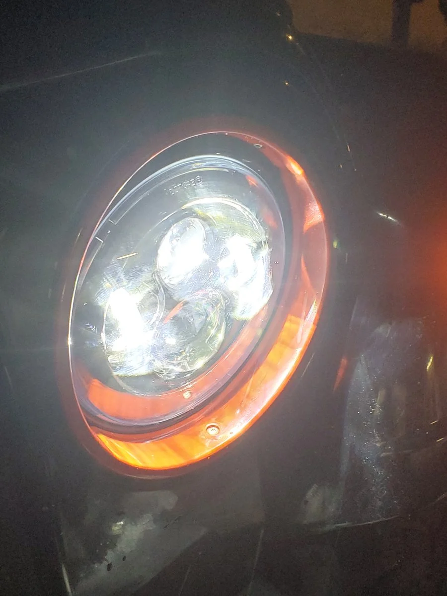

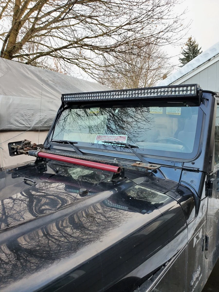

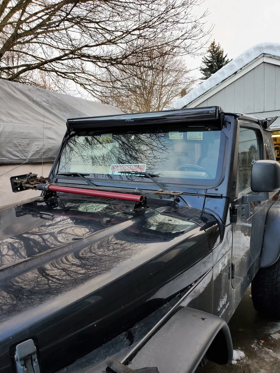

Light bar and LED lights installed.. Much needed upgrade from the factory lanterns that are said to be headlights..
for the

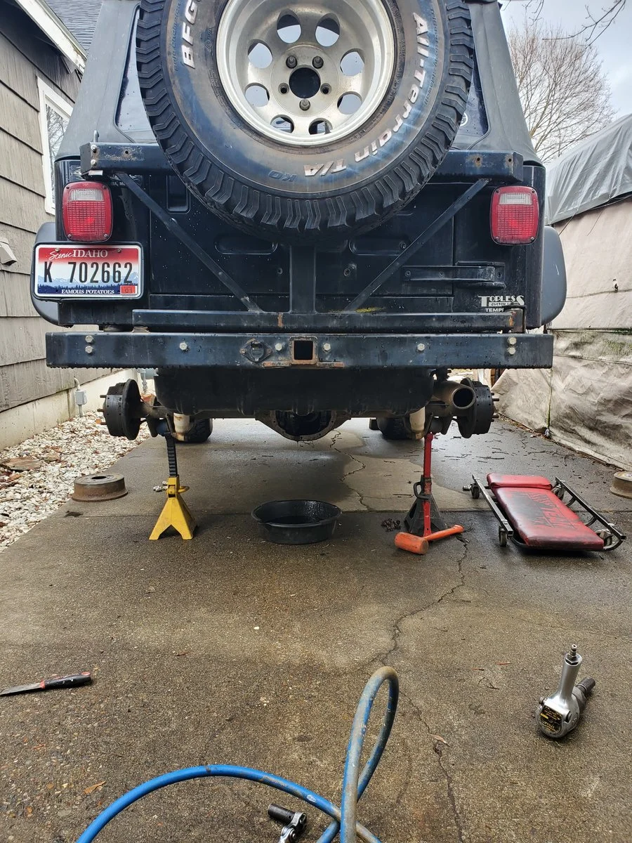

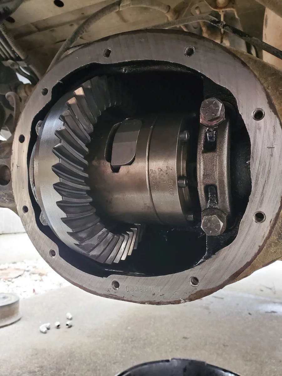

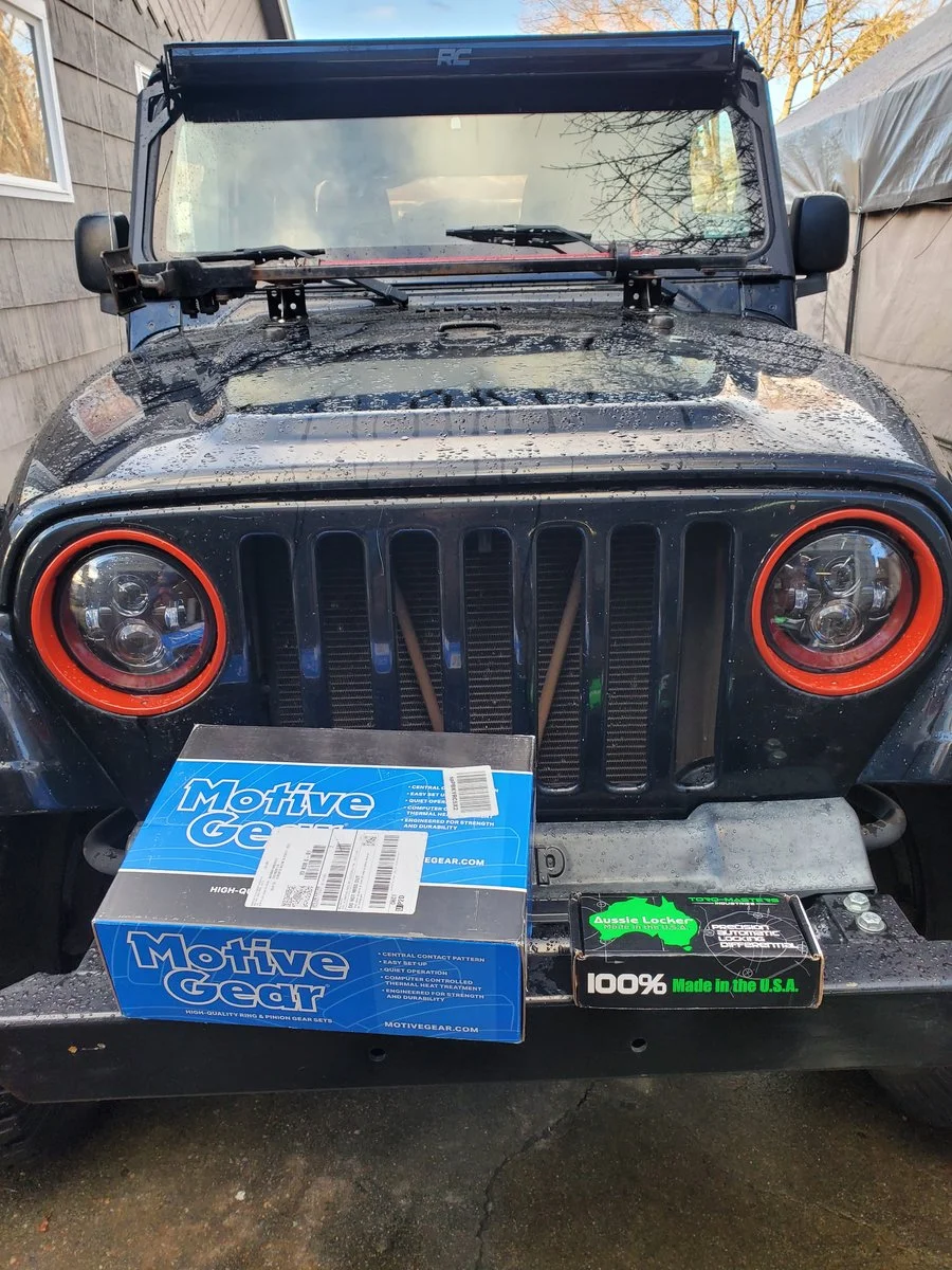

The front and rear lockers, 4.56 gears and chromoly shafts go in!!

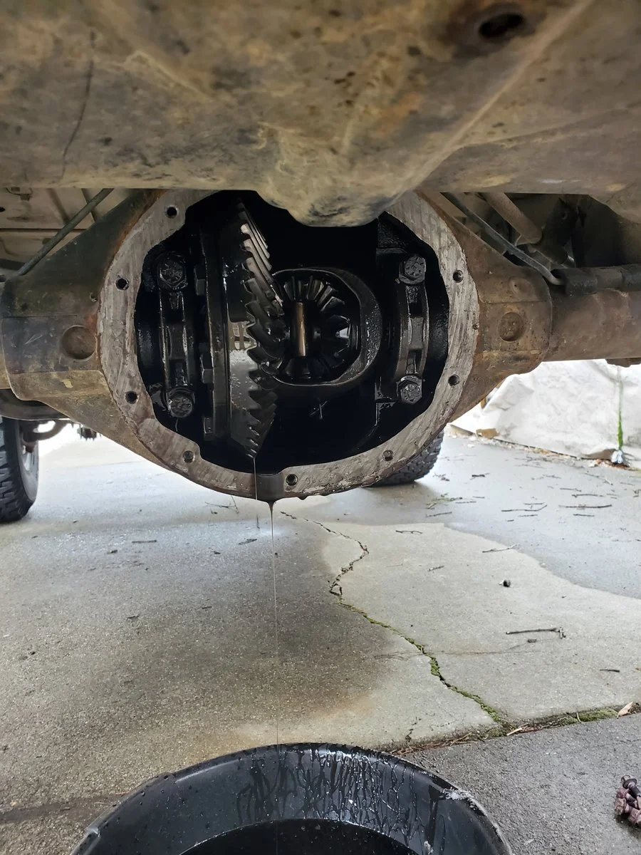

As much I want to say this was easy and a success, I am letting you all know a few areas where I should have done some comparing before moving forward on installing components. The rear went very smooth. Pulled the existing axles and open diff out easily without any concerns.. even the pinion gear removed easily (that should have been my first clue that things were going too smoothly). The rear was swapped with the Detroit automatic locker, 4.56 R &P and chromoly shafts. Put it all back together, new fluids and a quick trip around the block before jumping on the front. I do have to say, it will take some getting used to with the sounds and feeling of the auto locker on the back. Much noisier than I thought and the "lash" will likely be the biggest thing to get used to. They say the noise and slack is completely normal, does anyone else have experience with that locker that wants to give some input?

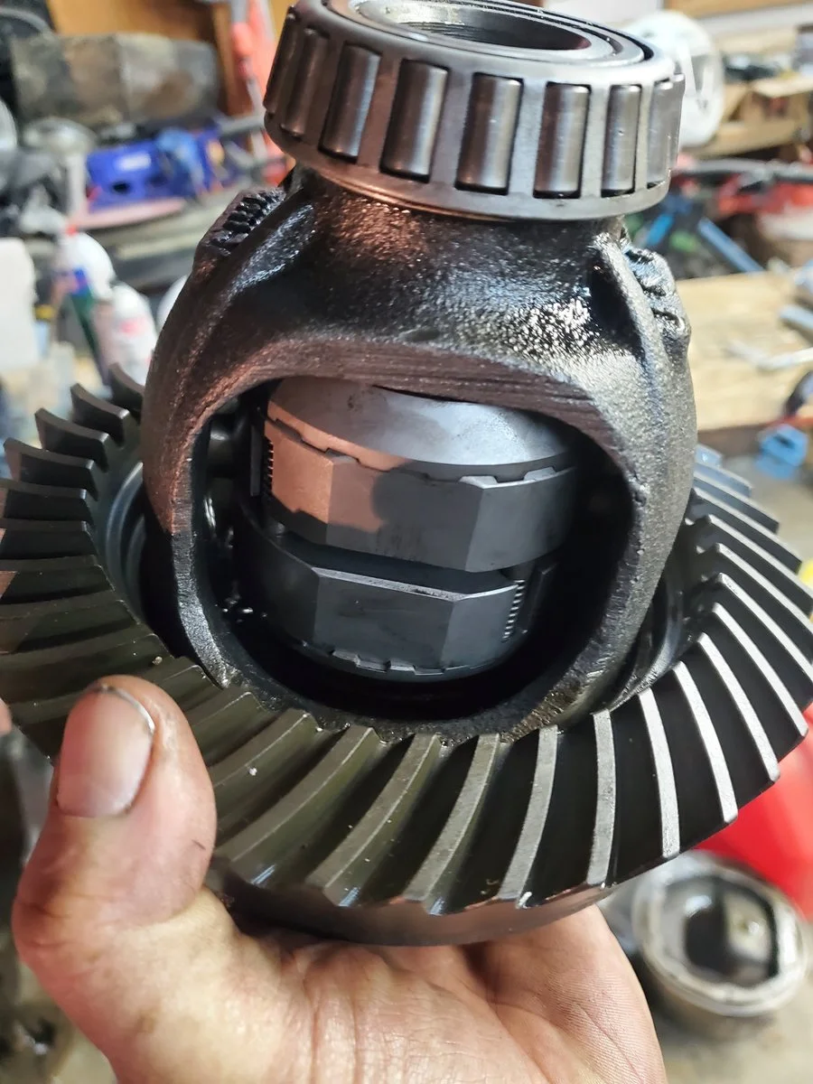

I move on to the front.. take everything apart just as any tutorial or instructions would have you do, I ended up separating the front passenger hub assembly apart (not on purpose) just to get it off (it would not come off easily and fought me the entire way). Once that was over, both axles pulled out and i could remove the R & P / front diff. Breaking my 1 1/8" socket trying to break free the pinion nut brought me to the parts store for another. The old Craftman's socket finally met its match. Nut 1 - Socket 0.. Now this may not be the right way to do things, but it worked.. I ended up cutting a small piece of wood shim and placing it in a soft rag, fed it into the gears as to create a way to stop the turning of the pinion gear so I could get some real torque on the stubborn nut. Finally.. I got the SOB!

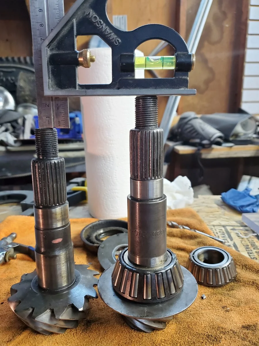

Things progress as normal.. I take off the ring, install the Aussie locker then install the new 4.56 ring. During this time i have the bearing that goes on the pinion shaft in the oven.. heating up to slip on (old trick I learned when rebuilding dirtbike engines). This is where I should have been comparing the old with the new. I never set the 2 shafts side by side, highly recommend to do that for those that buy parts online. I am ready for the installation now and for those that know, the pinion shaft is the first thing to go back in. Well it is not fitting! It will not go in the bearing that is in the diff housing. The supplied shaft is 1" longer and different diameter. As one could imagine that created some issues as these machined parts need to be perfect!! I now have to wait for the replacement and hope it is correct. Made progress but not as much as I wanted.
