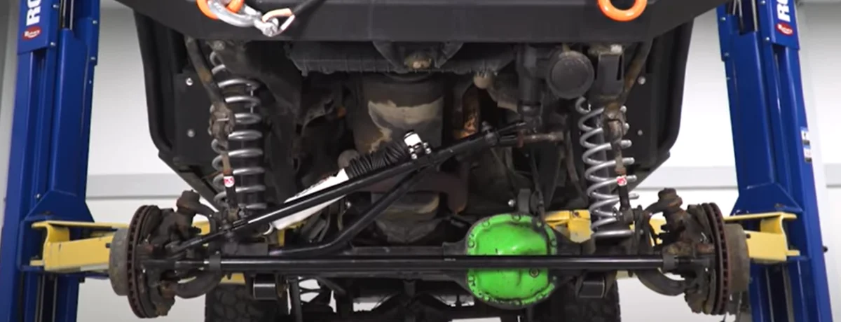

I was watching that dirt lifestyle guy build the "ultimate Dana 30" and he did the WJ upgrade. When he was done, his trackbar was about a foot shorter than his draglink. He said it would be fine, because the most important thing is that they're in the same plane. I don't think so...Pretty sure he's gonna have bumpsteer.

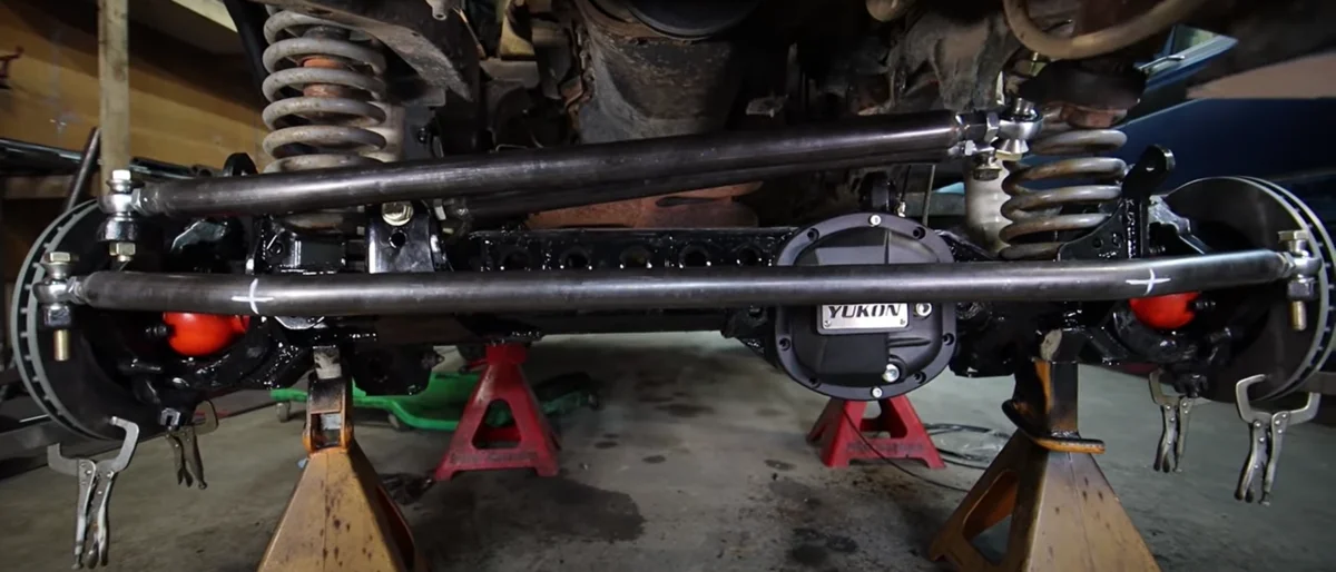

I also saw the rugged Ridge / Rusty's Off "heavy duty steering" Kit. Holy crap. They went from inverted Y to inverted T without doing anything to the trackbar. The trackbar and draglink not parallel or the same length! How can people install this and thing its an upgrade? Is their personal confirmation bias (I spent a lot of money on it so it must be good) that strong ? I would imagine this setup would bumpsteer AND have a pretty dead on center feel.
