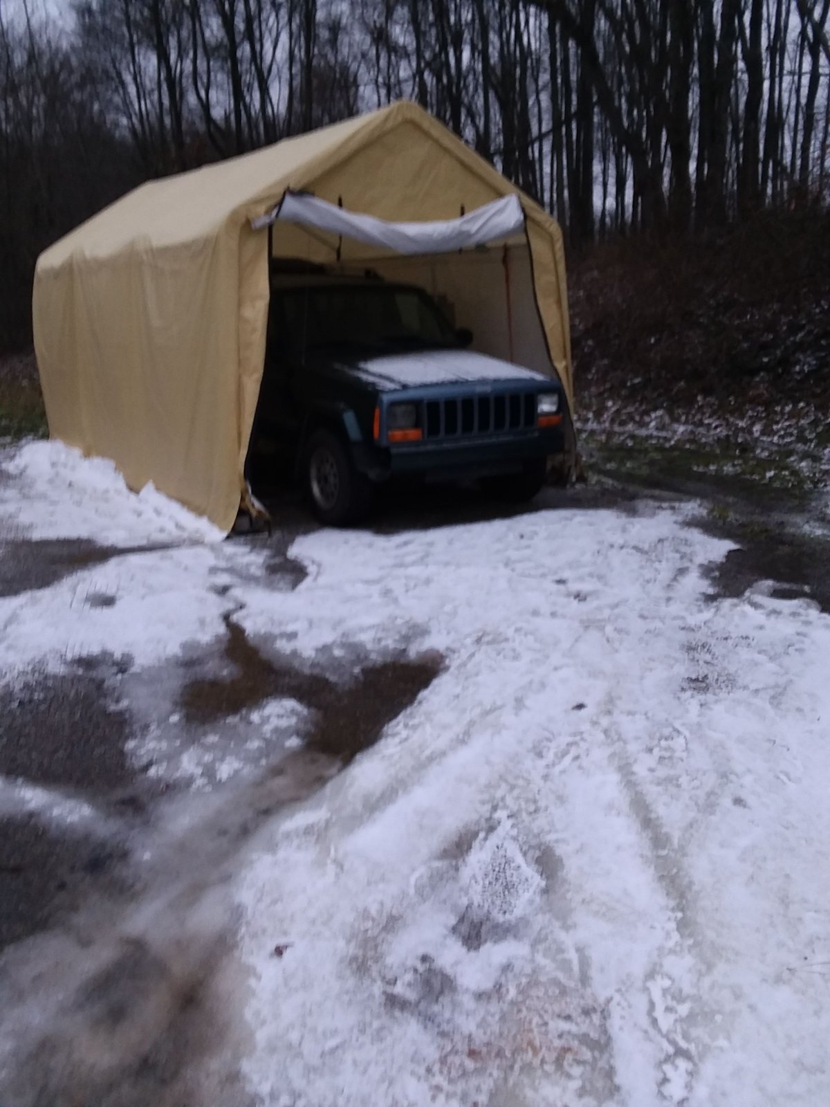

Well look who came out of hibernation. I been piecing it back together and replacing worn stuff little by little. It doesn't help that it's been freezing out but my kerosene heater in my closed car port allows me to get some things done.
So far I've replaced ball joints, steering, brake pads, rotors, calipers, front shocks, anti-freeze, thermostat, trans fluid, header panel, trans mount, and some other crap.
Wheels are pointing in at each other which makes for some funky driving manners, especially in snow but I'll fix that with an alignment soon.

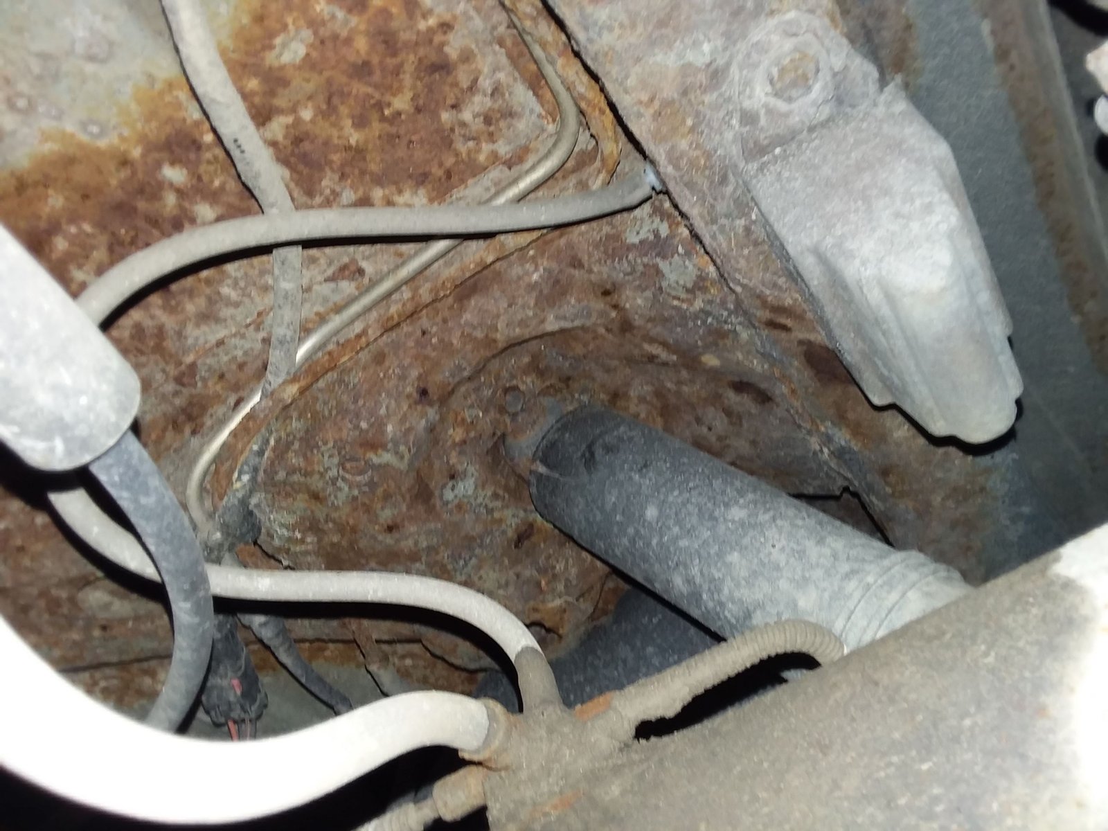

Oh man, those upper bolts won’t be fun.

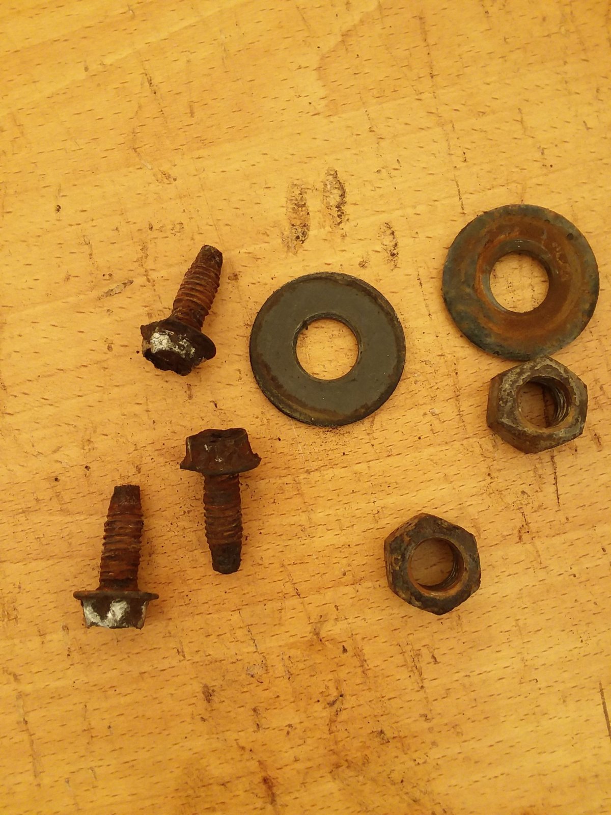

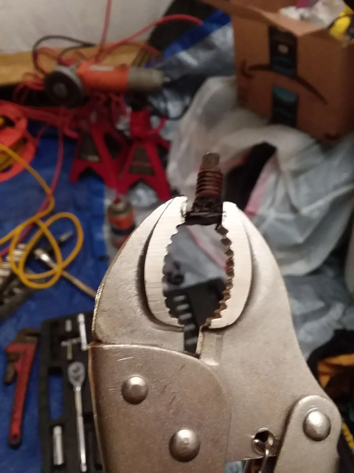

I must be good at this...
The 4th one is still up there with a rounded head. I am not giving up on it though. I need to shave it down a little so the next smaller size bolt remover socket fits over it and hopefully my impact cranks it out too.
Reactions: Mike_H and Chris
Wow! We’re those 3 hard to get out or not?
The bolt heads were flaking off so I could not fit a normal socket on them. I had to buy this:
https://www.amazon.com/dp/B0000CCXVZ/?tag=wranglerorg-20
It fits over the stripped or damaged head and locks on. I used it with a 1/2" extension and 1/2" to 3/8" adapter. I ran the impact gun real careful, forward and back, so I did not put too much force on them and they spun right out. The last one on the passenger side is in such an odd position that I cannot get an extension on it long enough to run the impact. The axle is in the way so I plan to droop the axle as far as possible and see what I can do. Otherwise I will have to drill the head off and punch the nut out.

And finally the 4th is free...sorta. I had to cut the shock rod, bar pin, and then the head of the bolt to remove the remaining piece of the bar pin so I could spray it with some of my trusty can of magical powers, which ran out on this last bolt. :oops: Once it broke loose then it was very easy to unscrew.
I'm relieved but still got a ton of work to do.
