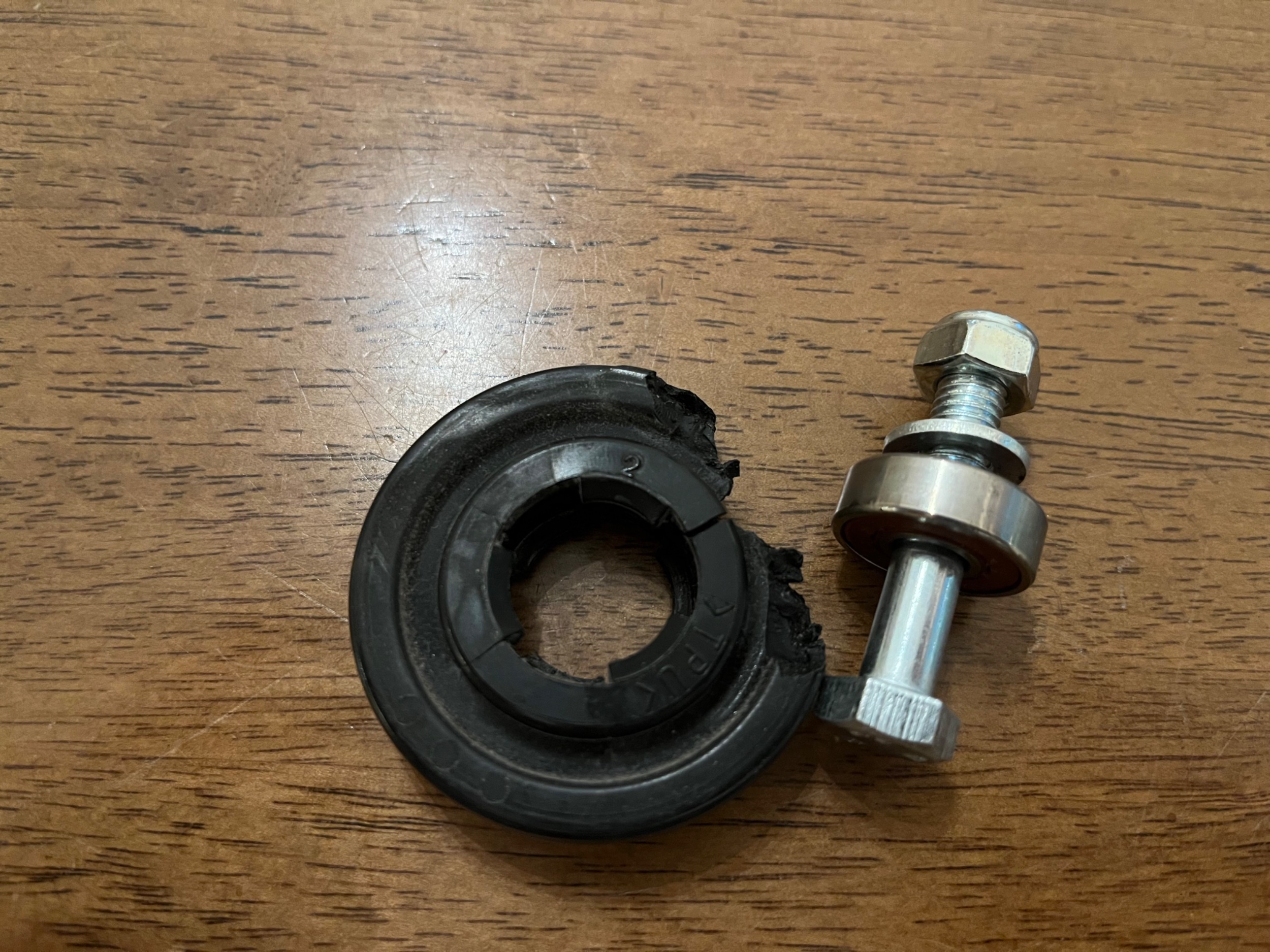

Welp … my 20 year old Asko dryer - which is otherwise going strong - needs a new drum roller. This one’s all chunked up. It’s 2” or 52.5mm in diameter, and the bearing OD is 22mm.
I can’t find a replacement! All the new stuff is 3” +/-
Anybody know of a good place for old parts like this? I want to keep this thing running and not have to buy a new POS.

Oddly, they don't have a parts link on their own web site. I found this with a Google search:
https://www.askoapplianceparts.com/asko-dryer-parts-s/139.htm
I usually go to the manufacturer's web site to get the part number and then Google that to find the best price. I've found eBay to usually be the best price for appliance parts, both new and used.
Thanks guys. We are finding the same results unfortunately.
eBay has some promising albeit expensive options but none that confirm the p/n or dimensions.

Have you checked with Dey Distributing ? They generally have a lot of decent parts.

I’ll check out Dey Distributors.
I don’t think I can fab a bracket for a 3” since they mount in the front frame … but that is good thinking! Let me think on that some more.
Thanks fellas!

Grainger for a chunk of nylon or other hard plastic and a hole saw?
