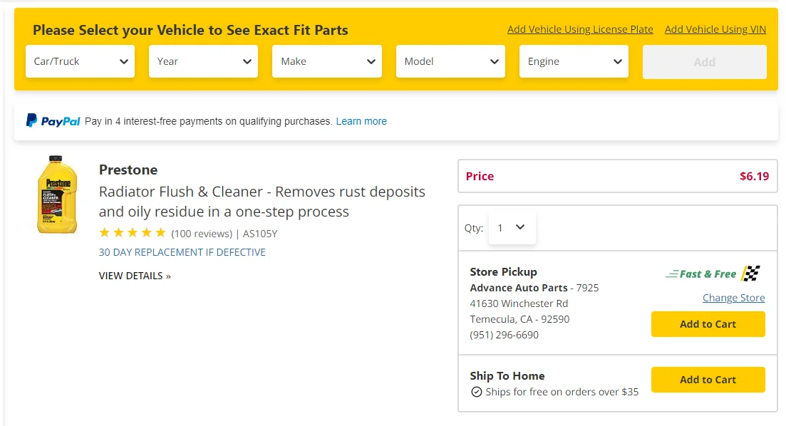

On a side note, several times people have mentioned running thermocure then Prestone “drive around flush” to clear out different crud (scaling instead of rust)… Call me dumb, but I don’t see one called that, could someone link it or post a pic of the bottle? Might do that while I’m at it, cuz why not.

I’m thinking it’s this one:

https://shop.advanceautoparts.com/p...s-as105y/11280027-P?searchTerm=prestone+flush

Bottom one.
Thank you! I’ll try to find that one, but it looks like it’s no longer in their catalog of products, don’t see it on their webpage anymore. That why I thought the first one was just the new re-labeled version.
They show it in stock locally.
