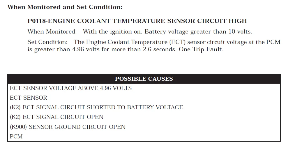

However, the OBD is showing a PO118 code. not sure what to do about that.

It sounds like you had two problems and fixed one of them:
  1. ECT voltage too high (P0118)
  2. Plugged heater core
Here's the description of the P0118 code from Jeep (caveat - this is from the 2005 Powertrain Diagnostic Procedures Manual, and the PCM is different from the one in your 1998, so it might not be correct):
You need to diagnose the possible causes above to find out why your ECT is sending more than 4.96V to the PCM. Whatever it is, that should solve your temp gauge issue.
