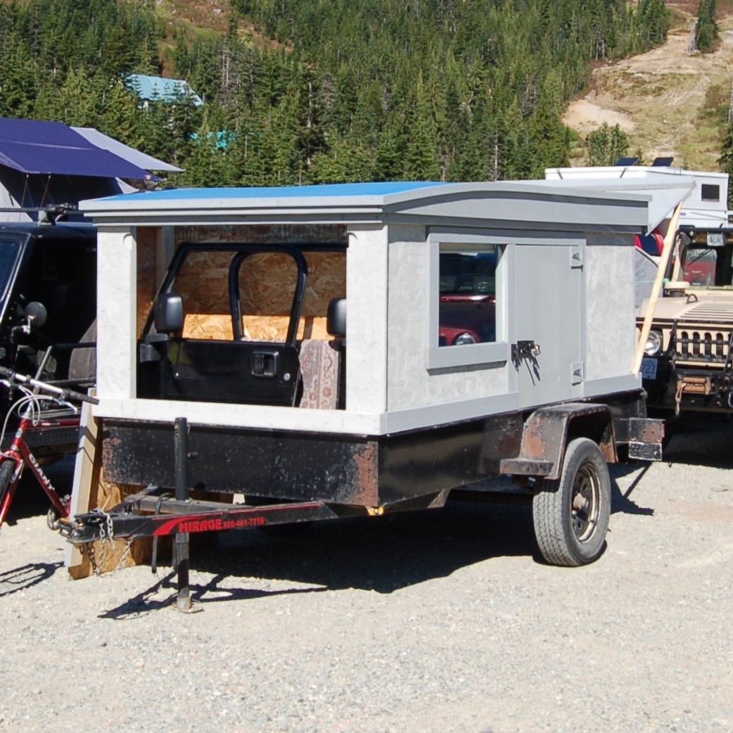

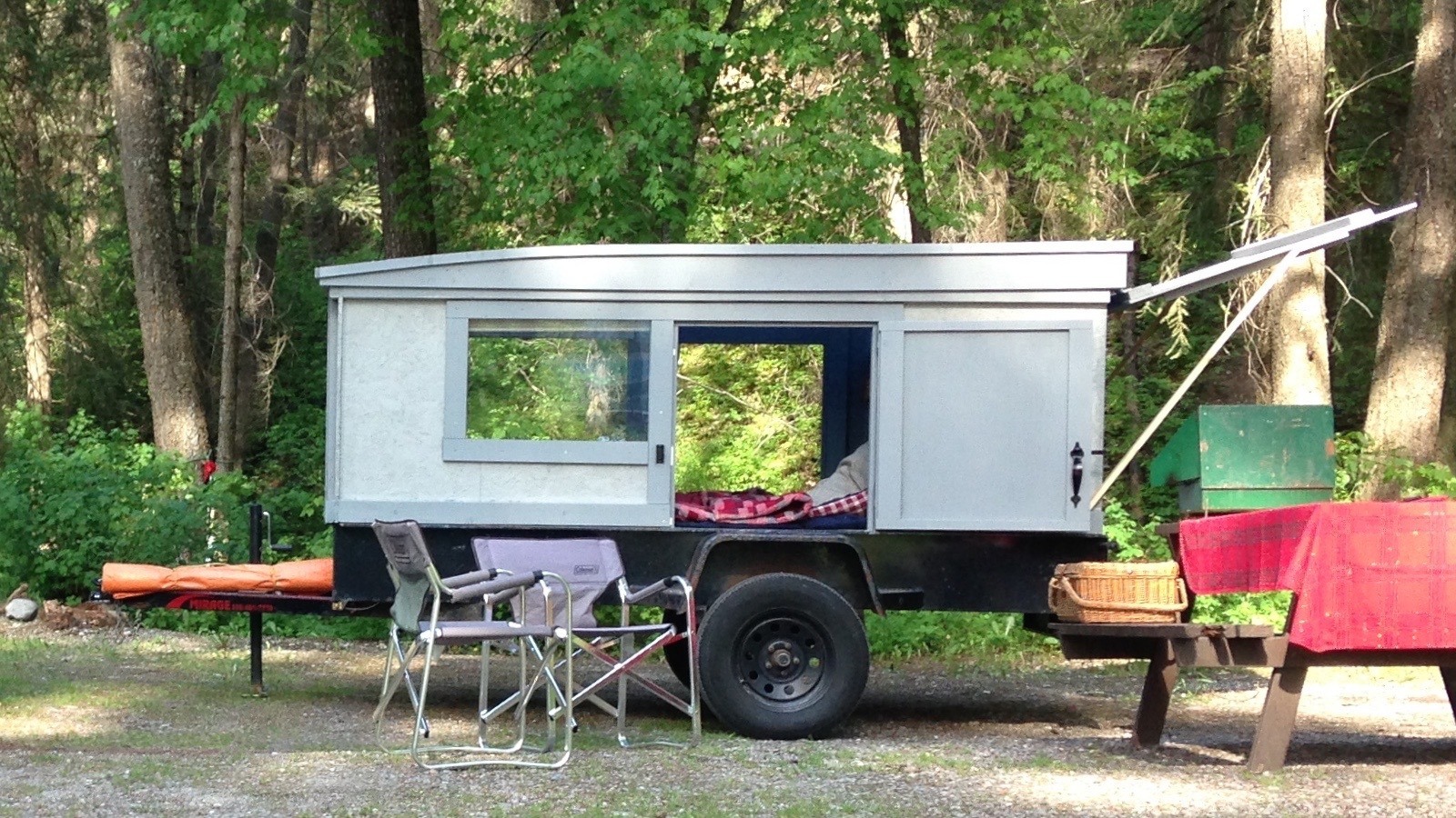

Do you have a write up on your trailer. It looks to be homemade.
No, no write up.
Started with 4 sheets of OSB and 6, 2x4x12'. Which gives the 4' high sides. I built that years ago to haul product from my suppliers. Another dozen 2x4s, 1x4s, 1x8, 2 sheets of OSB for the bulkheads & some 1/4" glass from an old house, plus $100 of hardware store pieces built it. I did a take off to cost it buying all new material and figure about $500.00 would build it.
