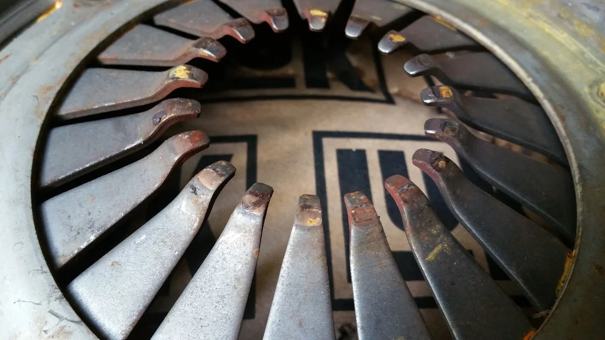

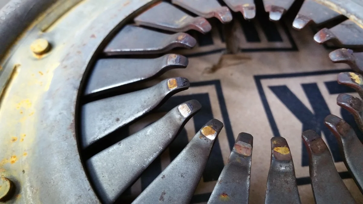

This is a picture of my old pressure plate
Some wear marks on the teeth are shinier than the other. Does that indicate that throw out bearing was making more contact with one side than the other? if so, why, and was it during clutch engagement or not?
