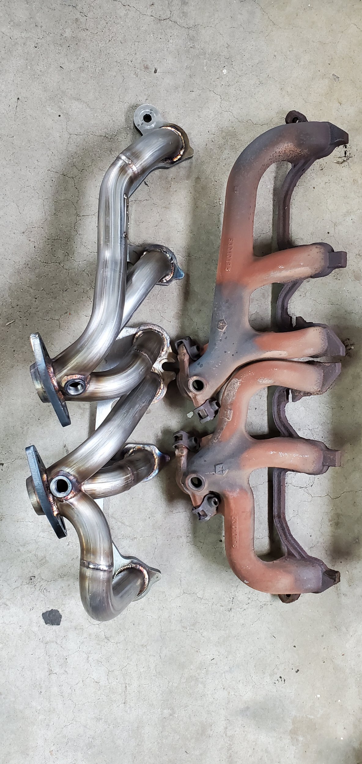

If you do have a 2 part cast manifold, I replaced mine with the AFE shorty headers and they've been good so far.
The later TJs have the cast iron 2-piece manifolds which aren't especially prone to crack or fail. They just have small ports which have a negative impact on mid-rpm power. I don't really understand why more high-rpm gains aren't seen with headers, but don't care as I want more pickup in the mid-rpms anyways.

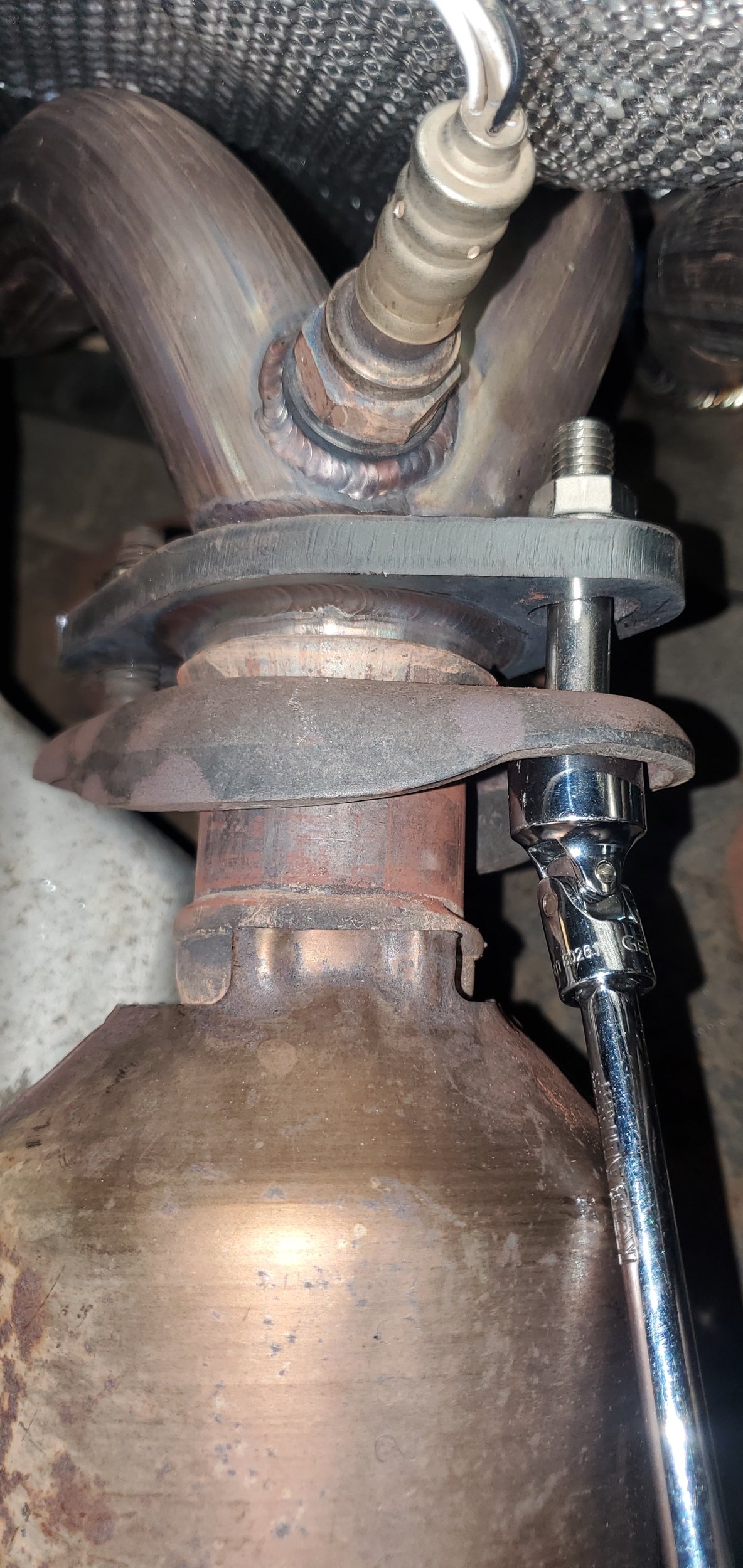

There are 2 bolts on each precat it you have them.These bolts attach via speednuts clipped onto the manifold flange. The speednuts are prone to strip and cause and exhaust leak.

Sure. Price has been fluctuating like crazy and were several hundred cheaper when I bought last year. They have sales often. But the reason I picked these was the they use one guage thicker steel than Doug Thorley or Banks and my hope is that the collectors don't crack over the long long term. Though that's less an issue with the split bank later TJs.

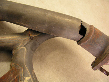

Ticking sound for a long time, then it got progressively louder until it became a very loud clacking sound that was an obvious exhaust leak. That's probably when the chunk blew out.

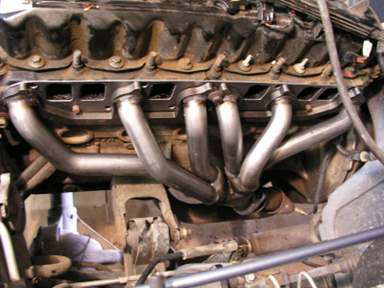

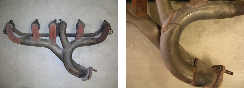

You're just going to have to get under the hood and look at the setup. You can see the front edge of the manifold and easily tell the difference between a cast log and the older style 6-1 header that Jeep used.
If you have the cast log manifolds, get underneath and look up (driver's side behind front tire). Some non-CA TJs in this '00-'02 era have 2 pipes with no precats going up to the manifolds. Others have the precats. Either way, they use 2 bolts per flange to attach the downpipes to the manifold.
This is the full cat section from my '04. The precats look like this (bottom right).
