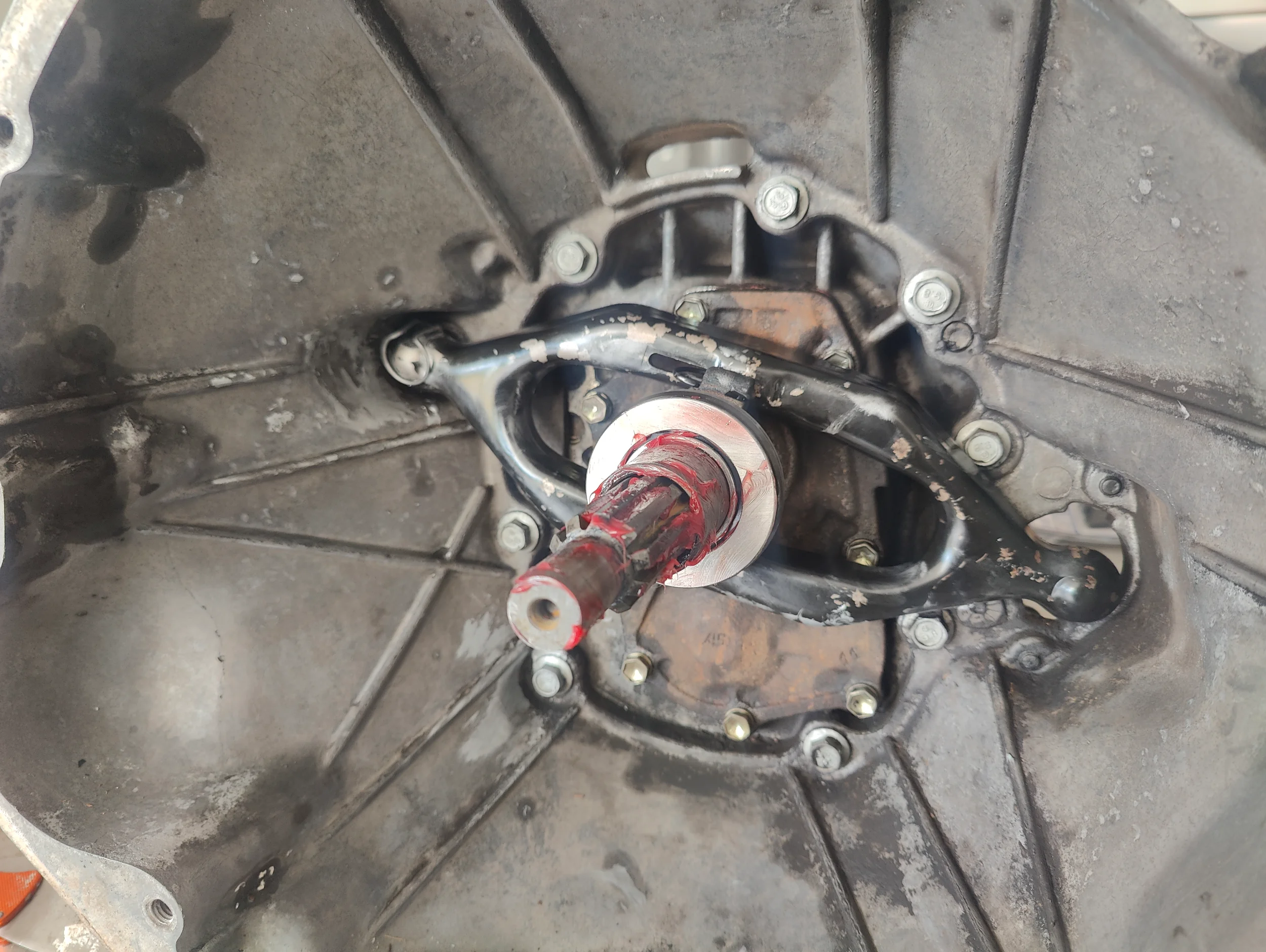

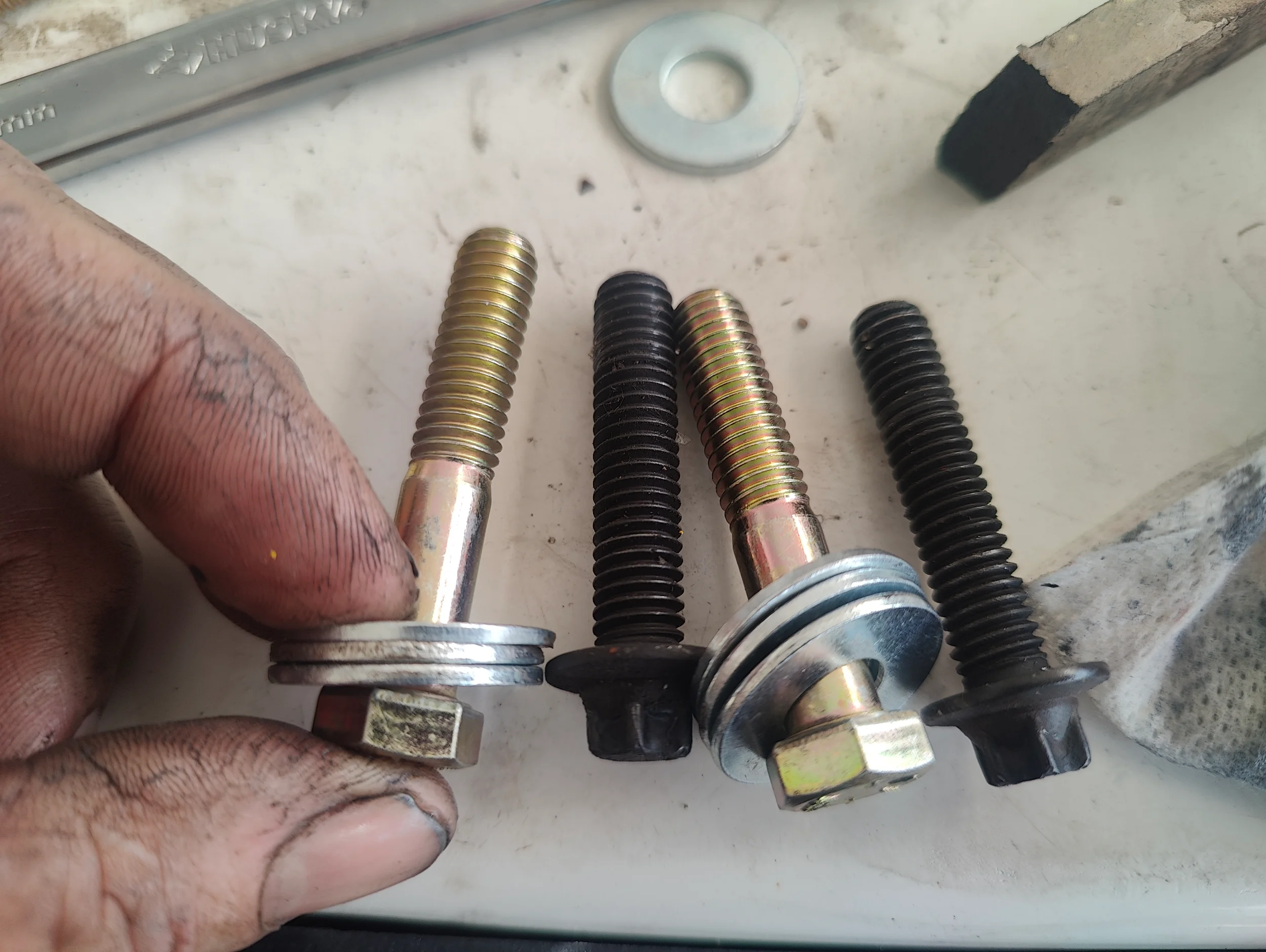

Agreed-I went through it all and paint marked all the bolts I touched. New question: what should I do with the core of the old trans?
